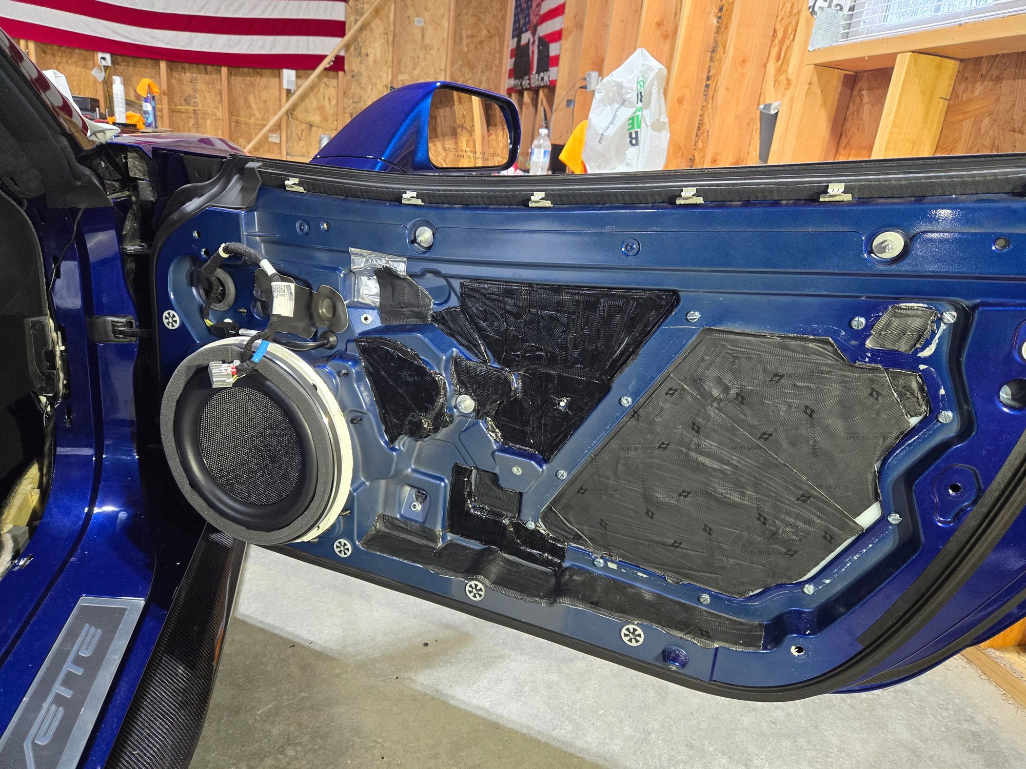

Thought I would update with what I ended up doing for the doors...
I used the factory rubber "plug" and traced out the profile and cut 1/4" HDPE with a jig saw. I ended up trimming up some areas to get a good fit. Then I placed it on the inside of the door panel and drilled holes appropriate for the self tapping 1/4-20 screws. On the drivers side I used silicon in between the door panel and the new HDPE plug when I screwed it together. After doing that, then using the sound deadening I realized that was likely overkill so I didn't do that on the passenger side. After crossing all of my fingers and testing the window, it worked just fine. The inner door panel also installed just fine.
It ain't pretty but it works, I wish I had a table router.... but then again nobody can see it so whatever
To get it in there I had to slide it up in this direction which was counter-intuitive at the time.

great to see this work out. Exactly what I was planning on doing (except for the silicone) next time I have the door panel off. Where did you source the HDPE from?

Originally Posted by VinceC5
Finally got the energy to get this started. Learned a lot when I did my C6 coupe and have applied that here.
System design: (to be uploaded later)
Door upgrade with sound deadner and 10" Kenwood for sub/midbass. The midrange will be an Infinity perfect 300m.
10 inch fit without a baffle. Deadner in inner and outer skin. I love midbass!!
Driver door
sub box coming soon @madsonp
