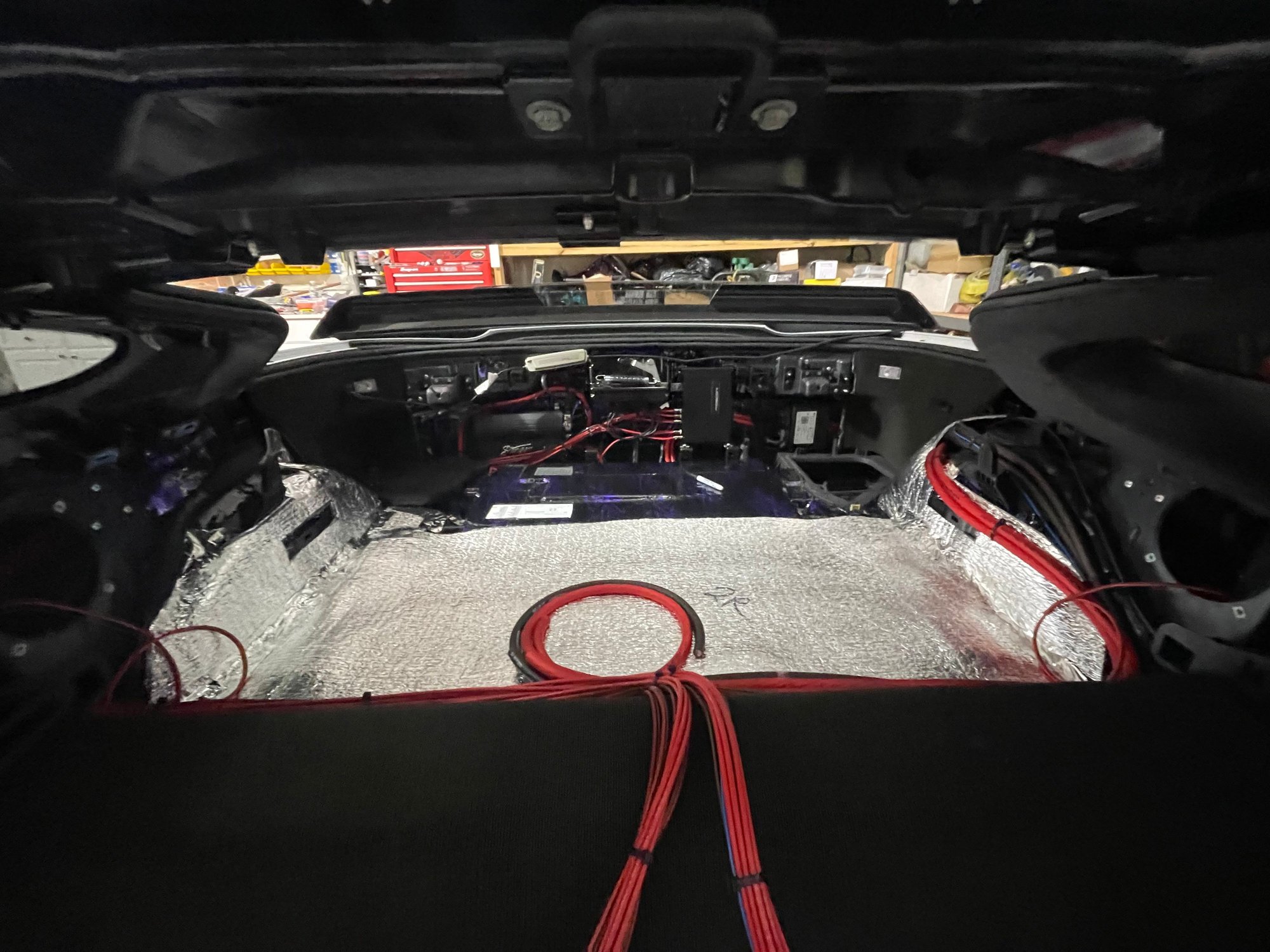

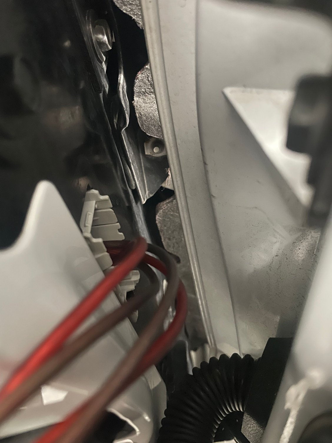

Thought I’d share my winter build. This is phase 1 of 2 as time got away and spring is just around the corner. Time to go driving.
Phase 2 will be redoing of the back end with a custom fiberglass enclosure and tidy amp rack. For now the stealthbox will have to do. The system is completely active.
Components Used….

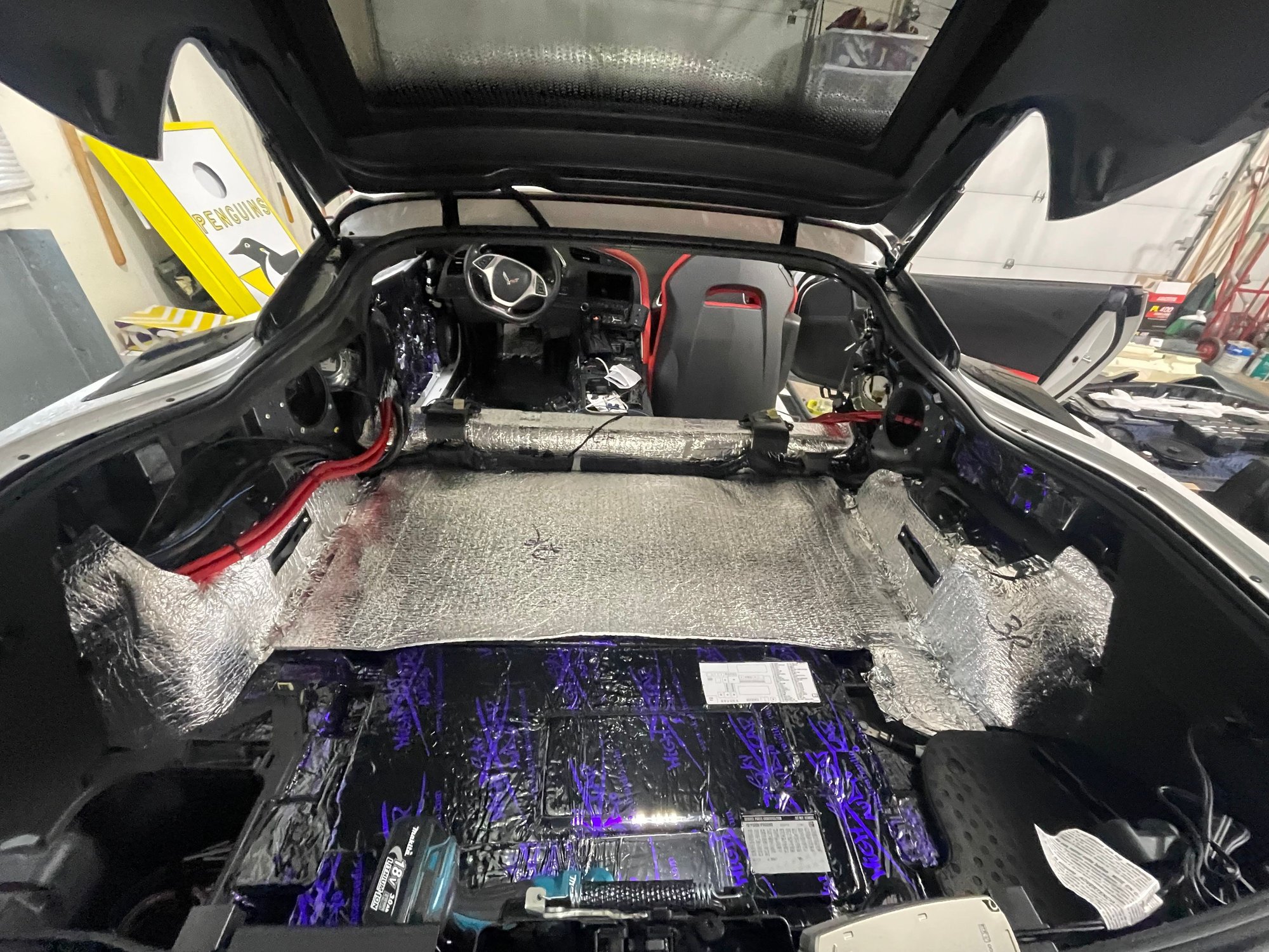

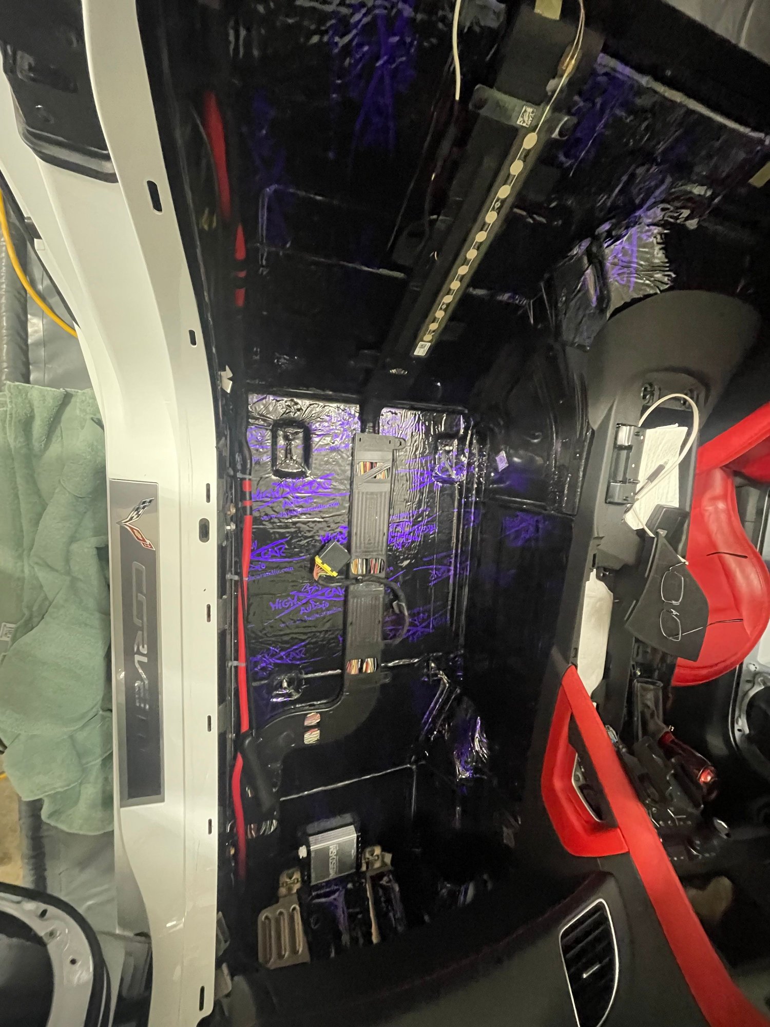

Complete Sky High sound deadening w/heat reducer on top
All new wiring w/custom cut to length RCA’s
New, powder coated to match, Ohio Generator 350A alternator
Stinger 10 Farad digital capacitor
Nav-Tv m-650-gm…fiber optic to Mosconi Aero 8/12 DSP
Mosconi Aero 8/12 DSP w/added Bluetooth module
Factory head unit…Mosconi RCD controller behind factory unit in cubby w/AFR 500 O2 wideband monitor in custom plexiglass faceplate
Mosconi Atomo2-220 x 1 Center Channel
Mosconi Pro 4/30 Class A-A/B-170 x 4 Front TBM’s & 3.5WM’s
Mosconi Pro 5/30 Class A/B x 4 & Class D x 1-185 x 2-8WM, 95 x 2 Rear Focal 5.25, 1030 x 1 JL 2-10TW3
Front dash center speaker in 3d printed mounting ring…CDT Unity 8.0 Plus wideband

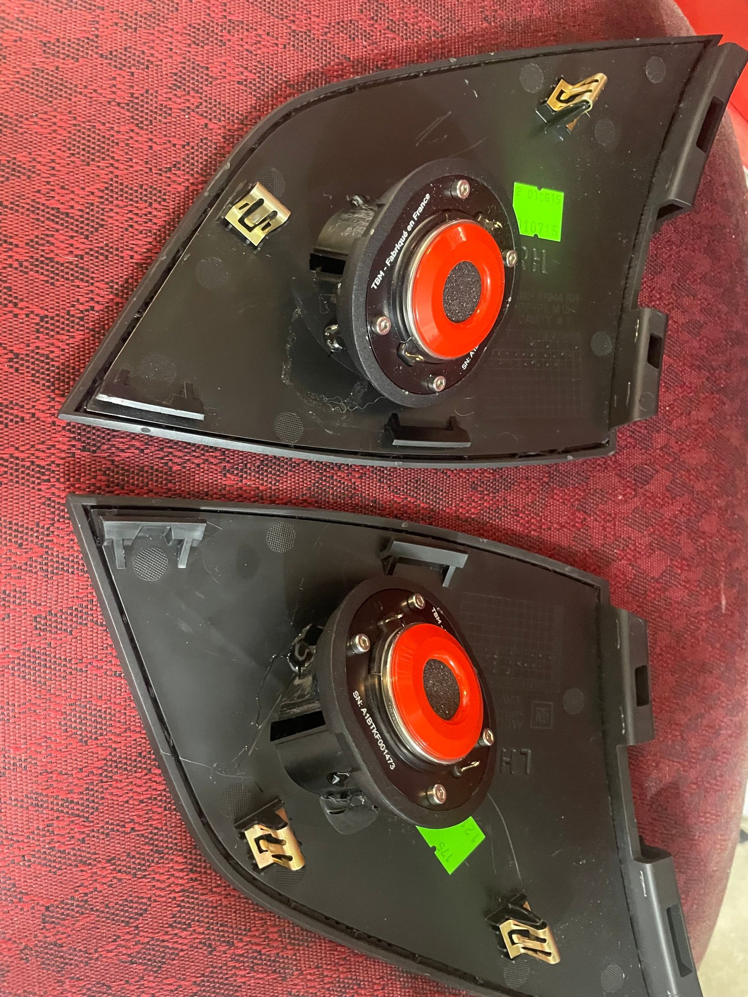

Front dash corners…Focal Utopia TBM’s

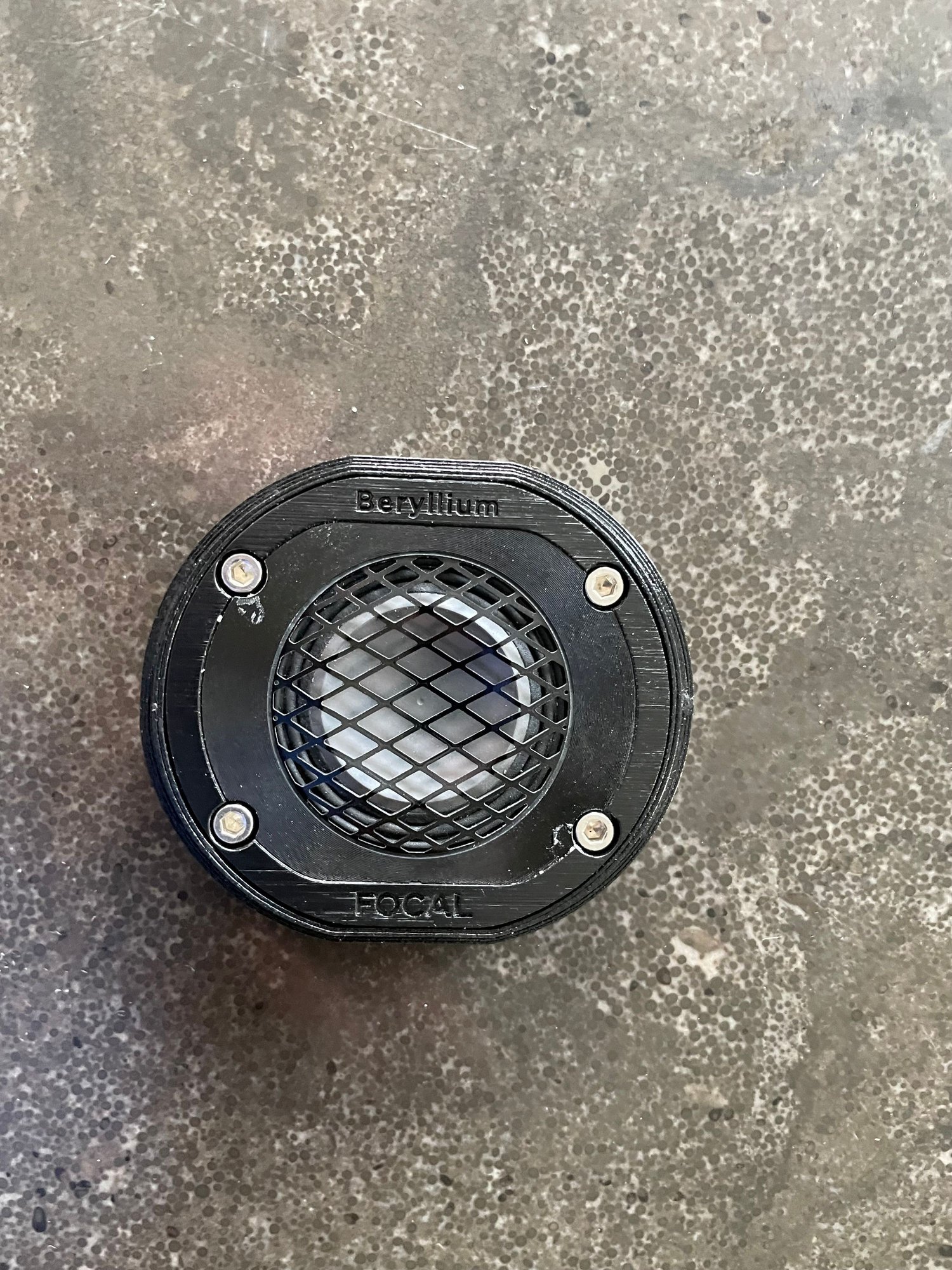

Front doors…Focal Utopia 8WM mid bass in custom HDPE mounting plates & Focal Utopia 3.5WM in custom 3d printed mounting rings
Rear…Focal 5.25 coax
JL Stealthbox enclosure custom wrapped

Many people say it's over kill to cover everything with sound deadener but it looks so damn good. Awesome, set up. Would love a video of it playing some tunes.
