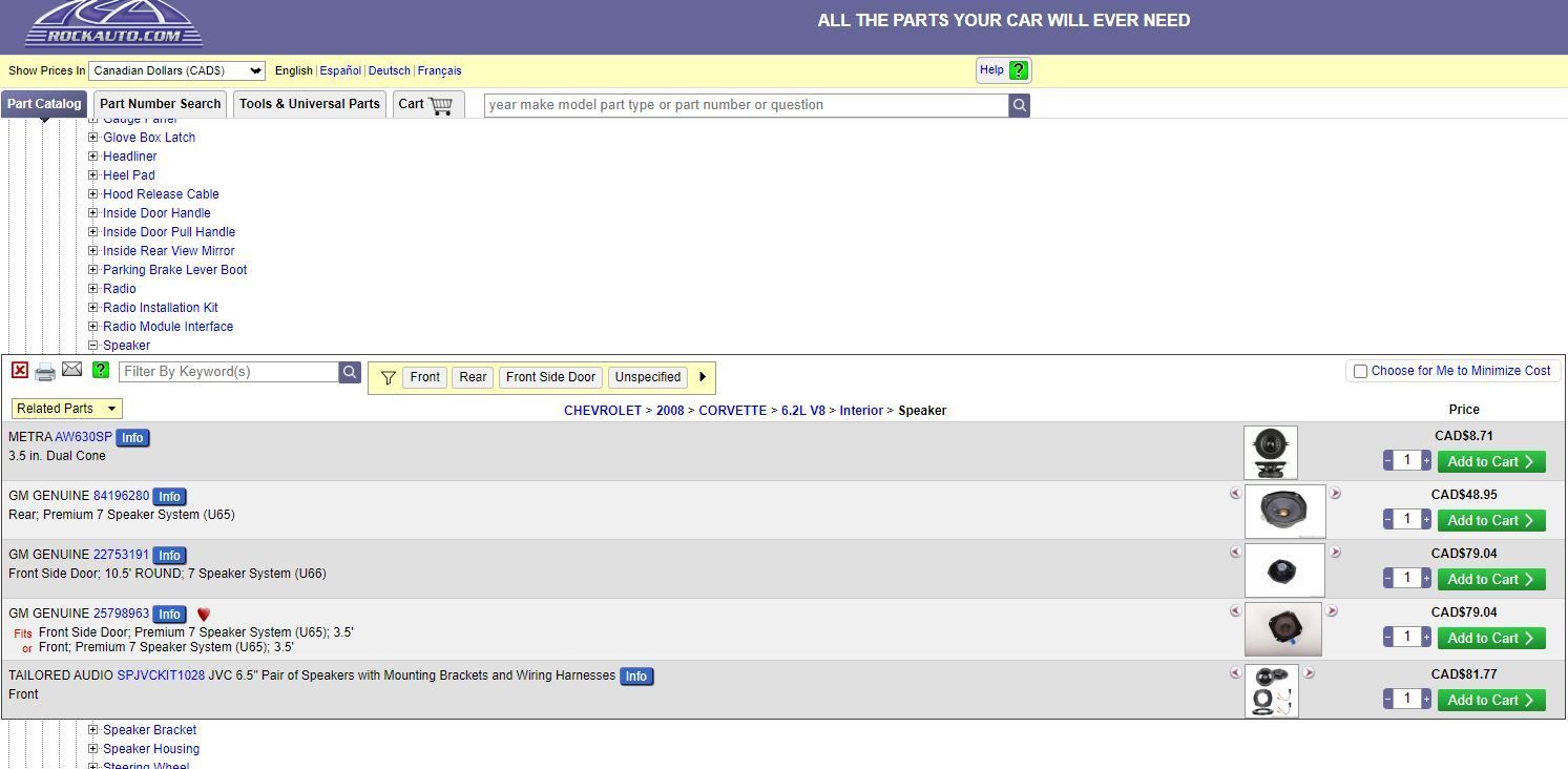

Thanks crusher1, but if you closely, RockAuto only has the regular 10 inch speakers (U66) I believe the Bose are U65 and are not the same. Unless I am wrong?

this is the correct Bose door speaker. I just installed one.
https://www.rockauto.com/en/moreinfo...t=1319&jsn=732

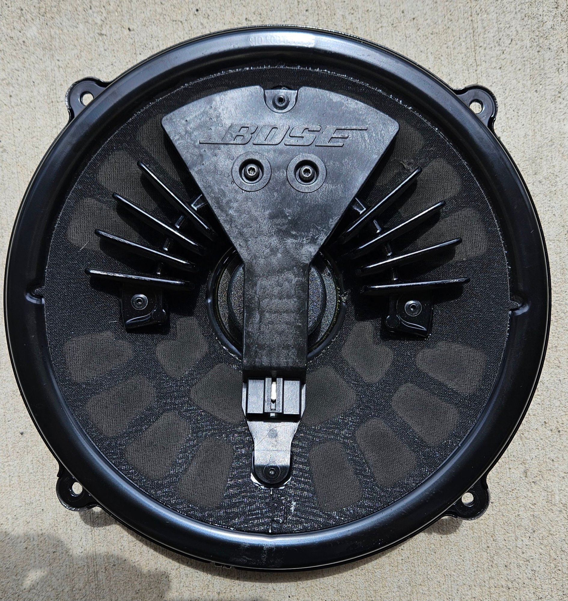

My stock Bose Speakers were these ones...
I have replaced them with 6.5inch Audison Prima speakers. After doing a TON of adjustments of my sound settings on my Kenwood DDX3 HU, the sound is MUCH cleaner, BUT am missing the deep Base from going from 10 inch to 6.5. I will be doing a small sub in the back as recommended.
