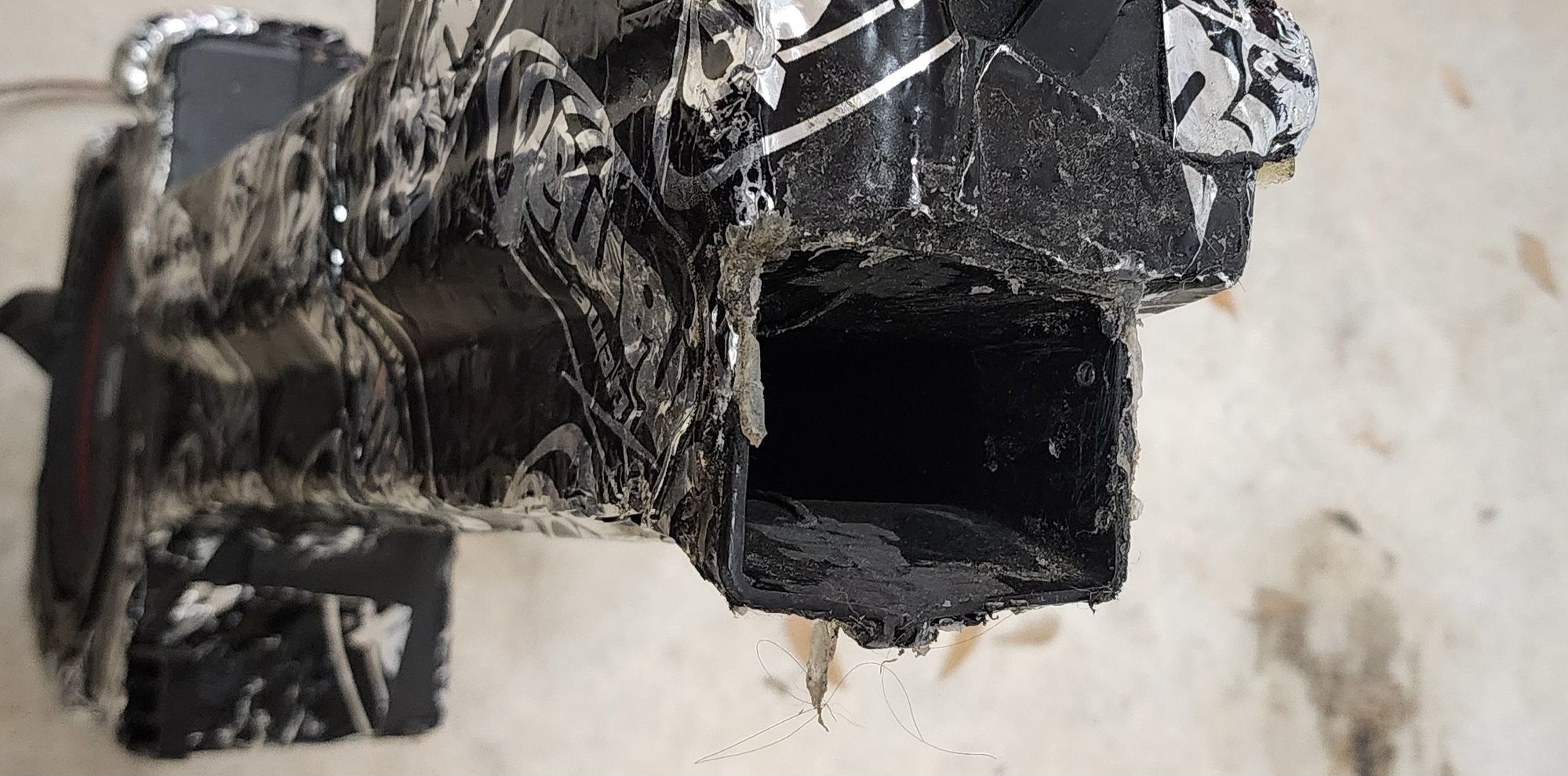

Figured I would start a new thread on this specific topic for those looking to just upgrade their sub.
I have seen many pictures of the stock enclosure, but I haven't see any details on the port itself. (my reading tells me the stock enclosure is indeed ported) Has anyone dug in to the enclosure?
The sub I am installing is a JL Audio 8w1v3-4. The user manual specifies a ported enclosure of .5 ft^3 with a 2in I.D. x 10in long port. I am going to go out on a limb and say that's not what the factory enclosure has. So once I get it all apart I am considering adding a port tube to the box.
Has anyone done this? Any thoughts or suggestions?

My 2014 box is indeed ported. The port measures 1.5" x 3" x 6" long.
I
thanks Vince! So that's where it is... hmmmm.... 🤔
To clarify in case anyone else is looking for this info; the stock port is 1.5" x 3" x 16" long (not 6")

I checked with JL Audio and they said tbe stock enclosure is good as-is so I wrapped it up with sound deadener and good to go.
I did end up making a 1/2" spacer ring for the new sub. Fingers crossed it fits behind tbe plastic trim ok....

If the adapter doesn't work out, you cans grind dowm the plastic ribs in the inside of the box so the magnet fits better.
