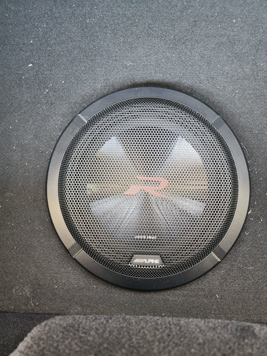

The 770 is awesome I swapped it out from a 670. The 770 has a 2 camera input so I was able to install my front camera under the bumper for parking curbs. I didnt want to buy the alpine multi camera switch. Also have the Alpine R2-W12D2 in the back
