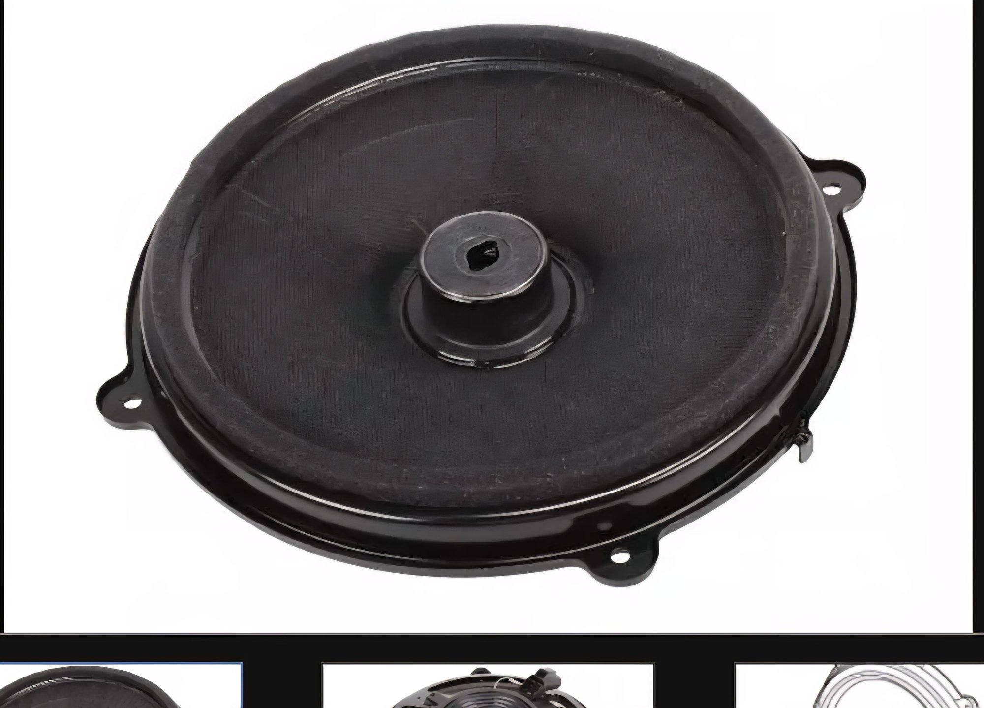

I have a 2008 c6 with the Bose system. Looking at replacing the door speakers with these https://www.crutchfield.com/p_130TSA20LD/Pioneer-TS-A2000LD2.html with 8 inch adapter.
I believe they should fit and they can run at 1 ohm which to my understanding matches the current speakers.
2 questions:
1. The Bose speakers have a factory harness with 5 wires. How would I tap into this harness to wire these up.
2. Any general thoughts about doing this? Good or bad idea?

You most likely have this speaker:
which has the bose amp built in, so a straight replacement is not possible.
if you had this one (two wire) then you can replace it.
