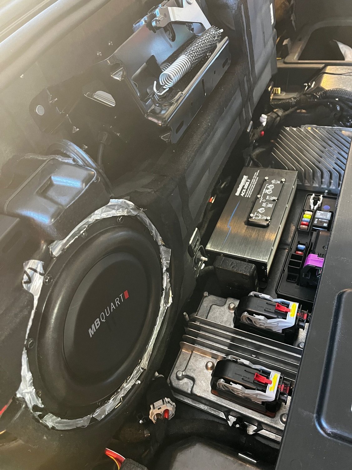

I swapped the factory Bose sub for a Pioneer 2X2 driver and insulated the factory box with neoprene sound deadener. I used an ANC bypass harness on the Bose amp to reduce the strain on the amp from the counter noise signal it plays through the Bose. The bass was tighter than the Bose, but the volume was the same (factory driver is 2x2 as well).
Then I found a compact AudioControl 300wt Monoblock amp on Amazon. But it can't drive less than a 2 ohm load, so I swapped the Pioneer for a 2X4 thin mount MB Quart. That gave the AC amp a 2ohm load and GREATLY increased the output. I mounted the ACR1 bass **** under the dash right under the start button.
I also used Pioneer 3.5s in the doors and dash, along with Infinity Kappa 6.5 two ways in the rear, all running off the factory amp. I kept the Bose door woofers and dash tweeters for now.
I'm not going to win a sound off, but I have louder, tighter punchy sound with more headroom than stock, and it's all stealth.
