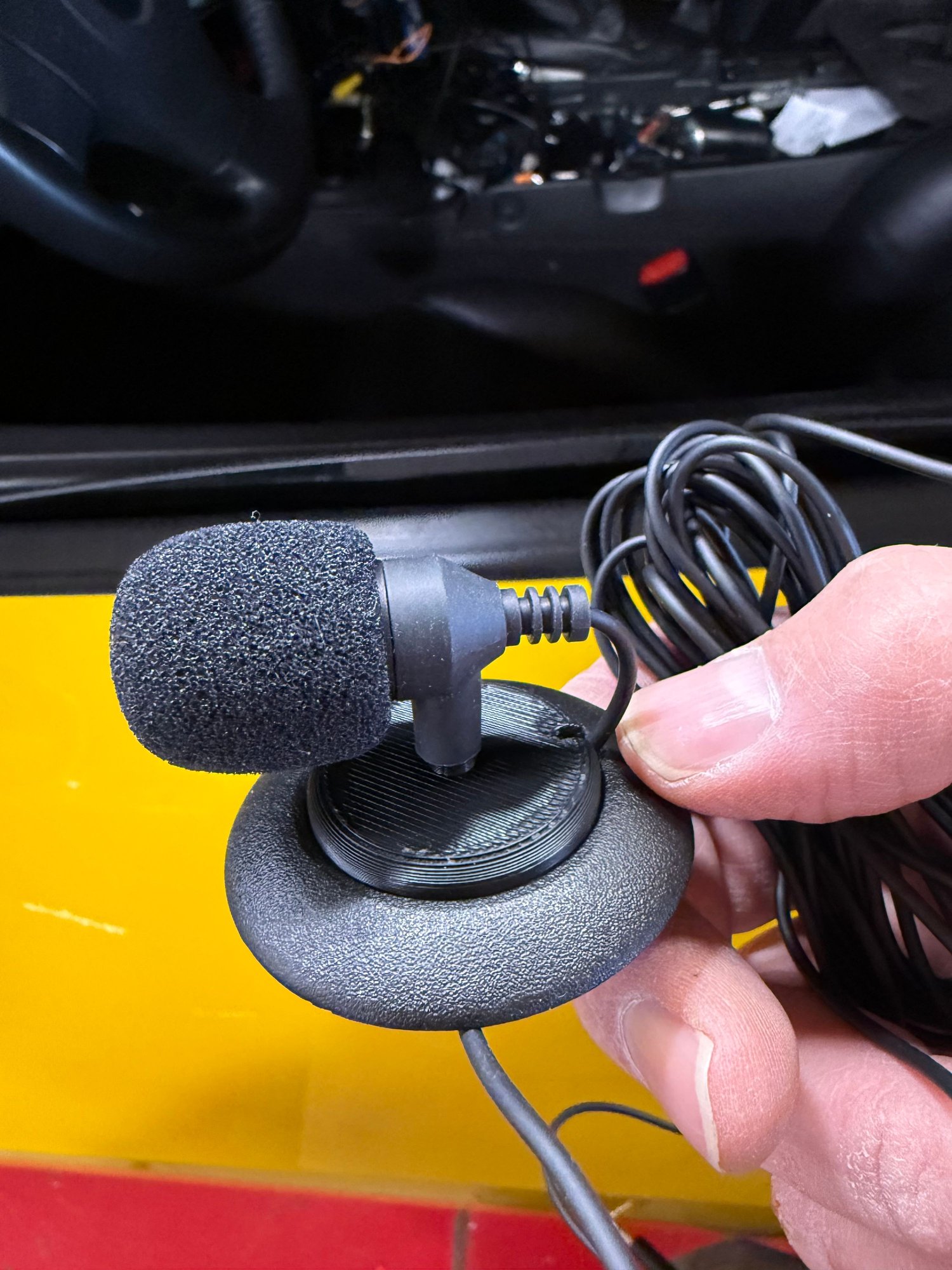

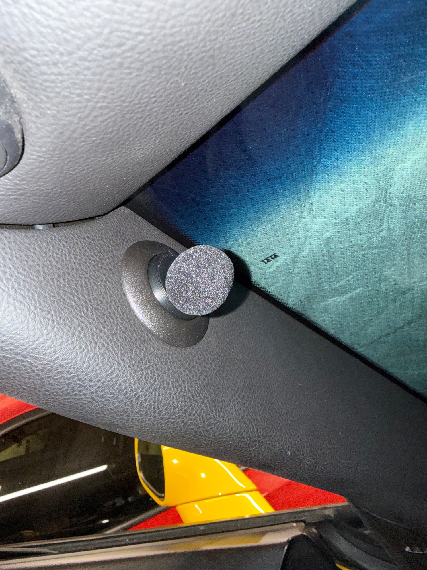

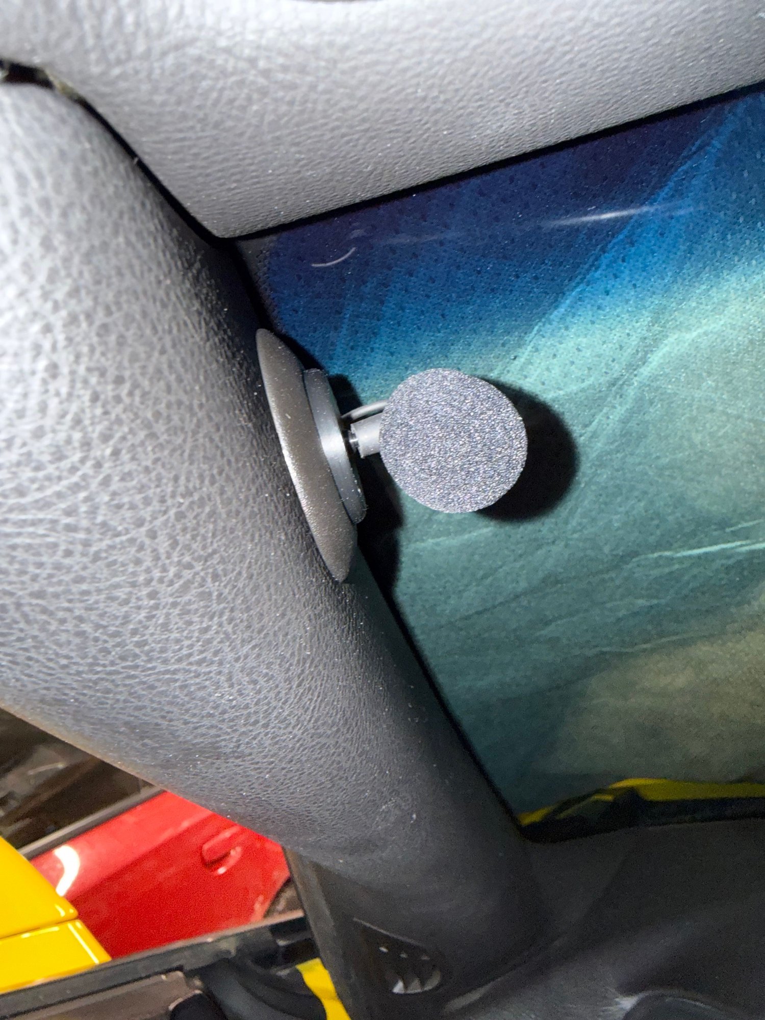

Hereis how I mounted my iLx-507 Mic
My car has OnStar, and the biggest issue I had was programming the phone buttons on the left side of the steering wheel, no matter how I tried to program them, they'd always default to OnStar, the way I got around this was to pull the OnStar fuse in the floor board fuse panel, after doing so I was able to program them as I wanted. And if I recall correctly, before pulling the fuse, my phone was trying to connect to both OnStar and my Pioneer system causing interference, again pulling the fuse eliminated this as well as deleting OnStar from my Bluetooth connections. No big deal since OnStar isn't supported on these cars anymore anyway.
I and others tried to use the stock mic with an aftermarket system, I couldn't get it to work with my Pioneer, so I mounted the Pioneer mic, up on the drivers side "A" pillar by the stock mic similar to what's shown above.
