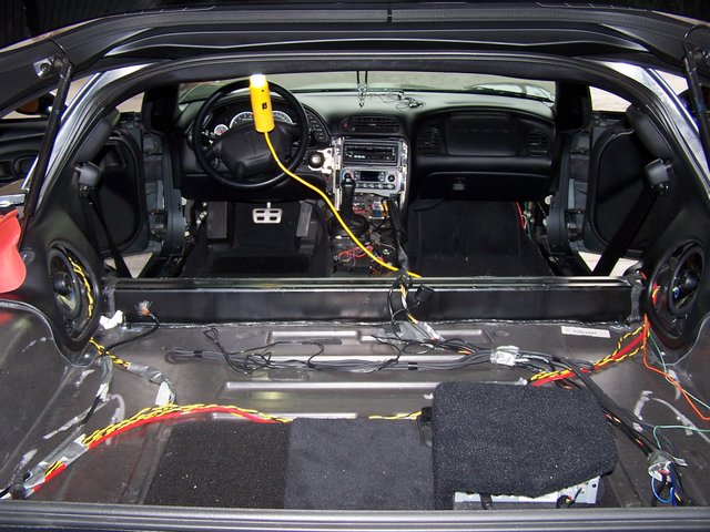

Found a pic for you. Look on the left side near the left/rear speaker. The thick black wire ...
Hope this helps. Keep us posted.
