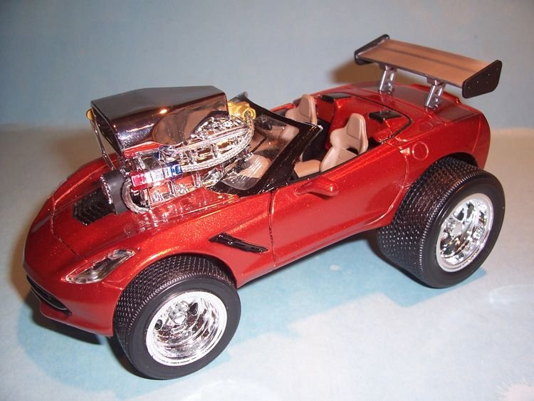

Here's the 1/24 Maisto 'dash buddy' I made for my DSOM '16.
Come on Maisto, where are the 1/18 C7 convertibles???
