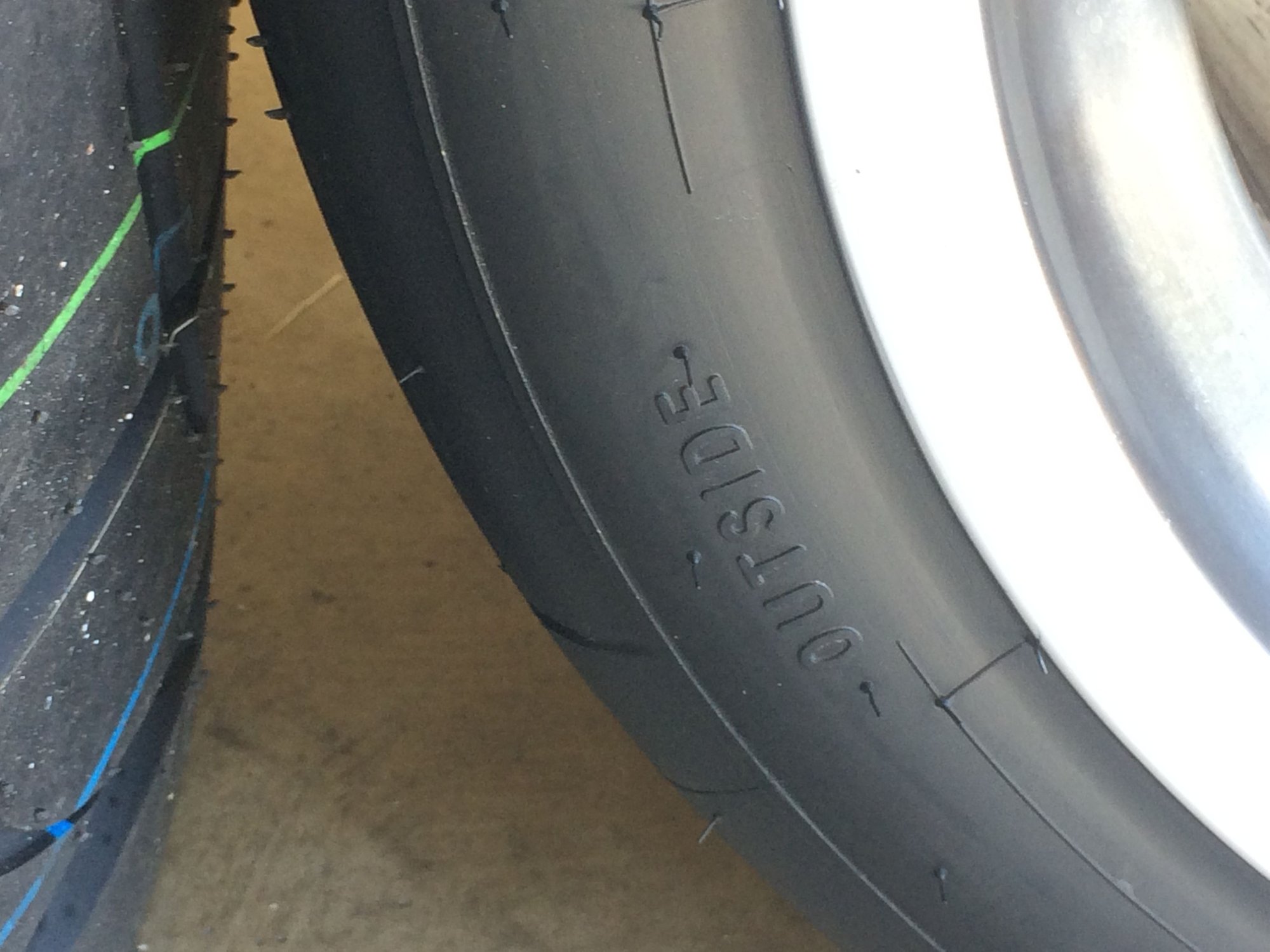

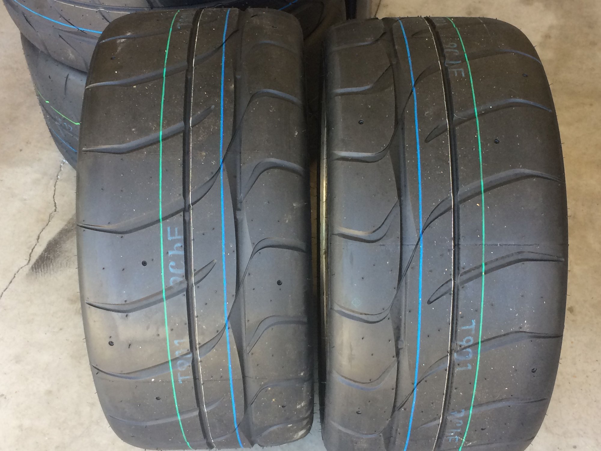

So I just got my first set of NT01 tires mounted. They are all mounted with "outside" on the outside. But doing this results in tread pattern being opposite on left from right side......see pictures.
Is this correct?
Does it make any difference in drivability?
Should I rotate wheels each event?
Thanks,
DH

It's fine. Rotate after each track weekend. Flip after 8 track days.

tread direction won't matter at all. NT01's have a wonder hour once the tread gets real low.

I get the rotating but don't understand how flipping will make a difference ??

Not necessary to flip but it will maximize tire life. If you just rotate the tires the outside edge nevers gets a break.

True but the tire seems designed with the larger tread blocks on the outside.

The tread won't exist after a few weekends. I've been running the tires for years but do what you want.

If your inner or outer edges are wearing out due to camber, these tires may be switched on rims so that the outer directional graphics are on the inside. The tread becomes irrelevant with wear and the inner and outer sidewalls are the same construction.

I flip mine on the wheel every 4-6 track days. I can usually get minimum 8 track days on the fronts, and 10-12 on the rears before I have to replace them
