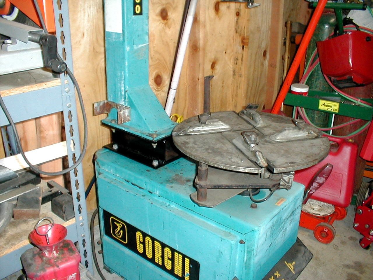

Does anyone have advice on purchasing a used tire machine? I'm curious on what the best budget machine would need to be outfitted with, or what to look for in a used machine.
TIA

I bought a used Corghi years ago for $700 when I was racing.. Like many of the older machines, it's strains to do wide slicks and R comps, however I can do the C5Z rears I run square without too much trouble by myself. . I added an H channel to increase capacity which works well, but I don't use it on anything wider than 10.5 rims these days. Also, the current "run flat" tires and matching rims are nearly impossible to do on a machine like this and requires a modern machine with a second bead mandrel. Many tire shops upgrade often and are a good source for used machines. I'd be surprised if anything worthwhile could be had for less than $1000 these days used.

Hunter TC325's can be had all day long used for 1000. These machines are used by the hoosier guys running on air compressors trackside at most of the SCCA majors events. That is why I bought one. The hoosier guys doing this stuff all day long are skilled and need just a couple tire irons. I use a bead holder, 2 tire irons and soften my tires int he sun before mounting. I have no trouble mounting at all this way. The air driven machines also have few moving parts. They last forever and need zero maintenance.

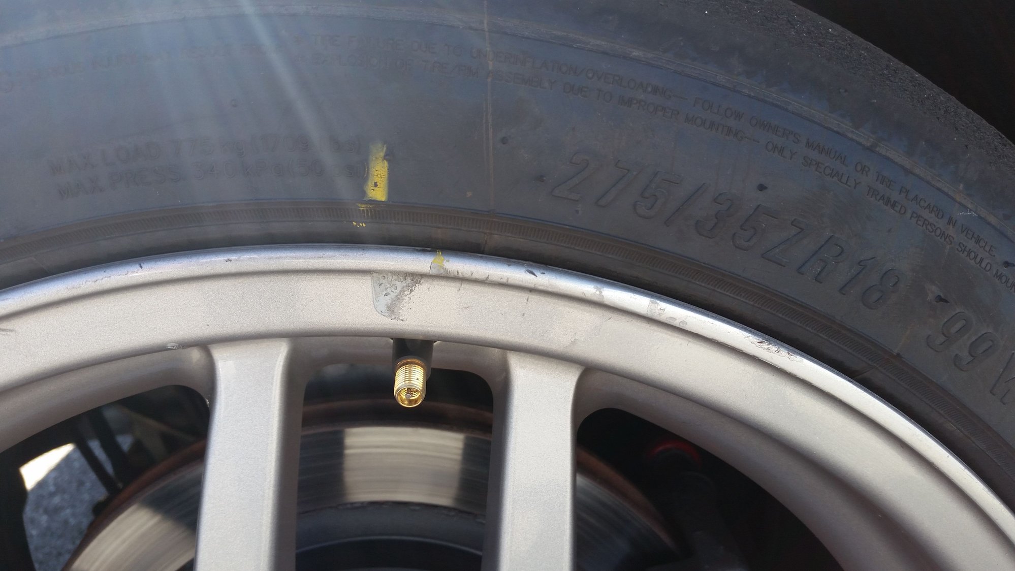

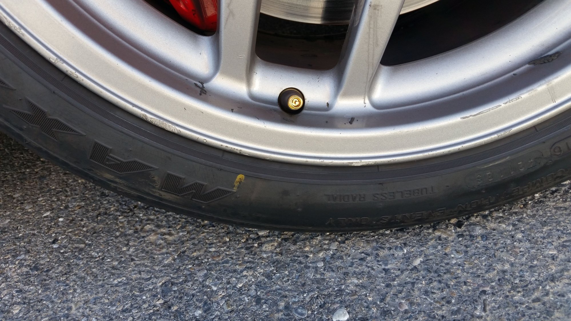

One thing Carl didn't mention in his informative post is tire slip on the rim. . I've measured this a few times and the minimum is about 1", sometimes more. This is with 100-150 Treadwear R comps that were mounted without any tire lubricant. In my mind 1" of tire turn negates any benefit from a wheel balance. These pics show the movement after one session on brand new Maxxis RC1's. The crayon mark was lined up with the valve stem. Over the years I've become less sensitive to out of balance, flat spotted tires, and the accumulation of OPR that I usually only balance my street car wheels/tires. I also agree, good race rubber takes very little wieght to balance on a true (not bent), quality rim.

I agree. I think you're wasting time balancing track tires. I do it anyway but after the first session it's all over. Since I use cups I try to put 500 miles or so on them before I track them. They seem to last longer but that might be all in my head too.

On tire movement you guys are right! Totally useless when I travel race and have hoosier mount hoosier tires trackside. However, when I mount the same hoosiers with cheap hairspray I get zero tire slip on rim. ZERO!
