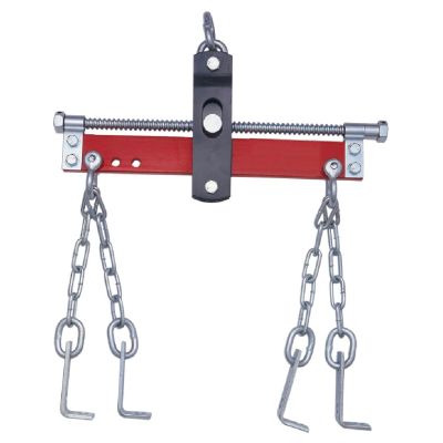

You could do it that way and will probably be OK....but to me the $25 for a tilter and the peace of mind in using larger bolts/threads on the heads is more than worth the extra cost.
Plus - the tilter will give you additional control.

Brian is correct, an engine tilter is a good tool to have. If you don't have one you should have several holes in the engine plate that you can move to to get the right angle. Make sure all threads are in GOOD condition before you lift the weight. I have installed 454 engines and trans and 460 engines and trans with the lifting plate, it works great.

I believe the best way is to use and engine tilter.
I just finished installing an engine/trans is a friends 70and the tilter was a God send.

Harbor Freight has 2 ton tilters on sale for $19. Not bad but the turning threads feel like cr*p!

I made the mistake of buying one of those cheap ones, and it was a mother to tilt, then the handle broke off.
then I invested in a good one from Matco for $65.00 and it made it a lot easier.
http://www.matcotools.com/Catalog/to...&page=1&#28802
it's probably lifted a close to 100 motors, everyone I know is glad I bought it.

i am using the tilter right now to balance my 64 vert body as i reinstall it on the frame ....never pull an engine without one john b

I have used both methods to install an engine and trans into cars and have a tip. If you're using a carb plate with an aluminum manifold, USE STUDS in the manifold to keep from stripping the threads. As a matter of fact, anytime you are threading bolts into aluminum, you are far better off using studs with lock washers and nuts as aluminum is far too soft and easy to strip threads. As far as using a tilter, I have used it and find it to be the more acceptable method when installing an engine/tranny combo.

I greased the threads on my tilter, removed the handle and used and impact or a ratchet. They eliminate tons of headache removing engine and trans together.

I agree ... if I knew the Matco was only $46 more I would have bought one myself. Although adequate, the Harbor Freight levelor is very hard to turn when it's off center!
