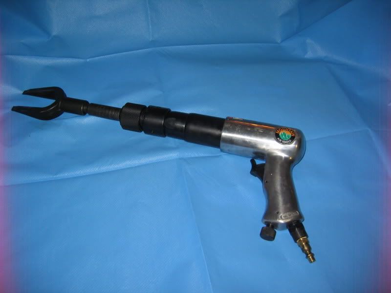

I use a heavy duty air hammer with a pickle fork. I had beat on my lowers til my arms about fell off. Got the air hammer & fork kit, 20 to 30 seconds per side.

Apparently, sometimes, a bigger hammer is exactly what is needed. Will be back at it this weekend and will let you know how it works.
