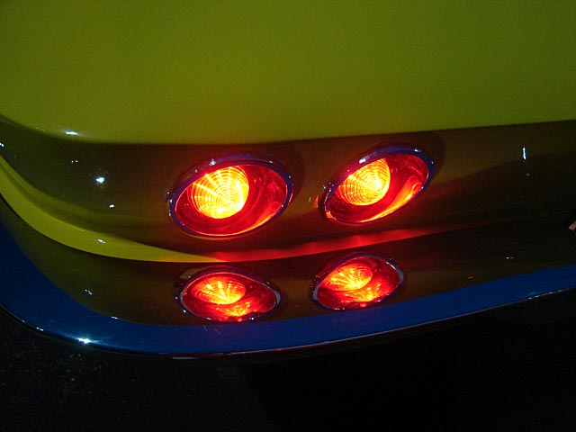

these are the led's on taillight....I am very happy with how bright they are, i put them both front and back with no regrets.
