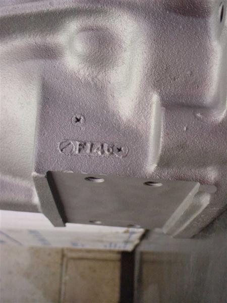

Here is another pic from the same diff.
Located on rear pass. side

Old Nov 14, 2011 | 12:29 PM
JohnZ's Avatar
JohnZ
Joined: Oct 2000
Posts: 38,897
Likes: 1,926
From: Washington Michigan
Yup - the 464910 rear cover was used in '78-'79, with the 7/16" rear spring retainer plate bolts (vs. the 1/2" bolts used from '63-'77) to accommodate the '78-up 2-1/4"-wide spring.
