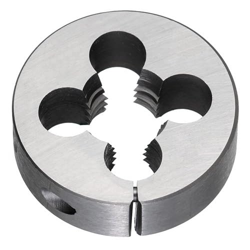

Here is what I need:

I was planning to try a die to see if the threads can be de-buggered
You don't want a "die" - they cut metal. What you want is a "thread-chaser" die, which will clean and straighten threads.

I've never checked but I believe 3/8" X 24 is correct on the threads.
You MIGHT have to lightly dress down the end of the stud if you mushroomed it with the hammer in order to get a thread chaser started.
When you use a thread chaser, just make sure when the tool bites and starts cutting, that it is cutting in the same thread groove as the stud already has on it. You don't want two sets of threads.
