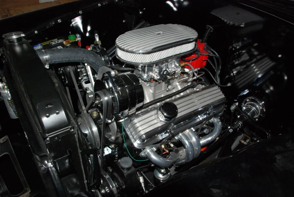

I am having my '51 Chevy redone as a retro-rod. I chose a new GM Crate Engine from Jegs....only $1,499, delivery free. Its the 260 HP version, but with what we have added, we figure it will come in around 300. I didn't need a road burner. 12 month warranty. Have not started it yet....car is still being finished. Of course you may have a greater need for HP and speed! This will do me just fine. Here are a couple of pics.
