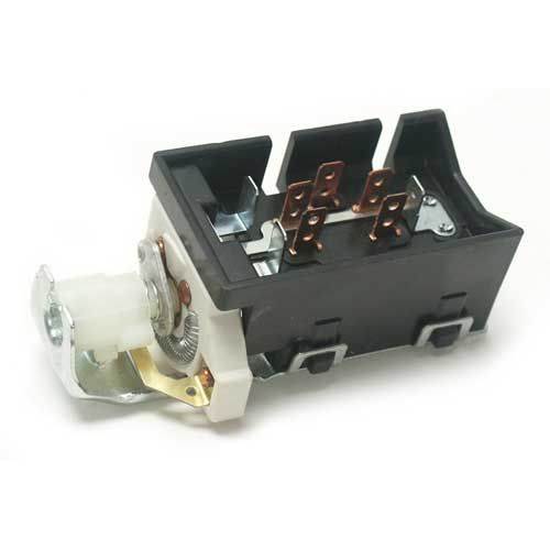

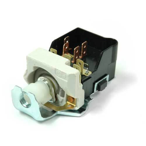

Frankie, Paragon lists a separate switch for the '63...
'58-'63 Switch
https://www.paragoncorvette.com/p-35...mp-switch.aspx
'64-'67 Switch
Good luck... GUSTO
...oops... see you already bought it.

Frankie,
If you look at the picture Gusto14 posted you will see a brass strip that the nylon cam pushes down to the metal base and grounds the circuit when you turn the **** all the way to the left.
Make sure the switch has a good ground and the metal that the strip contacts is clean. It has nothing to do with the inside contacts.
Joe
