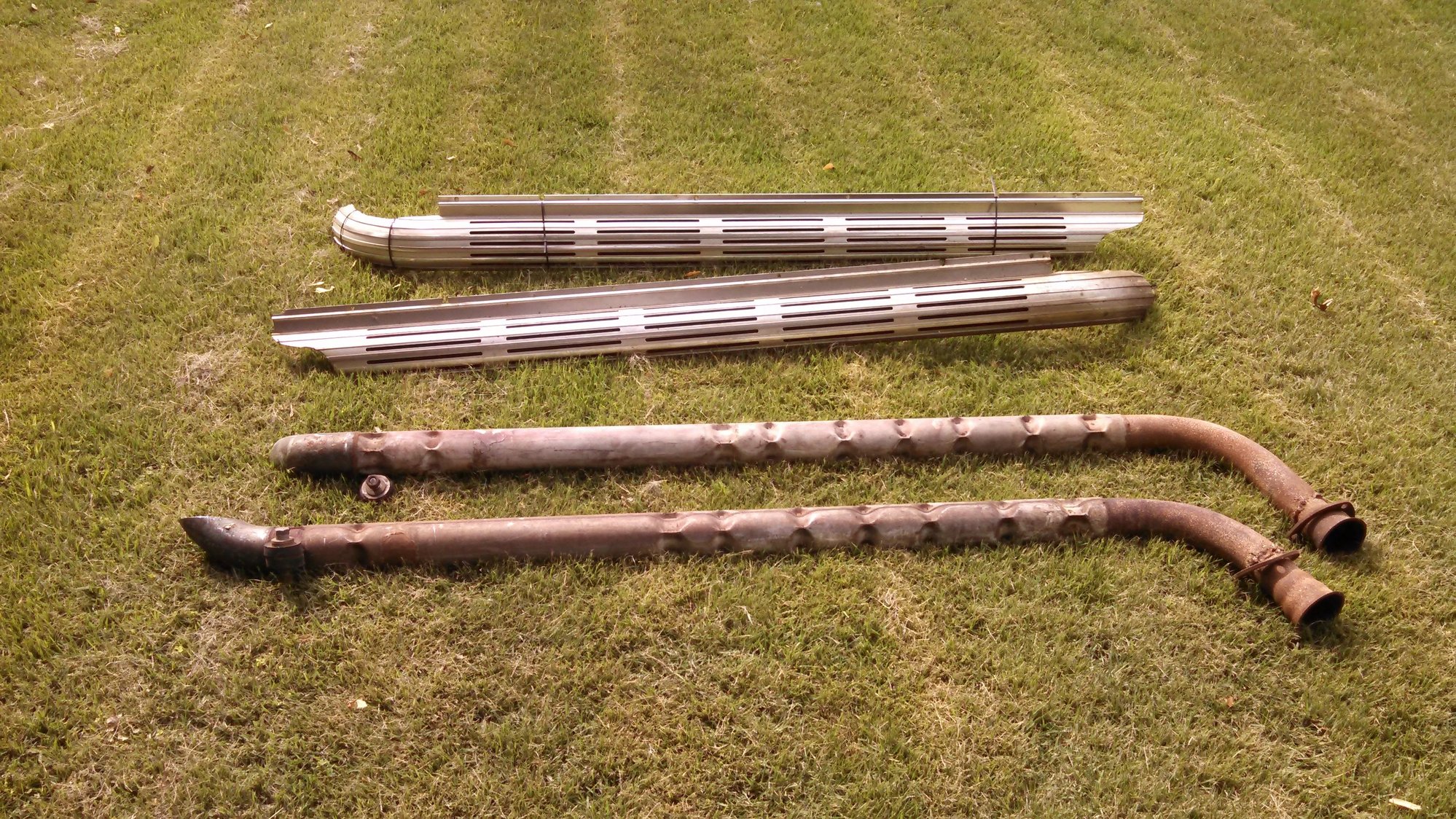

How do I tell if I have sb or bb side pipes? I purchased a 63 conv. with a 454 in it. The side pipes came with it but off the car. Is there a measurement I can take to determine which ones I have? The front of the pipes that attach to the exhaust manifolds does not line up so I know I will have to modify it but I want to make sure they are right for the bb.

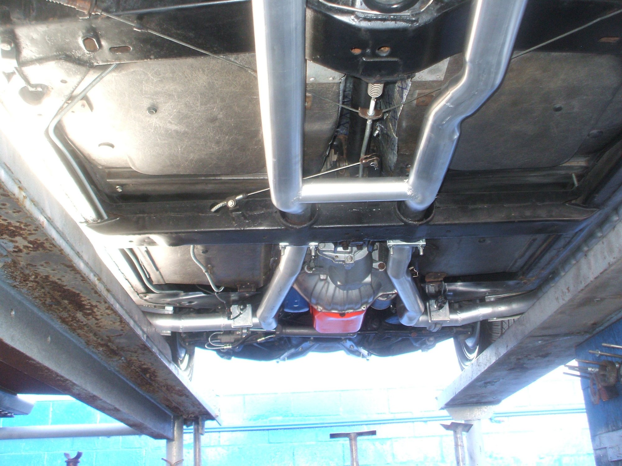

These are my 2 1/2 allen's stainless steel , on my 65 BB

Here are the pictures of my side pipes
Those appear to be OEM pipes modified for either SBC or BBC side exit headers:
http://www.summitracing.com/parts/hed-68280/overview/
http://www.summitracing.com/parts/hed-68210/overview/
Old Aug 8, 2014 | 02:39 PM
JohnZ's Avatar
JohnZ
Joined: Oct 2000
Posts: 38,897
Likes: 1,926
From: Washington Michigan
That's exactly what they are - most of the front pipe section has been removed and stubs welded on to connect them to Hedman sidepipe headers.
