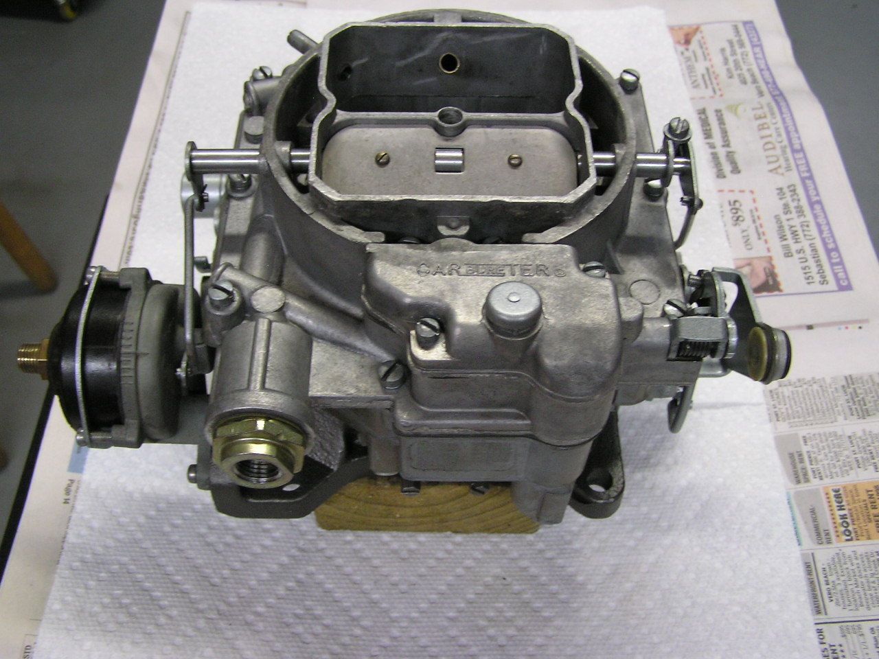

If any of the members of this Forum have been following my threads you will know that for the past few months I've been attempting to resolve issues with my Carter WCFB. The carb is a 1962 Corvette Carter WCFB Carburetor. It is marked 6-1586 on the air horn and was completely rebuilt.
My dilemma is that in attempting to remove the internal fuel filter I inadvertently stripped the threads in the air horn. I have tried to seal it using Permatex Aviation Form-A-Gasket® #3 Paste-Like Sealant, and installing a gasket on the inlet fuel nut. No luck. I can't drive my '62 to any local garage due to the fuel leak. The only good side to this is that I have all winter to get my baby back on the road. Will any WCFB air horn fit on my '62 Carter? I am open to any suggestions at this point. I need HELP!!

Mark, I got your email and checked my stock and I don't have one.
Did you strip it when removing the fuel inlet fitting, or when you were trying to thread it back on? That's a drawback with the filters there. That fitting is prone to problems.
That's a great offer of Dan to send you a air horn.
And he was spot on in your other thread....you can't have 2 filters, but I guess that's a moot point now since you were trying to eliminate the stone filter. I'd imagine that may be your issue with fuel starvation.
FYI, there was, and must be, a gasket installed behind that fitting. I just read your prior post and you said there wasn't one there, however there was. It's gray colored in this photo of your carburetor.
