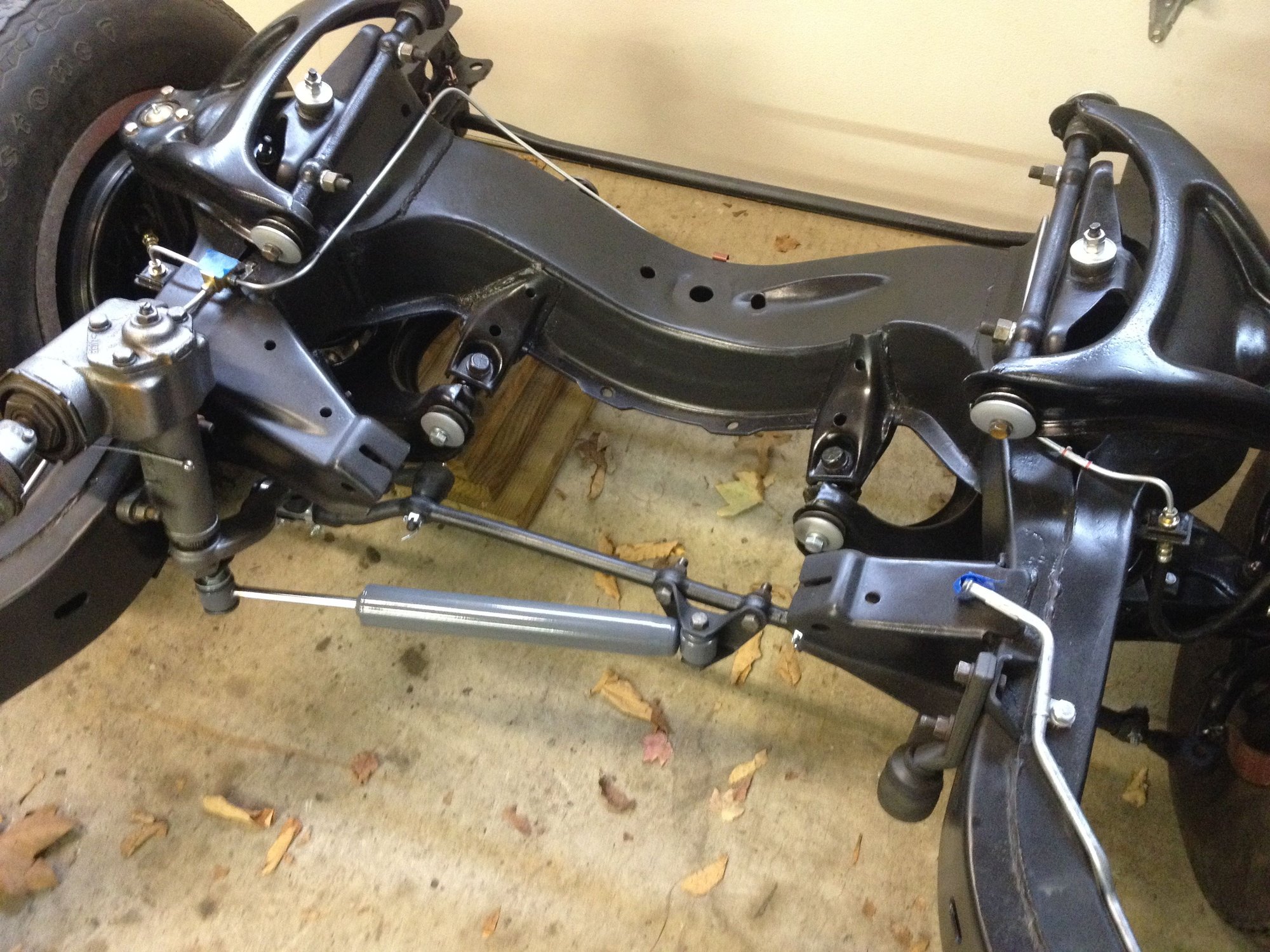

1964 Convertible, 327-300HP, body off resto.

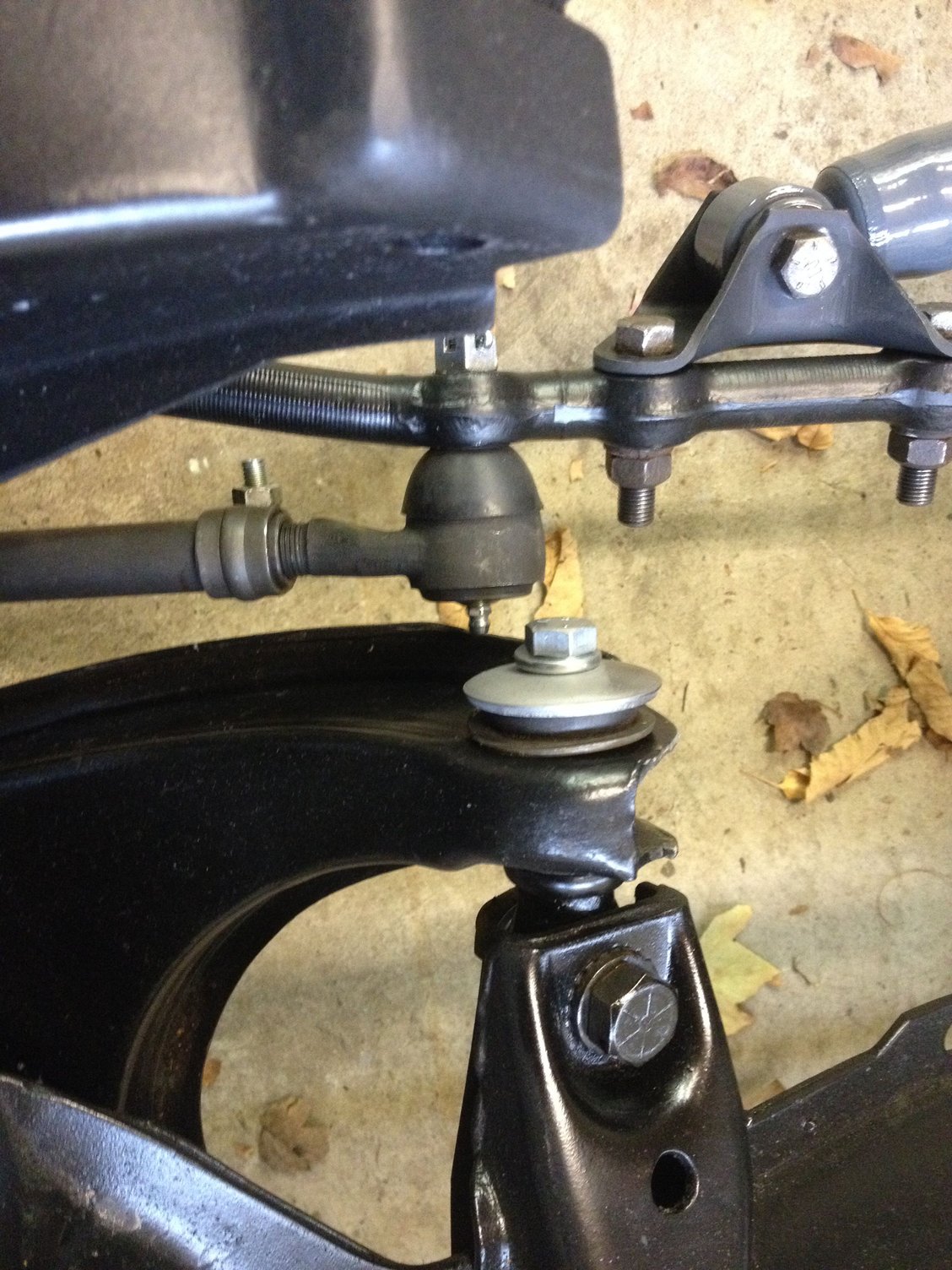

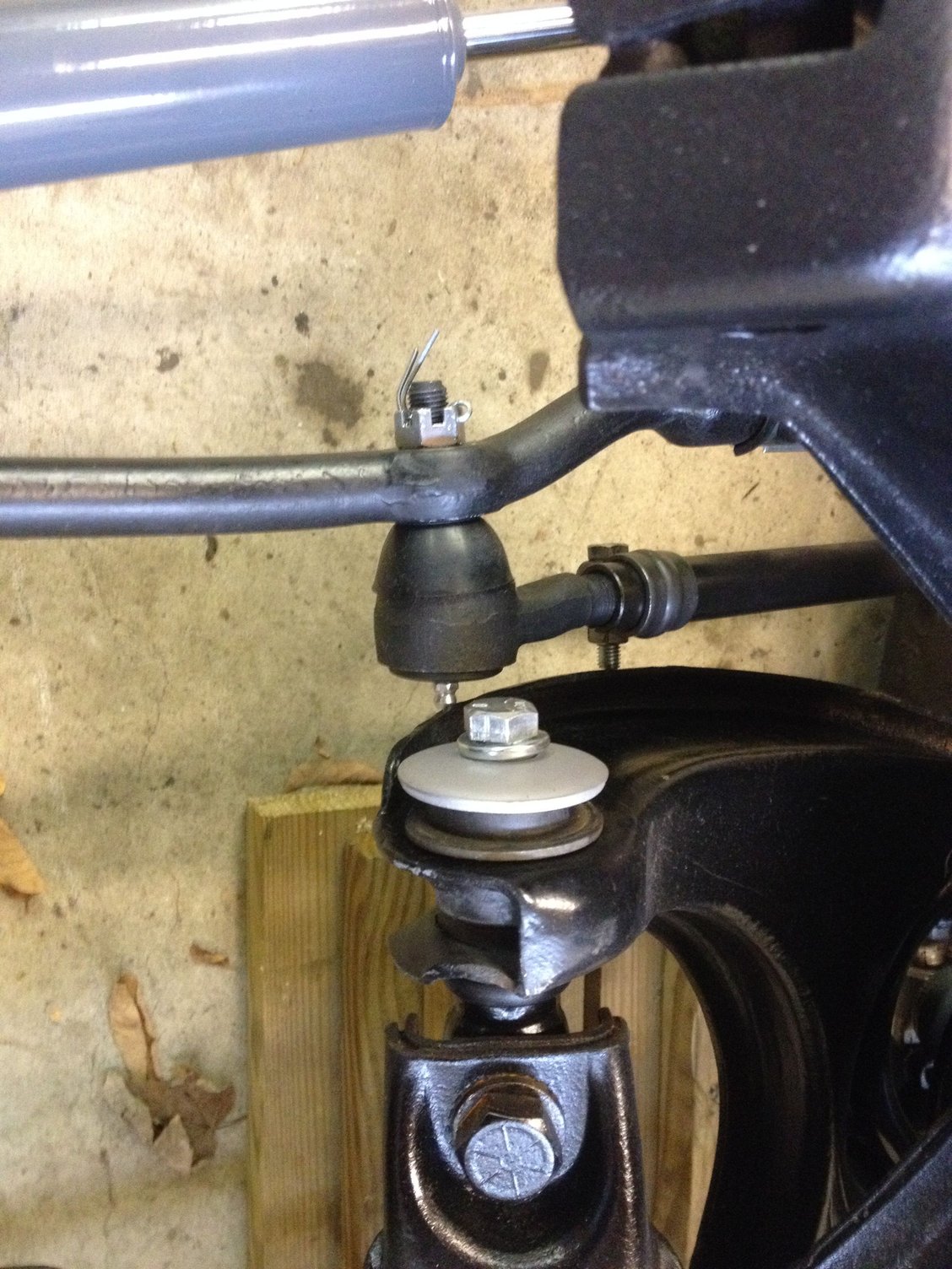

I installed the steering and noticed that the grease fittings are touching the lower control arms on either side. Is this simply because there's no weight on the frame or is something done wrong?

That's my guess. I did the same restoration on my 65, but still had the engine in, and the fittings are lower than yours. Try grabbing a couple of buddies and stand on the front cross member and see if they go down! Nice work by the way!

So what do you think it is? Is your motor in the car in this picture? These are all the original parts from the car (minus ball joints and bushings) and were tagged, restored and reinstalled.

Looks like your tie rod end is sticking out farther from the rod (area of the rubber grease boot longer?). Where did you get the tie rod ends?

Cross link just doesn't look right. Too much bend.

Hard to tell from photos but it appears the tie rod end is in the wrong hole in the steering arm. Without PS it should be in the rear hole on both sides.

Thanks to all who answered so far. This morning I removed the tie rod tubes and the ends. It appears that the left hand threaded ends ARE bigger than the right hand (by about .238 or approx. 15/64" when measured from the tip of the threads to the opening of the ball joint housing), but looking at the pictures you guys posted, my tie rod ends look much heavier (fatter) at the ball joint ends. Could there be a difference between power and non power steering? I have non power and that's what I ordered.
I spoke to Corvette America this morning and they believe the ends are correct according to the numbers in their book. I'm going to call back now and explain the difference. Maybe I need to look at another vendor for the tie rod ends?

Congrats on finding the problem. Your excellent pictures really helped.
Corvette America has got a real problem there, and I doubt that the tie rod ends were different for power steering cars.
I would keep the incorrect tie rod ends, untill you get new replacements from elsewhere (to compare them with).
