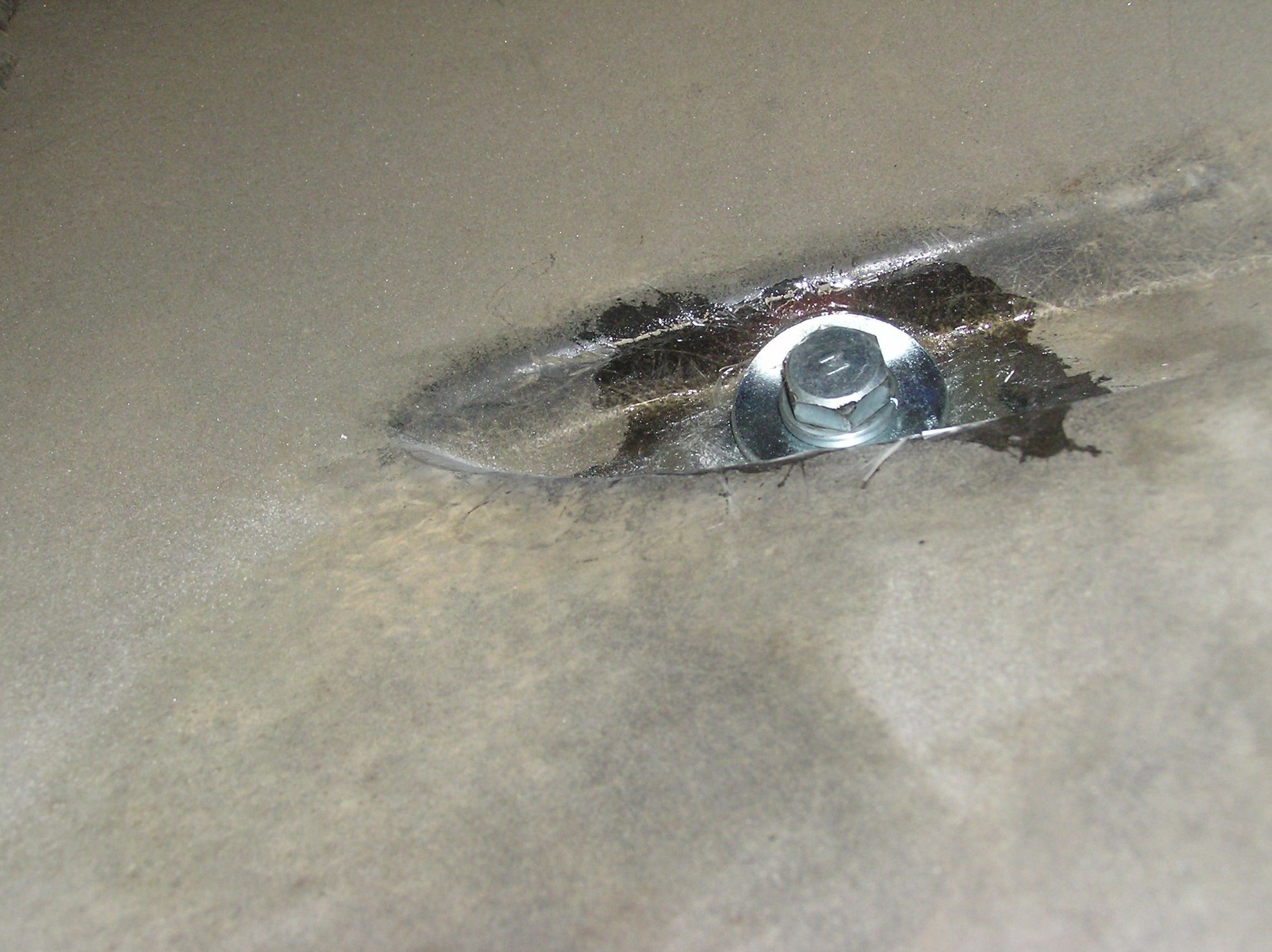

Not to scare you back out to the garage and tear your car apart.....Maybe your bumpers got tweaked a bit and cracked the area where the bolt passes through. Both front and rear bumpers bind against the fiberglass on their sides. Just the way it is...
On a midyear convertible, the gap at the top of the door can increase quite noticeably when raised on a 2-post lift.
Off lift....
On lift....

Doubtful. Frame in good repair,not likely bumper ripping away from q panel unless shoddy workmanship and loose bolts that would allow spread when lifted. Best...

Ahhh, the wooden block on the jack pad....I missed that.
Yup, happens to me often as well. Makes a heck of a crack. Probably all it was Frank.
