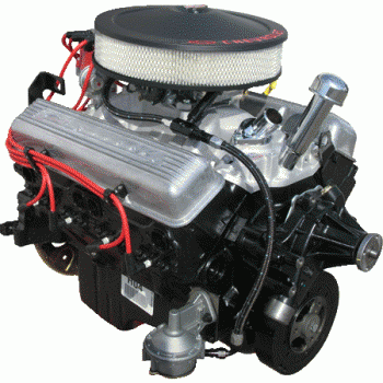

Does anyone know if the EPS will fit in a 63 - 67 car??
I have been looking at purchasing this crate engine to put into my 63.
http://paceperformance.com/i-5146228...e-package.html
It comes with an "Edelbrock Performer EPS" which Pace specially machined to accept a hidden PCV so it will function with the original corvette script valve covers.
The problem however, is that Edelbrock says the EPS will NOT fit under a stock corvette hood. BTW, the EPS is about .50 inches higher than the base 'Performer' intake.

I'm working on an 2703 EPS installation on my '64. A drop base air cleaner will need to be used. The air cleaner is a 1 inch drop Pro Form assembly.
The base plate is low enough so that it rests on top of the AFB choke housing. A ball peen hammer was used to dimple the base plate inward slightly for choke housing clearance.
A 3 inch filter element is too tall for stock hood clearance. A 2 inch filter element will work. Underhood clearance between the air cleaner assembly with 2 inch filter and bottom of hood is 7/16 inch. Trans dapt makes an air cleaner element that is 2 1/8 inches.
I'm thinking of modifying the top air cleaner plate to add some additional filter media to enhance air flow.

That Pace engine is built with a "long" water pump, as opposed to the "short" water pump with which your car was built. That means the pulley flange is 1-3/8" further forward from the block than stock. With fan and fan clutch, is that going to fit behind your radiator?
The tall intake manifold and the long-style water pump, to me, don't seem to be wise choices for what's supposed to be a drop-in new engine with the old-school Corvette look. It might be great if you want to put a "Corvette motor" in your Impala, but it seems like there are at least two potential fit issues if you want to put it into a Corvette. i do understand that there are some workarounds for the manifold height.

I am trying to figure out how to convert my quadrajet intake to one with a fill tube and use stock Corvette script valve covers. I see that Pace modified the intake to include a PCV valve. Anyone know how this was done? Pictures?

thank you gentlemen, I hadnt noticed the water-pump issue either.
Since there is conflict with the intake and water-pump, I'm thinking that I will just buy a GM crate engine that comes without intake etc, and modify an intake on my own (I have a spare Edelbrock Performer intake I can experiment on)
I searched around a little and found a previous thread on modifying new intakes for using the Corvette script covers on new motors:
https://www.corvetteforum.com/forums...-question.html
Here's a pic of an intake they modified:
To Edelbrock Intake Question
