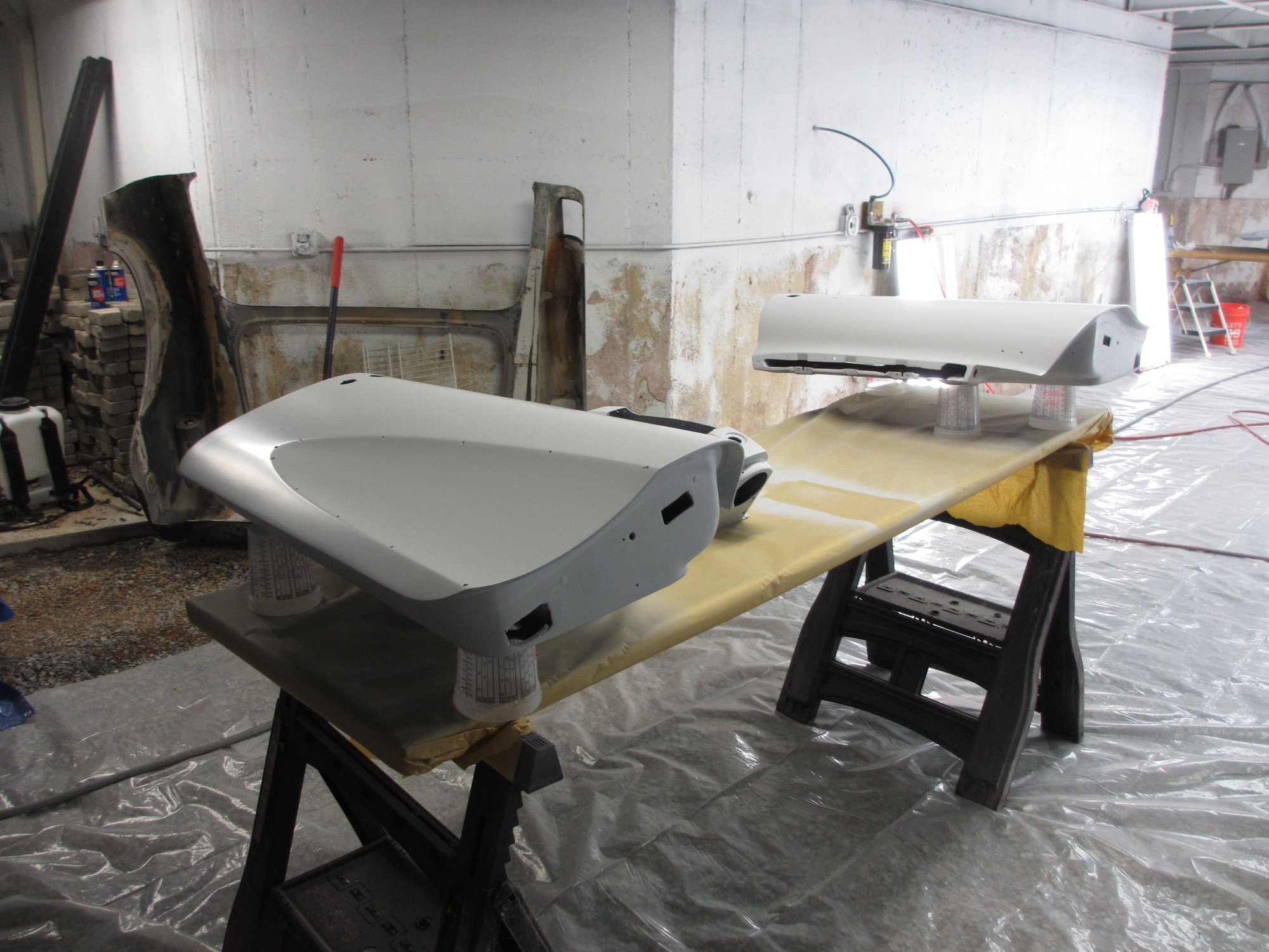

We worked on the chassis over the winter and now that we have some warmer weather we finally laid some paint in it this week. We did this one in Torch Red just like our 1960 Pink Floyd project.
Don't laugh at my poor mans home style paint booth, it works

We are doing the engine bay in the semi flat black next then we are spraying black Raptor Bed Liner on the underside of the car.

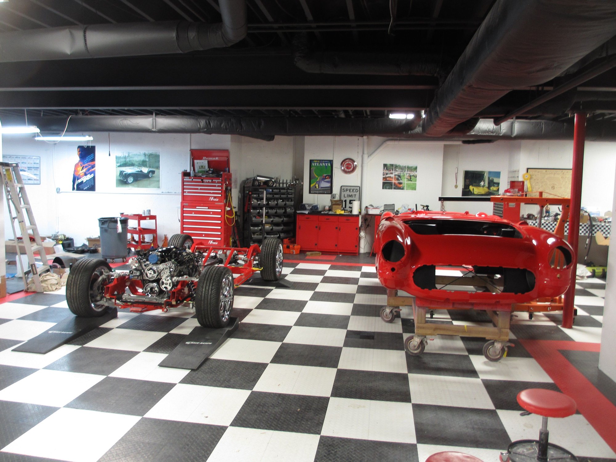

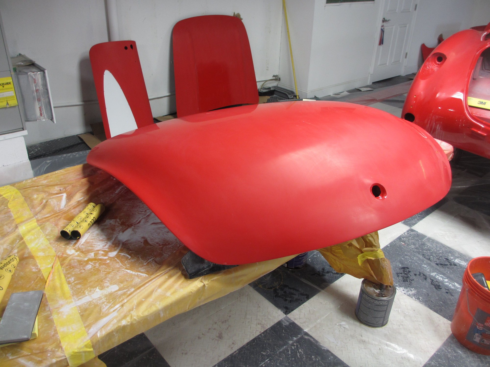

It has been a busy week, lots of progress and lots of parts coming in.
We got the Raptor Bed Liner sprayed on the underside of the car and we shot the engine bay and the underside of the hood with the John Deer Blitz Black.
I ordered a complete Al Knock interior with red leather Wise Guys seat frames in 1960 color and pattern. I am also going with the 1960 salt and pepper red/black carpet. Now I have to wait 3 to 4 weeks.
I decided to go with the Vintage Air Front Runner system and a Vintage Air Compact A/C system so that got ordered.
I decided to go with the Holley HP EFI ECU & HARNESS KIT for the LS1 so that also got ordered.
The Specialty Power Window wiper system arrived.
I dropped off the speedometer and CAD file to get a new Plexiglas face and lettering created.
The whole body has been color sanded and is just about ready for buffing. I hate seeing it at this stage of the process, seeing the dull paint makes it look like you took a step back but at the end it will look great!

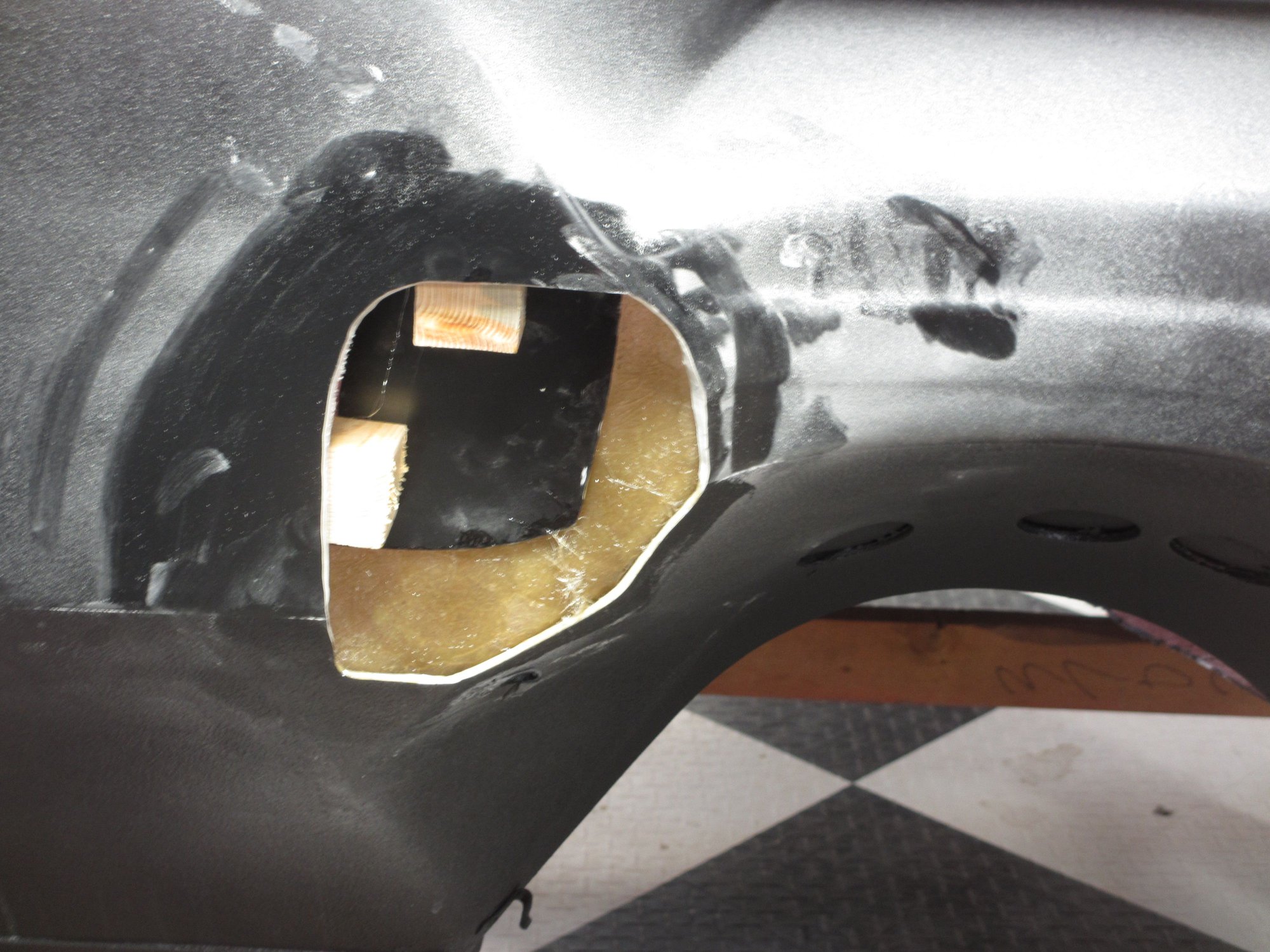

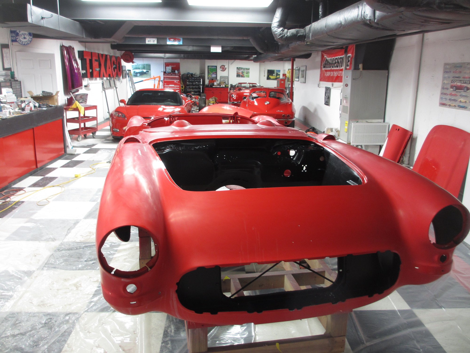

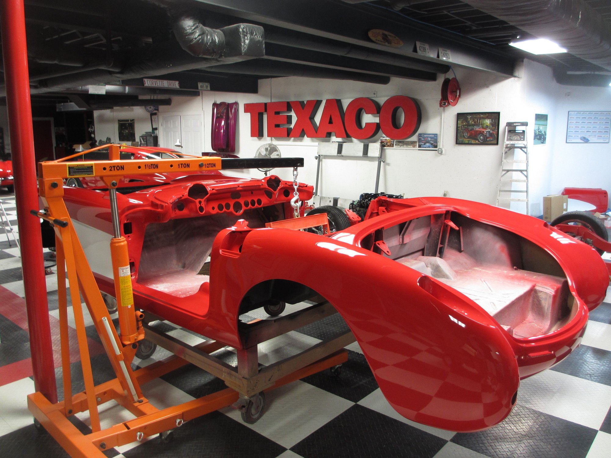

Well not the outcome I had hoped for but the fix is well under way. We got the crew over, doughnuts & coffee and got the body set on the car just to find that the passenger side head almost rubs the firewall. Since my last test fit I raised the engine 1/2 inch so it appears that created an issue.
I totally missed the passenger side head of an LS1 is closer to the firewall then the drivers side so off came the body again for some fun with fiberglass
I taped off the section that needed to be modified then I roughed in a small relief pocket, now I need just a little more finish work and paint before the body goes back on again.

OK, after a little fiberglass work and some paint we now have a relief pocket in the firewall and the body is ready for another shot at installation.

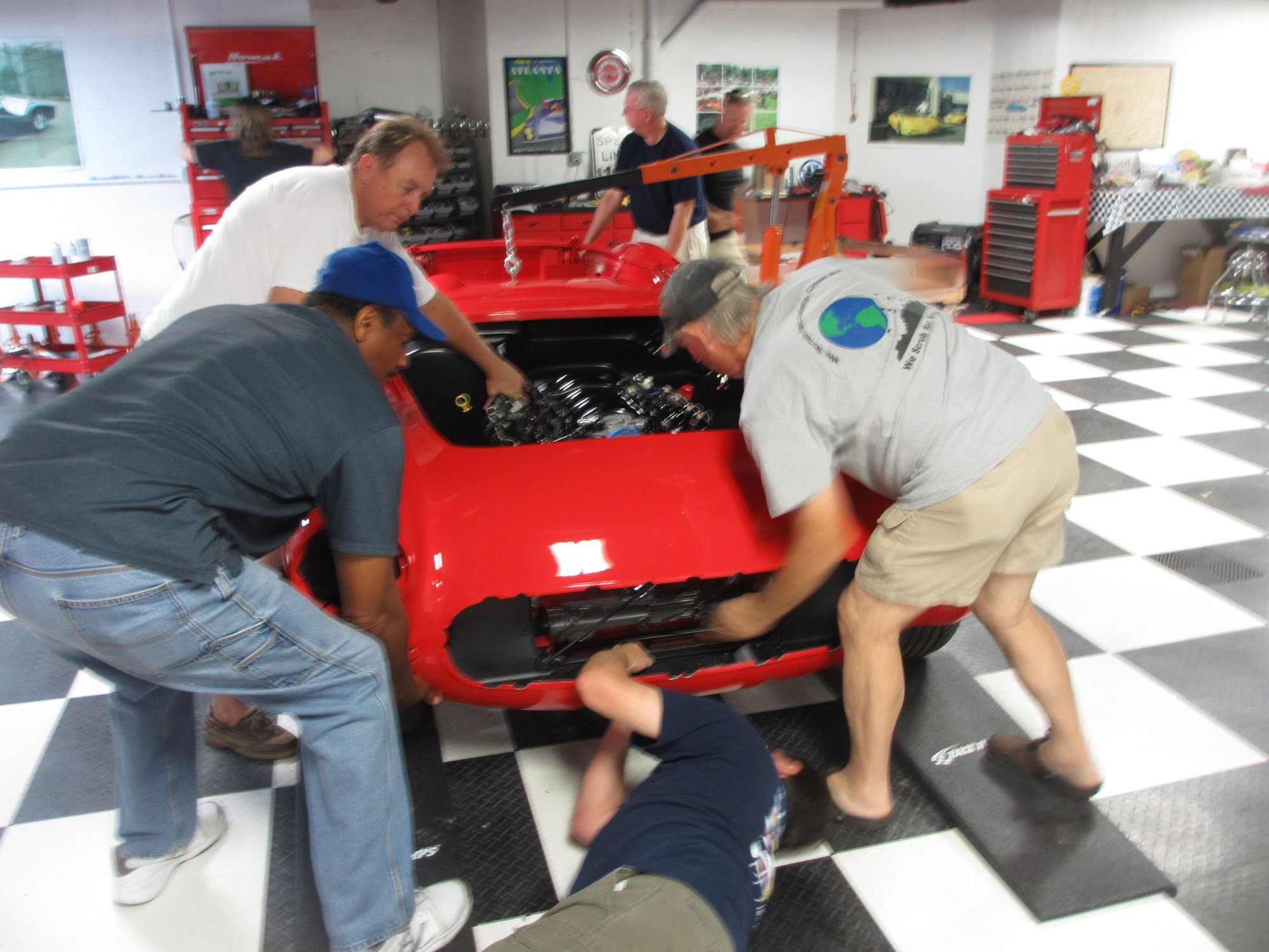

Well, we had a a bunch of friends over for a garage party tonight to take a 2nd attempt at dropping the body on the chassis and it worked out a hole lot better this time.
The relief pocket I built worked out great, plenty of room for the head now

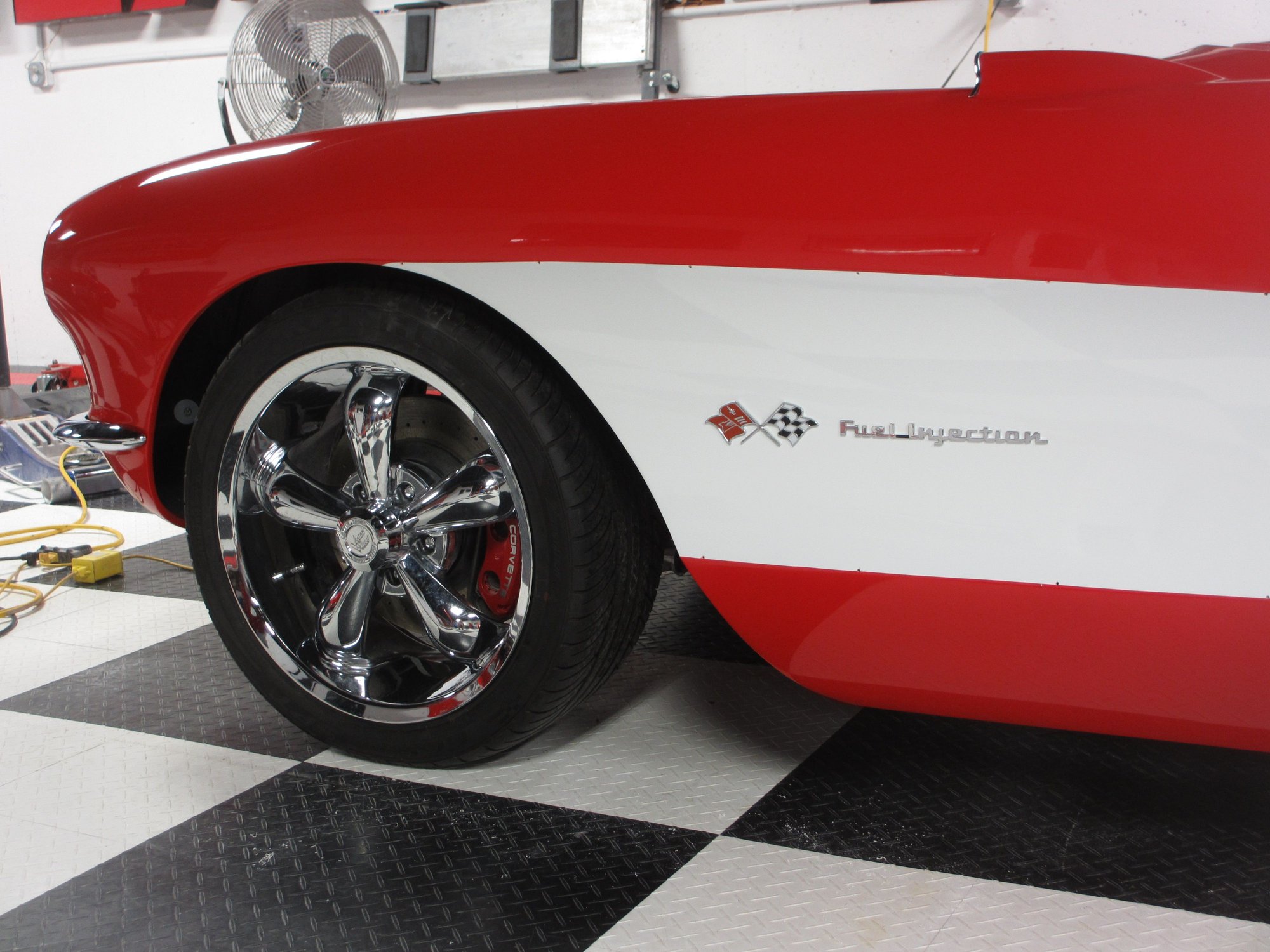

Made a little progress today, got the body all bolted down and shimmed, got the doors on and aligned, got the instruments all installed, installed some of the bumpers then the side flags and fuel injection letters.
Next I need to install the new wiper system, I have not been looking forward to that
