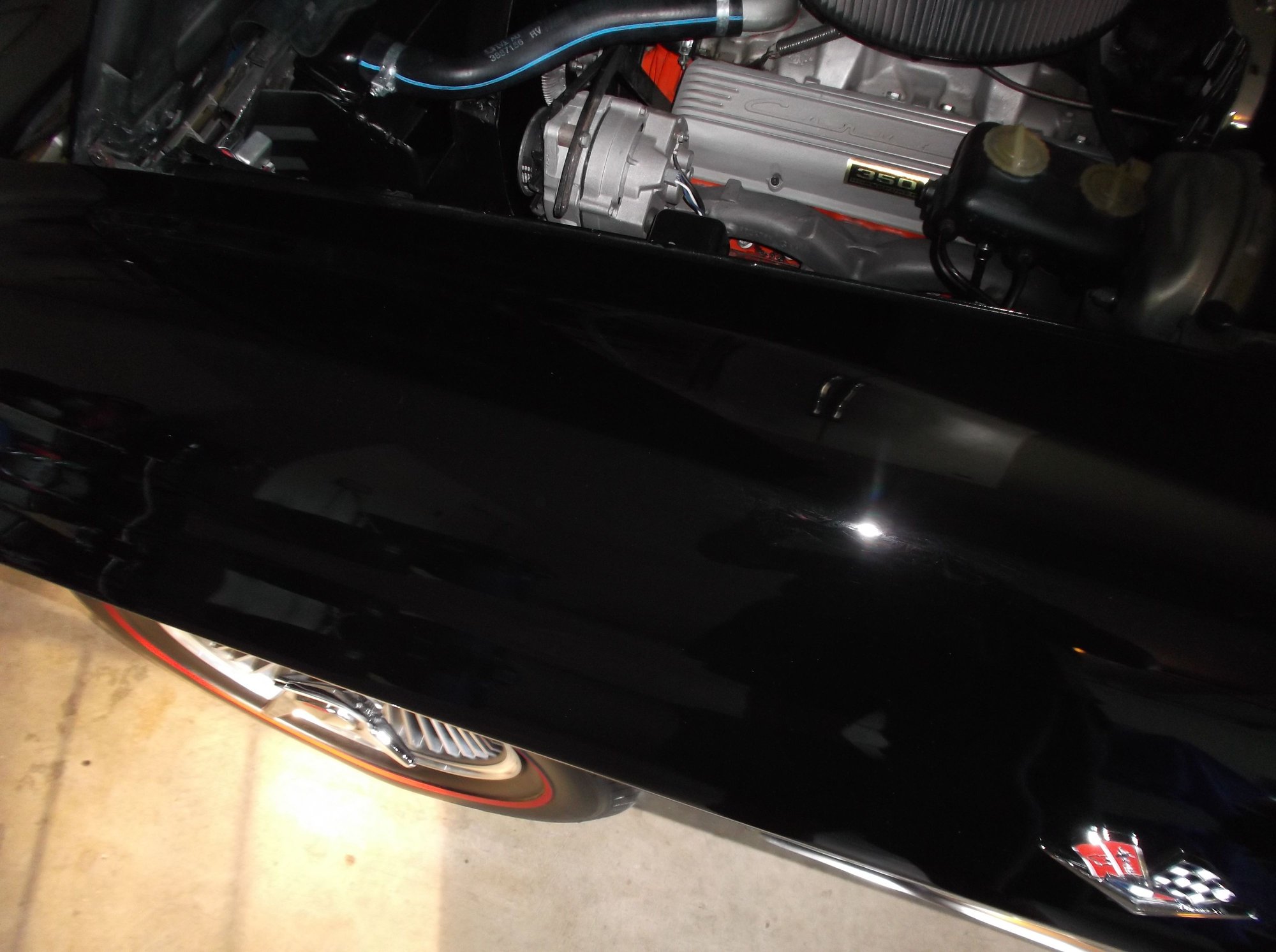

That's correct. There's no sticker on the air cleaner. They should be on the valve covers.
Gary

Big blocks got the air cleaner cubic inch/horsepower labels starting in 65, but small blocks didn't use the air cleaner labels until 1967.
Prior to 67, small blocks used water soluble horsepower decals, on the sides of the valve covers. On engines of 300 hp or less, a label was placed on the top of the valve cover, that listed the cubic inches, while engines over 300 hp, only got the hp decal.
The ones pictured above look to be foil labels, not decals. Chevrolet never used the foil labels for horsepower, but many people prefer them, because they're much more durable.

Picky, picky. Yeah, they're the Mylar foil type. I don't have my car judged and got tried of replacing decals.
Gary
