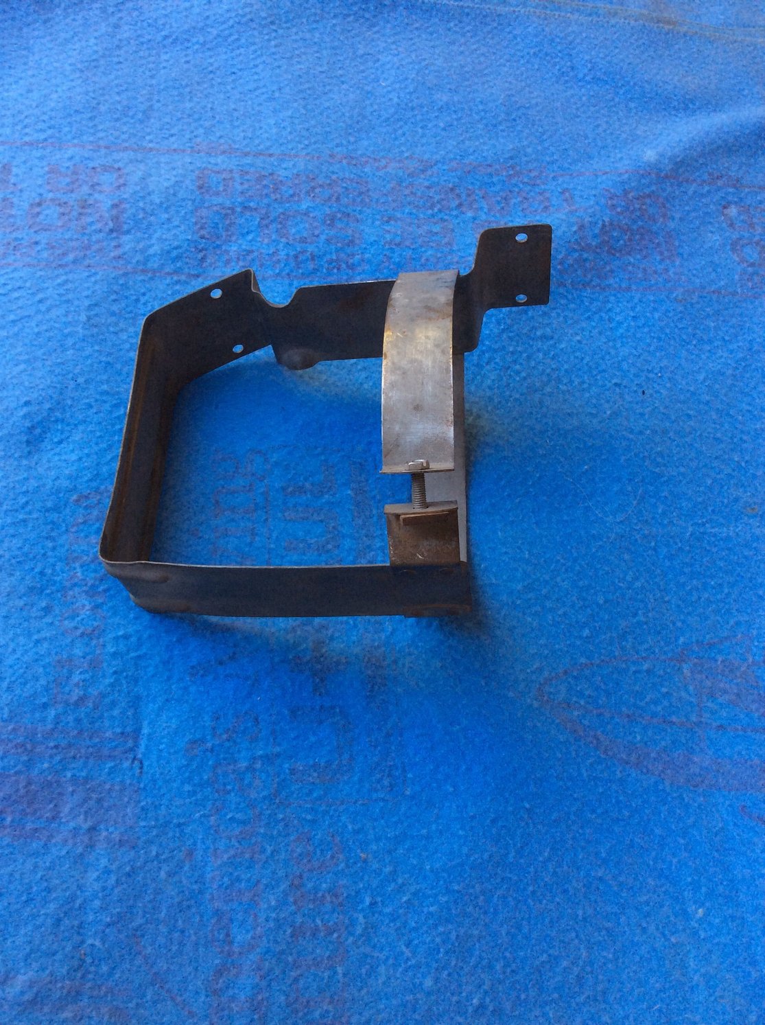

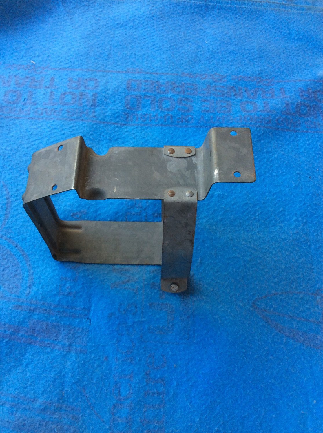

Is this the correct washer jar bracket for an early 55? The mounting holes do not match up to the holes in the inner fender wall which I believe is original. Note the lower mount of the bracket is angled versus the upper mount. Is there another smaller bracket that I may be missing?

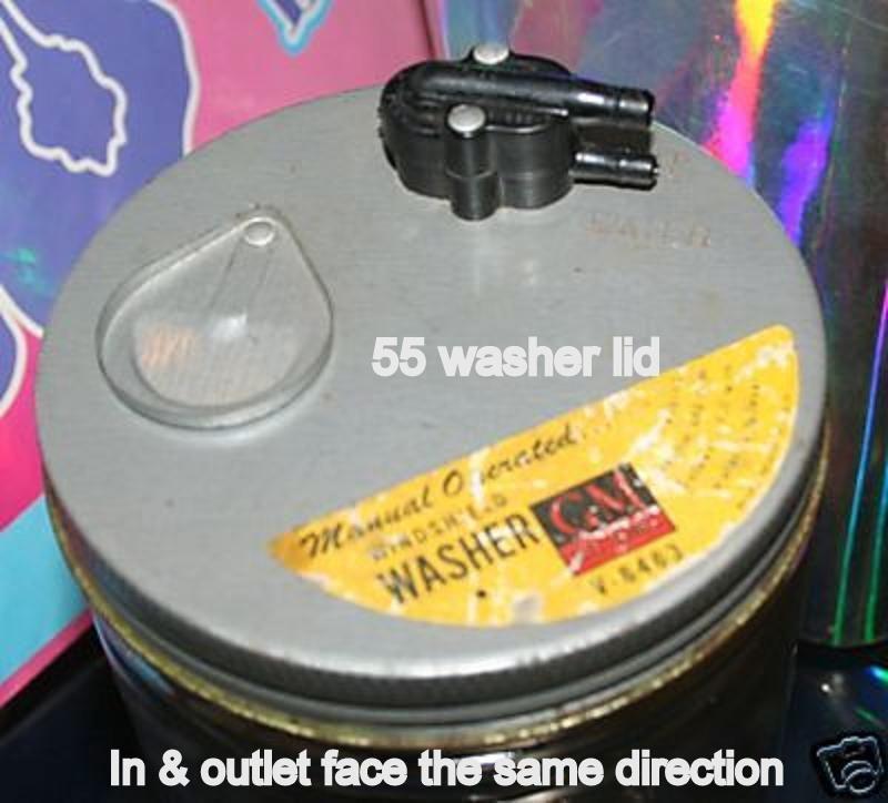

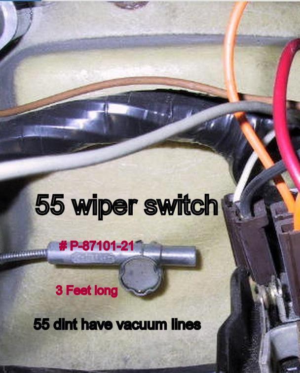

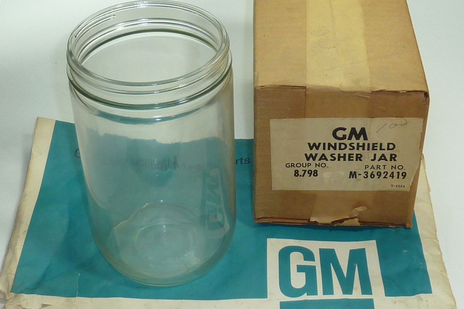

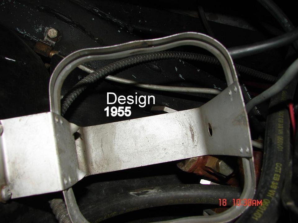

Will this help?

Thanks, Roy. The photos are very helpful. By any chance is the bracket you have pictured for sale?

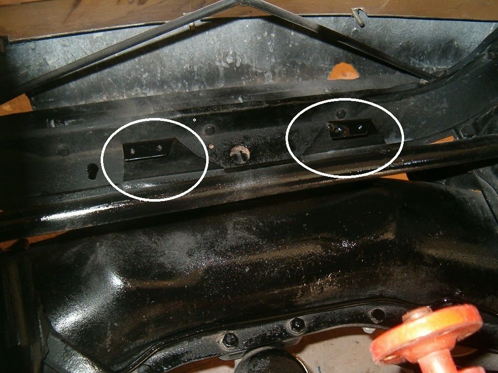

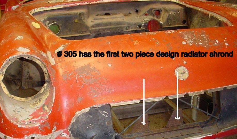

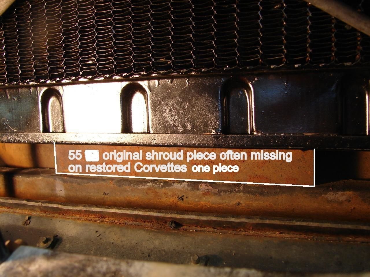

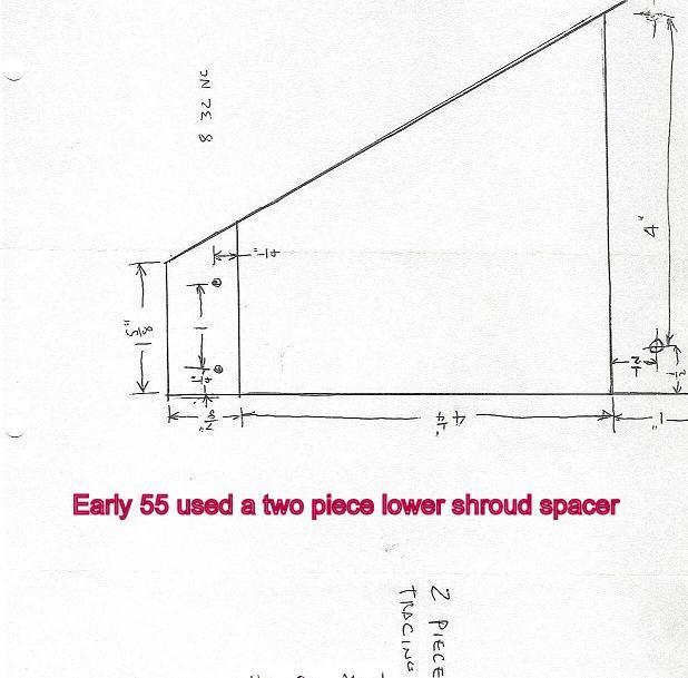

Sorry no I'v had many 55's and took and have many original pictures of NOS and original parts .You said yours is early , is the fan shroud all there? like the bottom pieces shown

Yes, I have a reproduction 3 piece lower shroud and the upper as well.

I misunderstood. Are you saying the early 55s had a 2 piece shroud, rather than a 3 piece?

No! people think the repro. (3) piece shroud for all 55's is correct ,but early 55 was a (5) piece shroud unit and later 55 was a (4) piece shroud unit. if you look at the picture you see the other (2) pieces of shroud here is the later 55 (1) piece shroud (that's what those small elongated holes in your lower should are for "screws" so that the bottom should don't move . This is in no NCRS judging manual like so many other things.

Got it. How are those two pieces attached to the radiator support?

they screw to it at the bottom inner lip ,look for the holes
