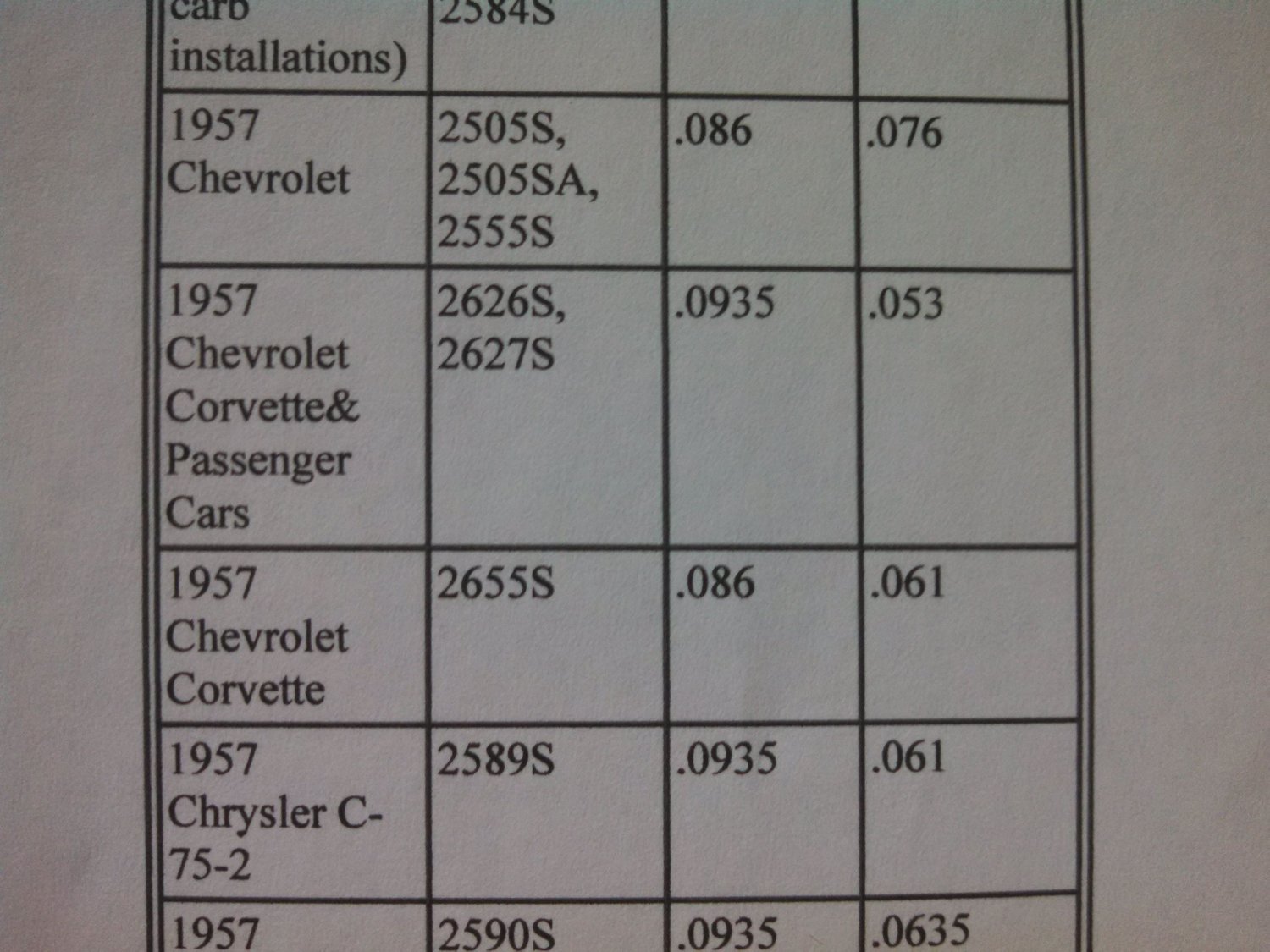

John - This chart is what i used for my 57. I'm sure your 58 is similar. I used drill bits to help gauge jets. First column is primary jet size, second column is for secondaries. Hope this helps.<br/>John
