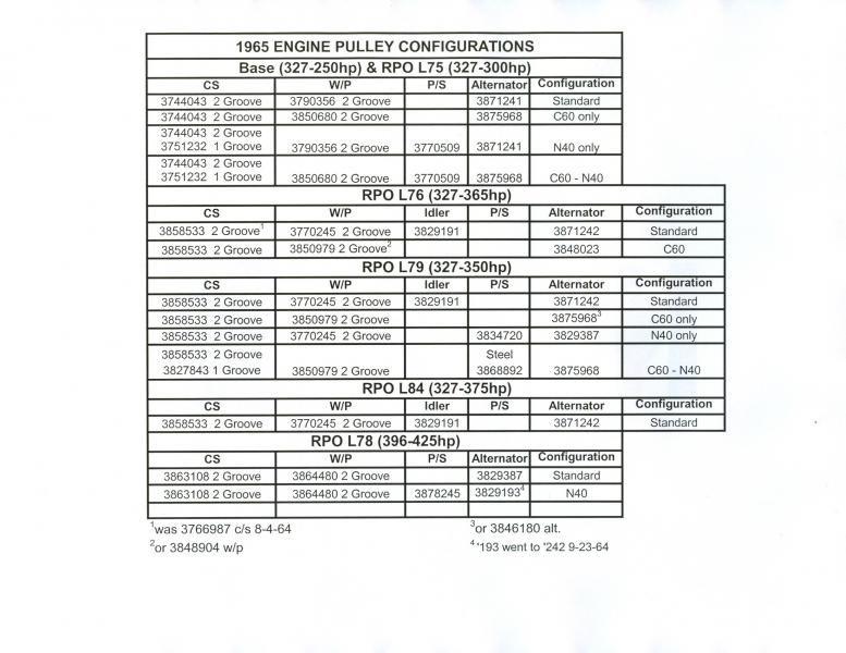

Can someone tell me the correct part number and sizes for the water pump and crankshaft pulleys for a 65 L79 with no power steering or A/C?
Also, why would some have an idler pulley? was that only for A/C cars?
I assume they were double groove too, ya?

Here's a chart that may help. Also, your AIM will show belt configurations around (don't have a '65 AIM) UPC 6, Sheet A4-A5.

The chart was made by Mark Gorney, an NCRS member. He developed a series of engine pulley charts for midyears and posted them on the NCRS forum years ago. His charts have been regarded as the most accurate ever put together by anyone (including GM).

Might mention that for the L79, there is considerable doubt that any came with an idler.
I happened to buy a '65 L79 which had an idler. It was questioned by some folks with a lot more experience than I had at the time.
My research led to the conclusion that they were right. The 365hp motor (and FI) had an idler, but the 350hp L79 did not come with one.
