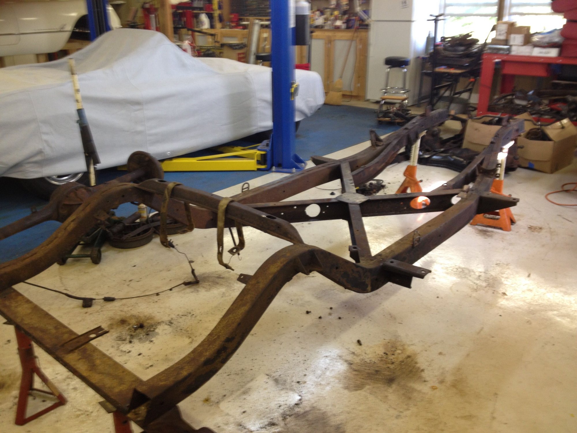

Frame is ready to have a blast...
Is there anything more fun than doing a body off.....EEEHAAA...

I'm impressed that you removed the body relatively intact. Other than the steering column, wiring harness and brake pedal assembly, what other items were removed before lifting the body? I presume you plan to repaint the body.

I removed the interior, radiator and disconnected a couple things. The steering column remained in position I just unbolted it from frame, there wasn't much else to remove. I had 8 friends and a two post lift, made things easy. The body and chrome are presentable so I'm leaving it as is and just doing a frame/drivetrain resto. I'll drive it next summer and then have it painted the following winter. At least that's the plan...

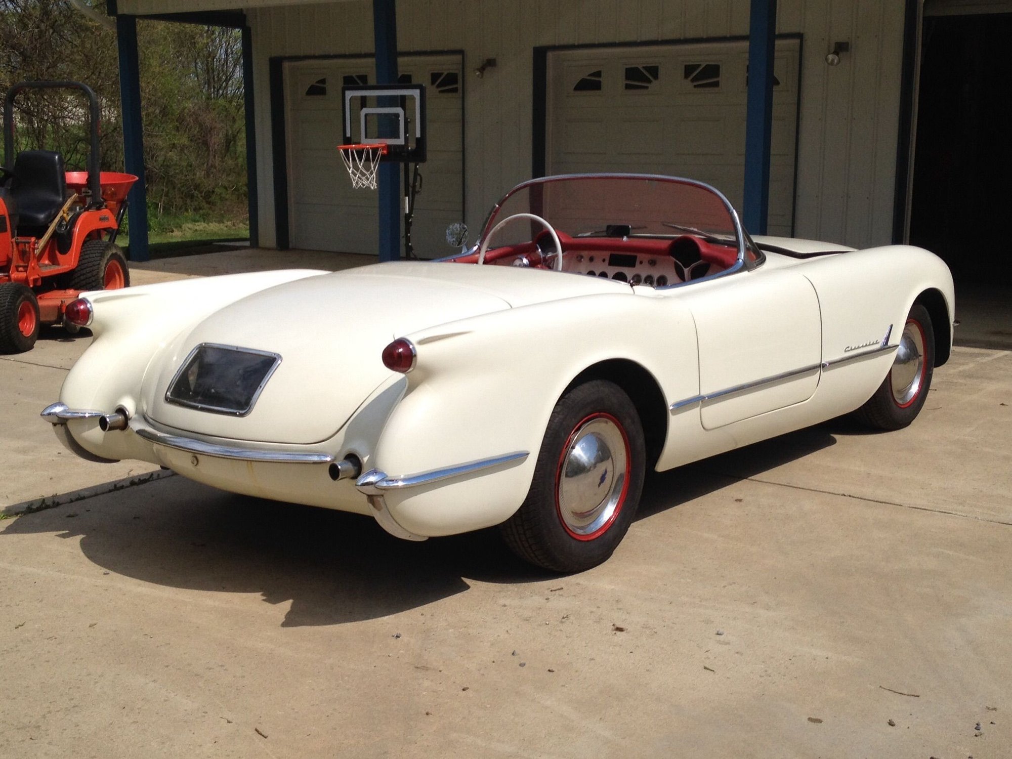

Here's a pic of the car when I bought it. Missing some interior pieces and V-8 powered but really a nice mostly complete '54.

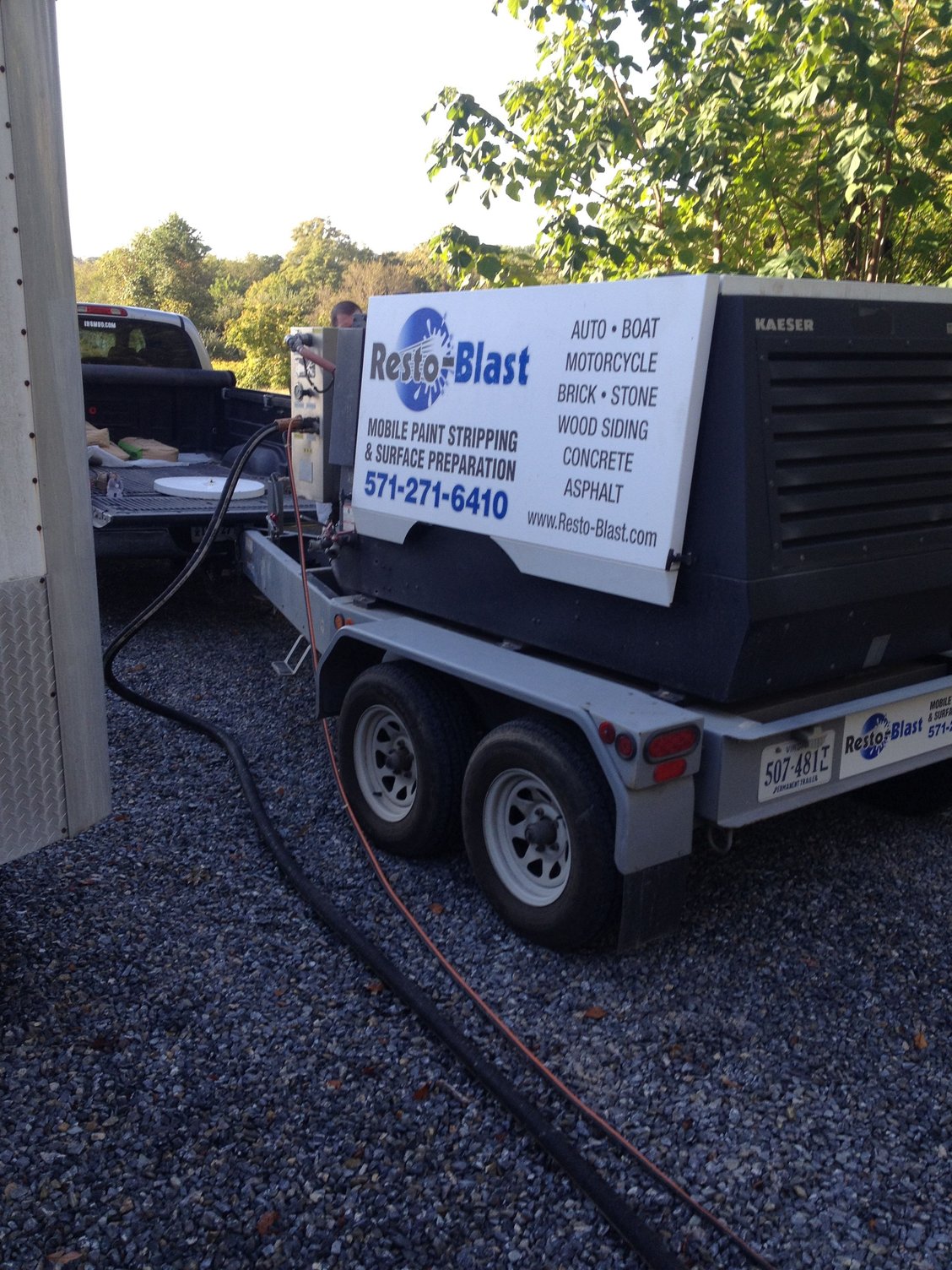

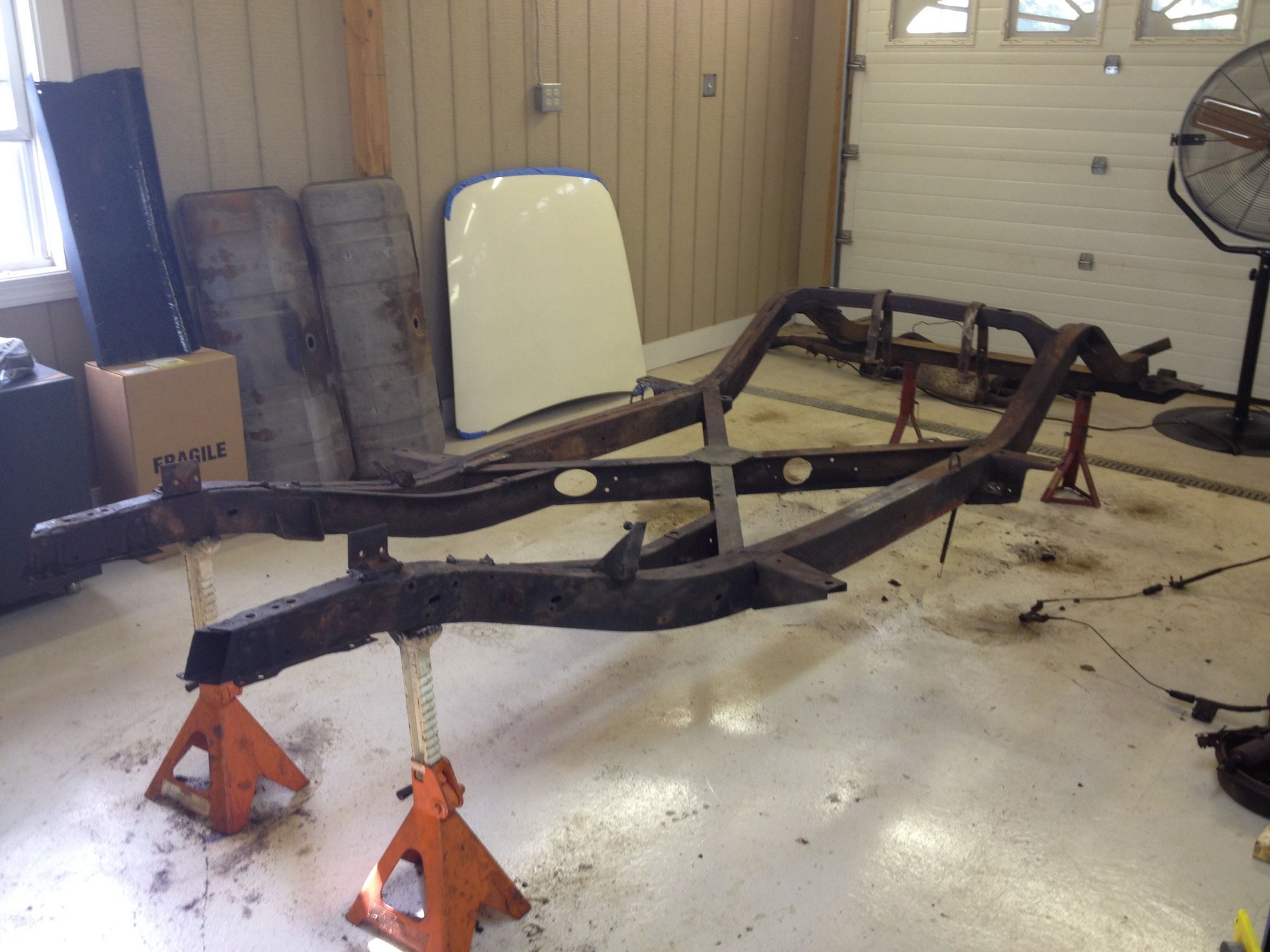

I had the frame blasted today. Guy came to the house and blasted it in the driveway.

Dust free process, grit/water mixture and a chemical in the water to prevent flash rust. Pretty cool...
