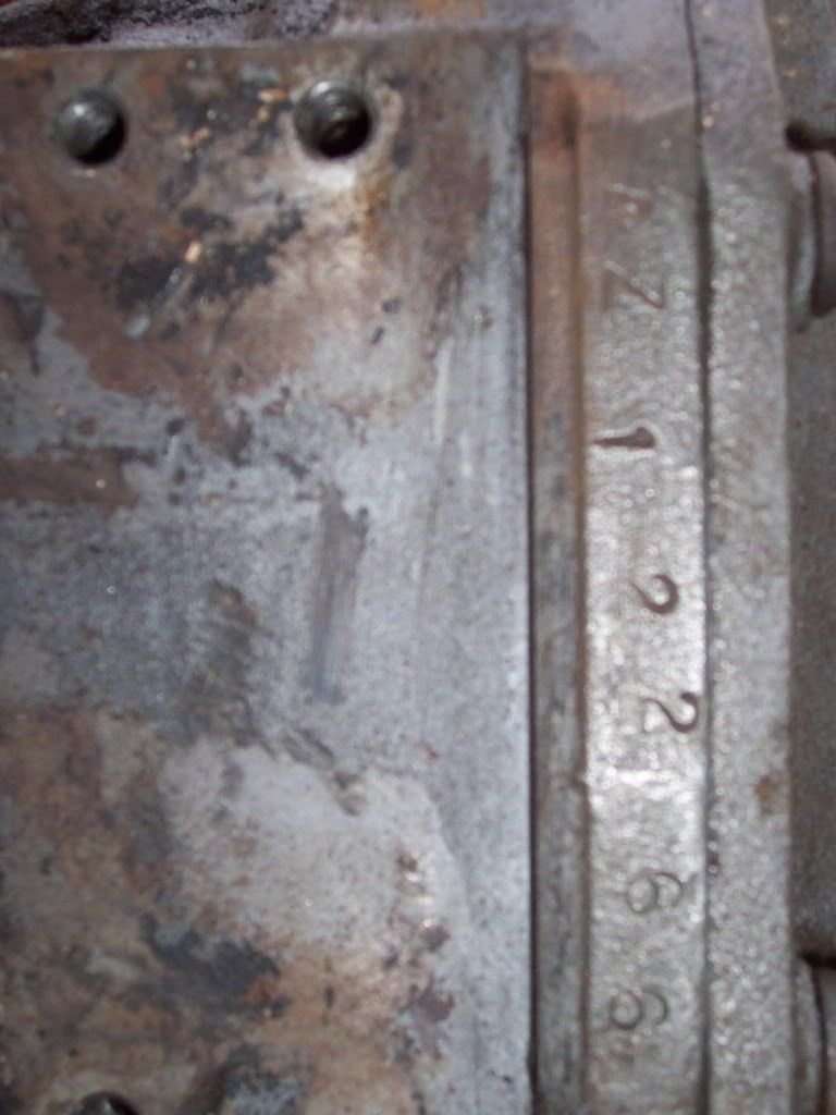

Here is one as seen looking up toward the axle from the ground (it's a 67
AZ = 3.55 (from a 427)
122266 = stamped Dec 22, 1966

You're looking for the wrong thing, in the wrong place. You'll find the ratio code and assembly date STAMPED on the rough as-cast surface of the BOTTOM of the diff, between the strut rod bracket and the rear spring retainer plate. It'll take some heavy cleaning to make it readable, as that area is usually pretty dirty.

OK-Finally checked it on the bottom (couldn't see it at first because of the floor jack.... (-
It is stamped- CA 10 which makes it a 3:36
according to the above codes that would make it a 3.36:1 standard Manual Transmission....It now has a 4 speed in it and the rear is Posi, so something got changed or?....

look again a little further across the casting for the rest of the date code.
There has to be some more digits for a full date such as 10 ** 63 or 1 0* 64
or something. The digits are usually widely spread apart as in the example shown.
And yes, if there is a posi in the box now, then someone made some changes to the original CA box.
