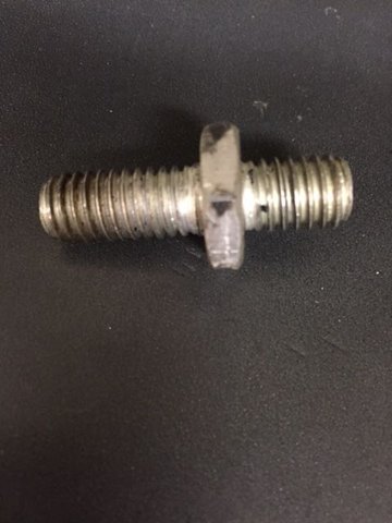

I'm confused when you say the stud should be screwed in until they bottom out in the hole. It isn't a stud. This is what it looks like:
The short end into the pump and compresses the O ring.
CUL Jim
CUL Jim
Well, I've already stated that I don't have an o ring. My stud is not like the picture of yours. It is a stud with a hollow end for an Allen wrench and a nut meant to tighten against the adjustment slot in the bracket. It looks like your nut is welded to the stud. Mine is not. A little different design.
Gloryhog
I must have misunderstood what you are asking. We're talking about two completely different things. Sorry. Hope someone else can help.
