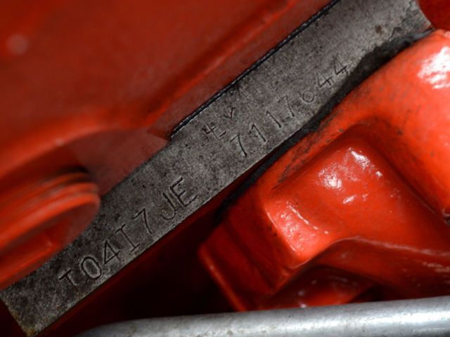

The "I" character was used in place of the "1" character in the engine plant stamp - it was perfectly normal.
Here's a stamp pad pic I had handy - it's a big block, but you can see the use of the character "I" in the engine plant stamp. It also shows an example of a '67 VIN derivative.

Old Oct 7, 2015 | 10:00 PM
GILSWHO's Avatar
GILSWHO
Joined: Jul 2013
Posts: 196
Likes: 7
From: Newtown Square PA
Thanks Mike. Greatly appreciated.
