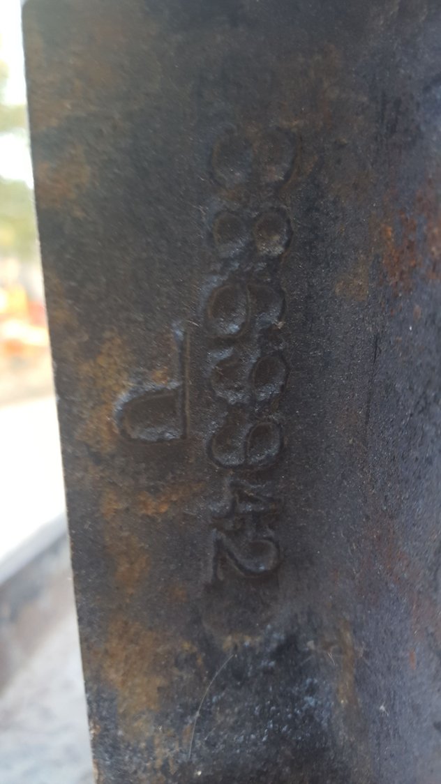

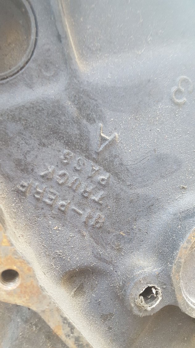

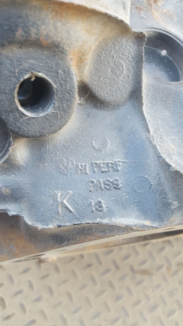

Pictures of the casting numbers on the rear bellhousing flange, all numbers on the front stamp pad, and the cast numbers on the side near the coolant drain plug. Also a picture of the side of the oil filter mount showing the oil line fittings. And also pictures of the bores, lifter valley, and main caps.

Old Oct 11, 2015 | 10:14 PM

A pic of the engine pad??

I'll have to get some more that's all I have right now
