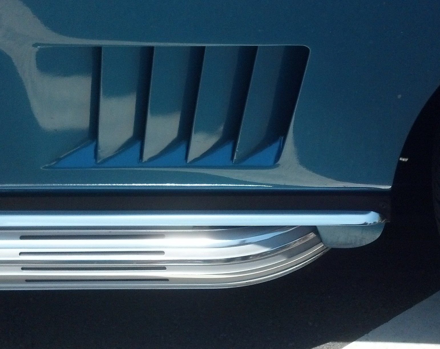

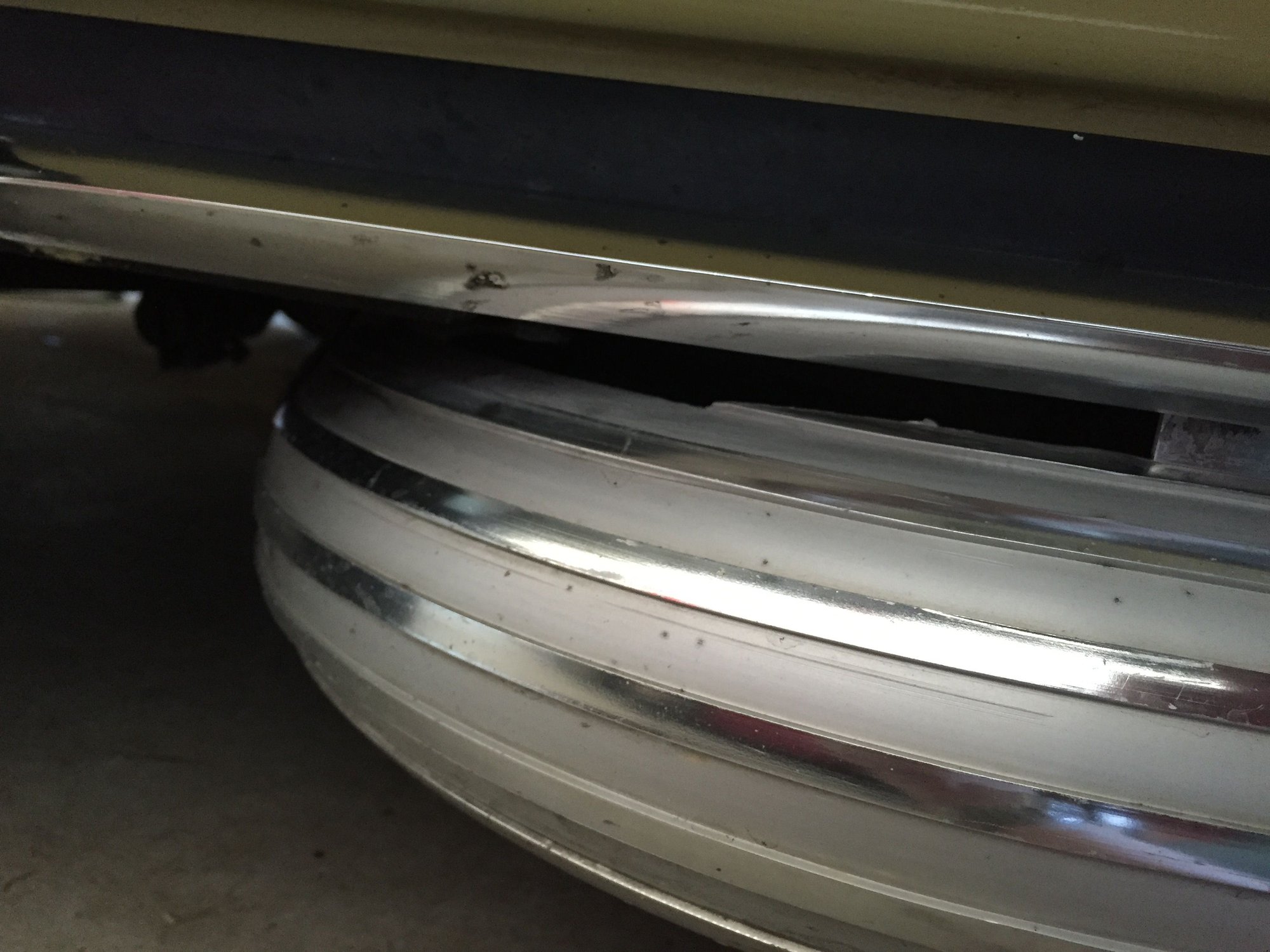

Originally Posted by C2L72
I have tracked it back to 01 and it was then not that the last 15 years mean too much, there was no wear marks/corrosion on the inside of the standard mounts. No documentation found as of yet, but all of the numbers match and everything adds up. Is there any way to verify the side pipes?
As long as it's not an A.O. Smith car, you've got a shot. This older CF thread should help:
https://www.corvetteforum.com/forums...th-1967-a.html
And it shouldn't look like THIS!
When you say it shouldn't look like this, is the chrome notched area at the front what you are referring to?
Old Oct 19, 2015 | 01:32 AM
big block ken's Avatar
big block ken
Posts: 839
Likes: 236
From: Mount Holly, NJ
2021 C2 of the Year Finalist - Unmodified
Yes. I can't even tell what year side moulding that is. But it looks like someone put side exhaust on, using NON side exhaust moulding.

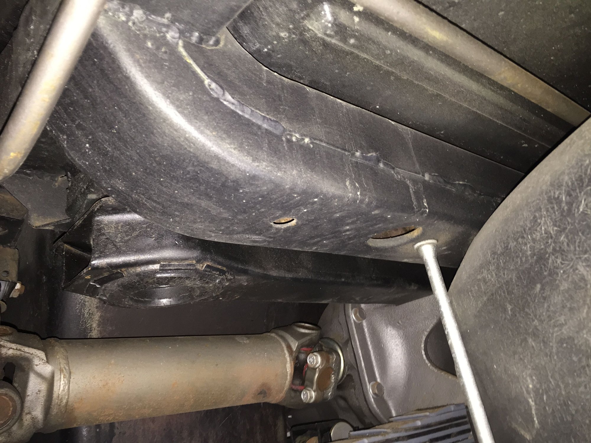

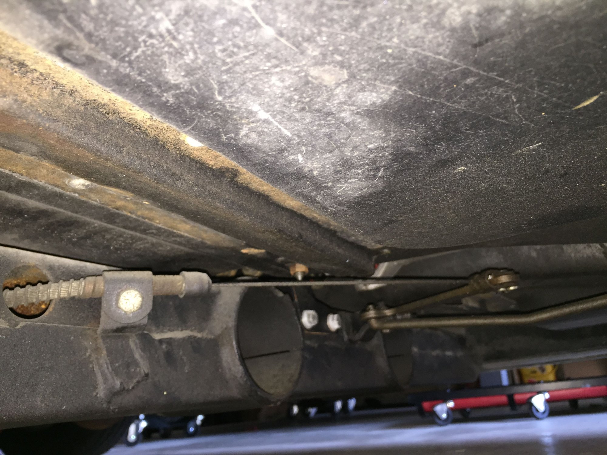

Question on the side pipes would the mounts for the standard exhaust still be on the car?
No. An original factory sidepipe car will not have ANY trace of undercar exhaust pipe hangers, clamps, ground straps, or muffler hangers. Detail guidance on this issue is provided in the NCRS Judging Guide.
Old Oct 20, 2015 | 11:49 AM
C2L72's Avatar
C2L72
Joined: Oct 2015
Posts: 45
From: Va
So would the frame cross member #2 be solid and not have the two holes?
Old Oct 20, 2015 | 12:34 PM
66BlkBB's Avatar
66BlkBB
Posts: 3,345
Likes: 87
From: Northern MN
St. Jude Donor '13-'14-'15-'16-'17
No, they used the same cross member. Look behind the side pipes. If you see any evidence of cutting, bending back, etc. of the hangers for the lower side moulding, it would not be a factory side pipe car.
Old Oct 20, 2015 | 12:41 PM
C2L72's Avatar
C2L72
Joined: Oct 2015
Posts: 45
From: Va
Nothing like that, just the cross member which I originally referred to as the exhaust mounts but then looking at diagrams figured out what it was. I should have taken better pics when it was up on the rack will look and see if I took any of that for confirmation from the group.

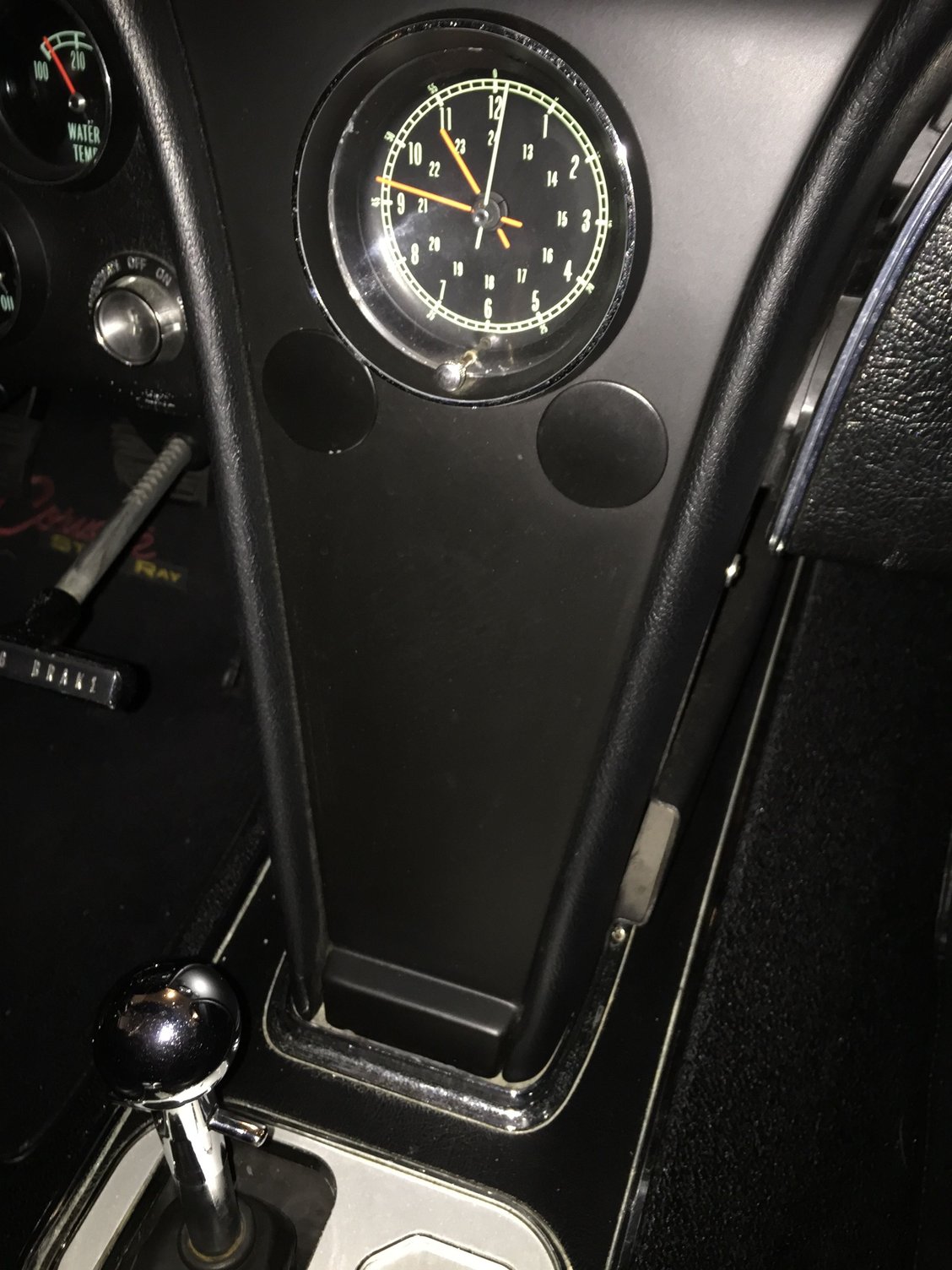

C2L72's Avatar
C2L72
Joined: Oct 2015
Posts: 45
From: Va
The dash and heater delete panel
