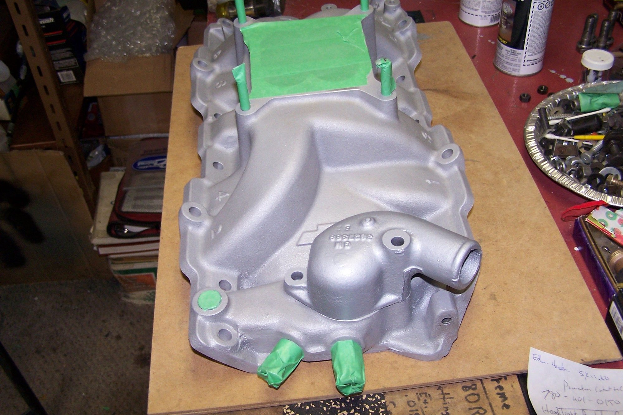

I had my intake glass beaded with something called #5 glass bead. The thermostat housing is painted aluminum and the manifold has been glass beaded and a coat of semi-gloss clear applied.
This is what it looked like after.
Anybody with a bead blaster can easily perform this operation for you.
You can buy a cheap chinese one and do it yourself if you have a compressor.
That's what I did,
