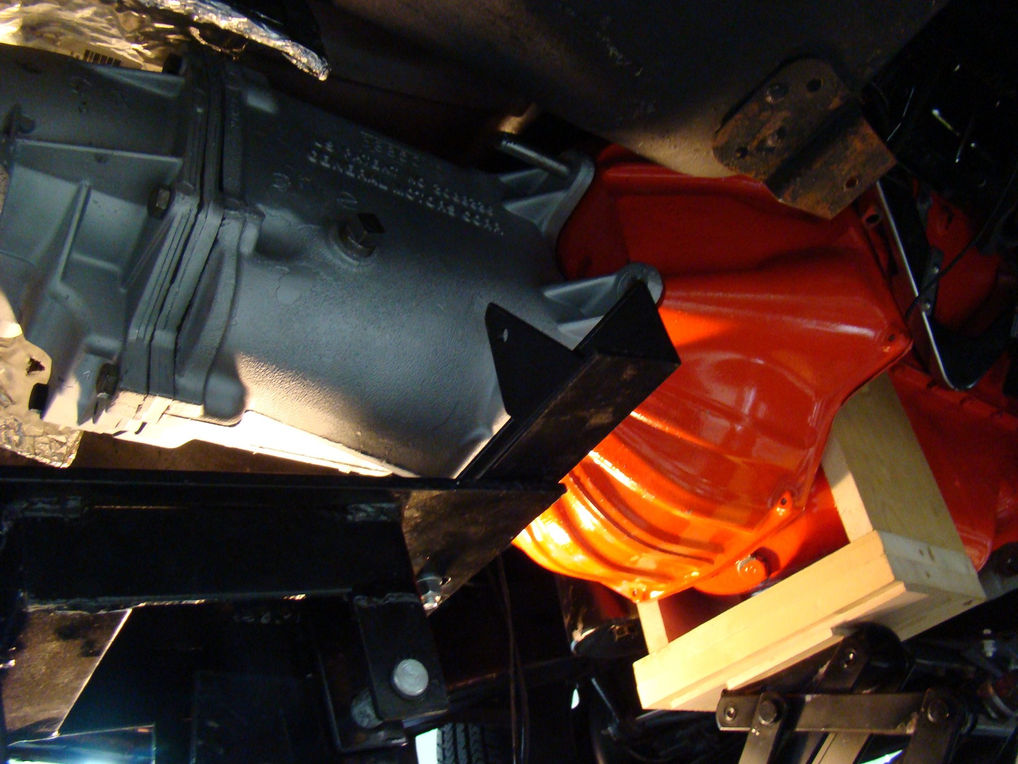

I’ve pulled my Muncie out of my small block ’67 twice in the last five years without pulling the distributor or the bell housing. I lower the rear of the engine carefully watching the clearance from the bottom. The engine can be lowered enough to clear the input shaft without the distributor contacting the firewall.
Pull the motor mount to frame connecting bolts so as not to stress the motor mount rubber. Use a wooden cradle to support the engine as JohnZ has recommended many times. A transmission jack and lift are a huge help.

I just pulled the Muncie M-21 out of my 64 coupe. I pulled the dist. cap off {just in case), put a jack under the oil pan using John Z's method, removed u-joints from front of drive shaft, pull driveshaft to the rear and set to the side of the cross-member, and remove yoke ( might want to put plug in to stop the oil from coming out), removed all the shifter linkages from transmission, shifter and lower from below. then remove the shifter mount, removed top two trans-bellhouse bolts and replaced with bolts with heads removed (dowels), removed lower trans-bellhouse bolts and removed the tailstock mount. Pull back transmissions until input shaft clears bellhousing, start to gently lower front of transmission by the left side of bellhouse and while doing so, rotated trans. counter clockwise 1/4 turn, and it should come out. I did this while lying on my back with the car on jackstands and without a jack under the transmission, I bench pressed that sucker out, and I'm 64. I never had to lower the engine.
