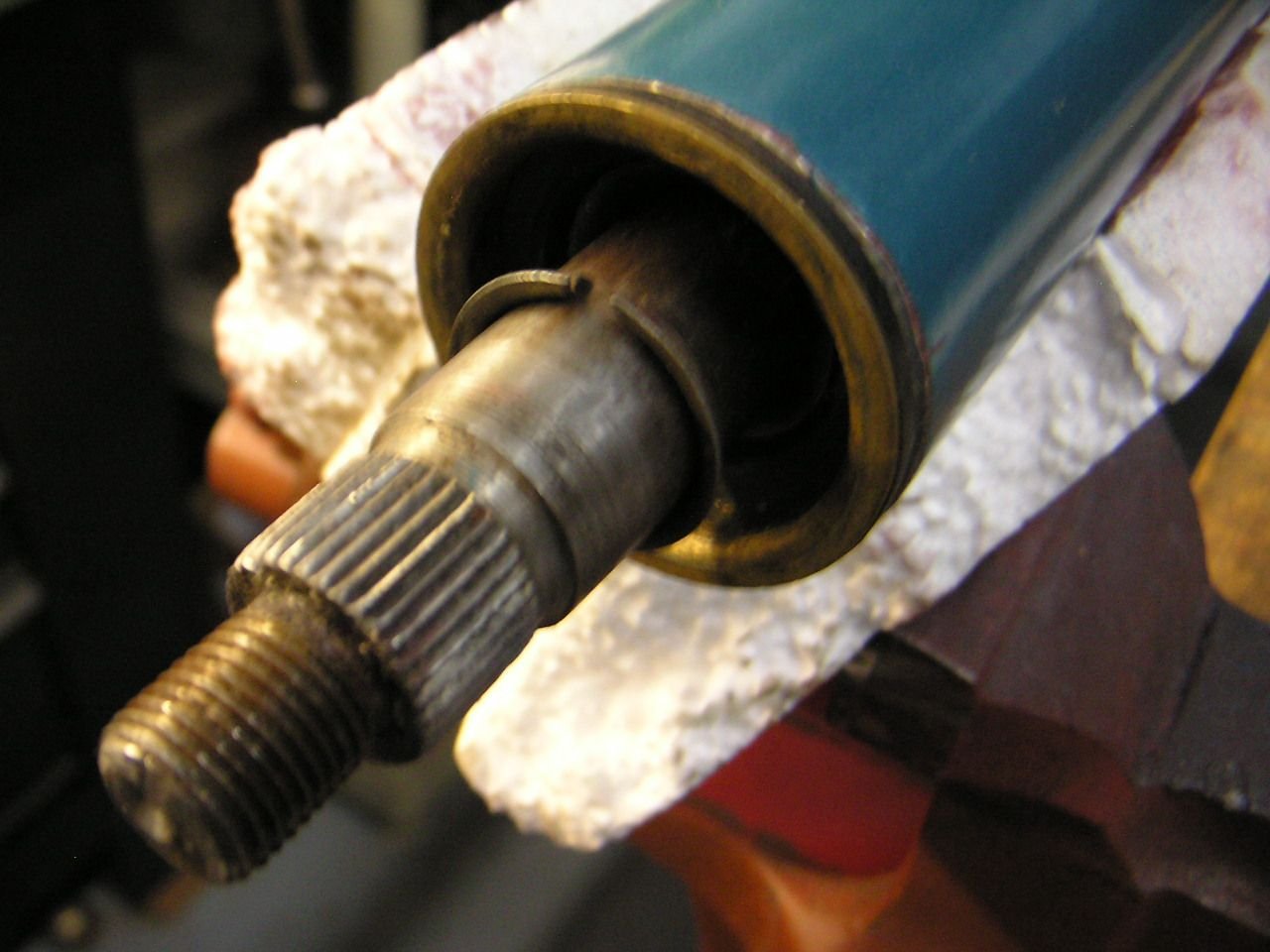

This is a file photo so I can't measure it for you. I have 3 C1 columns here on cars but they're all together now. Maybe the pic will help.
Are you trying to shorten the column? I did one for a buddy a while back.
I cut the shaft and removed a section, drilled and tapped the ends for a 5/16" stud. Beveled the ends, installed the stud to both ends and welded the shaft ends together. Ground the welds a bit to clean it up.
Then cut the equivalent section from the column tube and beveled the edges and welded that together. Dressed it with some grinding and sandpaper and done.
thenn cut the equivalent section from the column tube and beveled the edges and welded that together. Dressed it with some grinding and sandpaper and done.
Thanks for the picture, It helps.
Yes, Something like that, I have taken the lower section of a C4 and the upper section of the C1, I slid the C1 inner shaft into the C4 inner shaft. It fits perfect. I have about a 2" in and out adjustment.
So I can move it in or out as desire but I need to know how much to leave out at the upper end to properly mount the directional switch, Hub and steering wheel. If I had the measurement from the upper bearing brass housing lip where it sits on the outer tube to the end of the threaded area would be great! I didn't have the C1 steering column assemble when I got it or else it would have been easy.
The inner shaft does have a dark area which I believe is where the upper bearing sat.

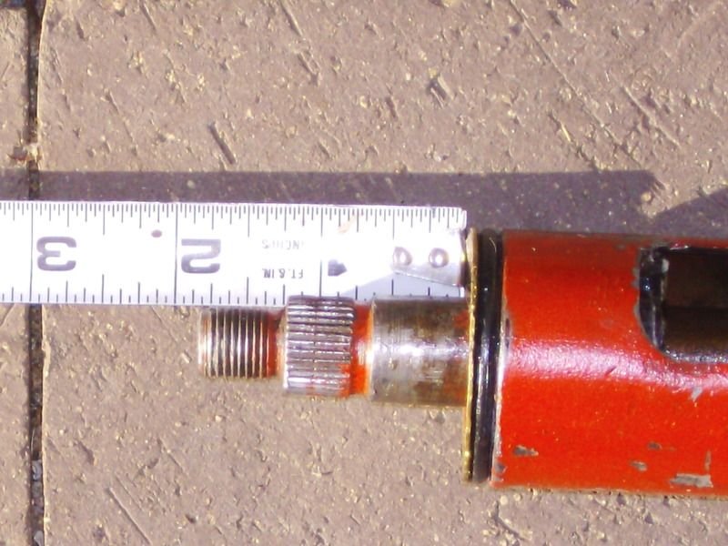

I made it 1 13/16 inches
'57 steering column
'57 steering column
Thanks you! That's exactly what I needed!
Thanks to every one else with their others ideas, like the collapsible shaft. All good stuff.
