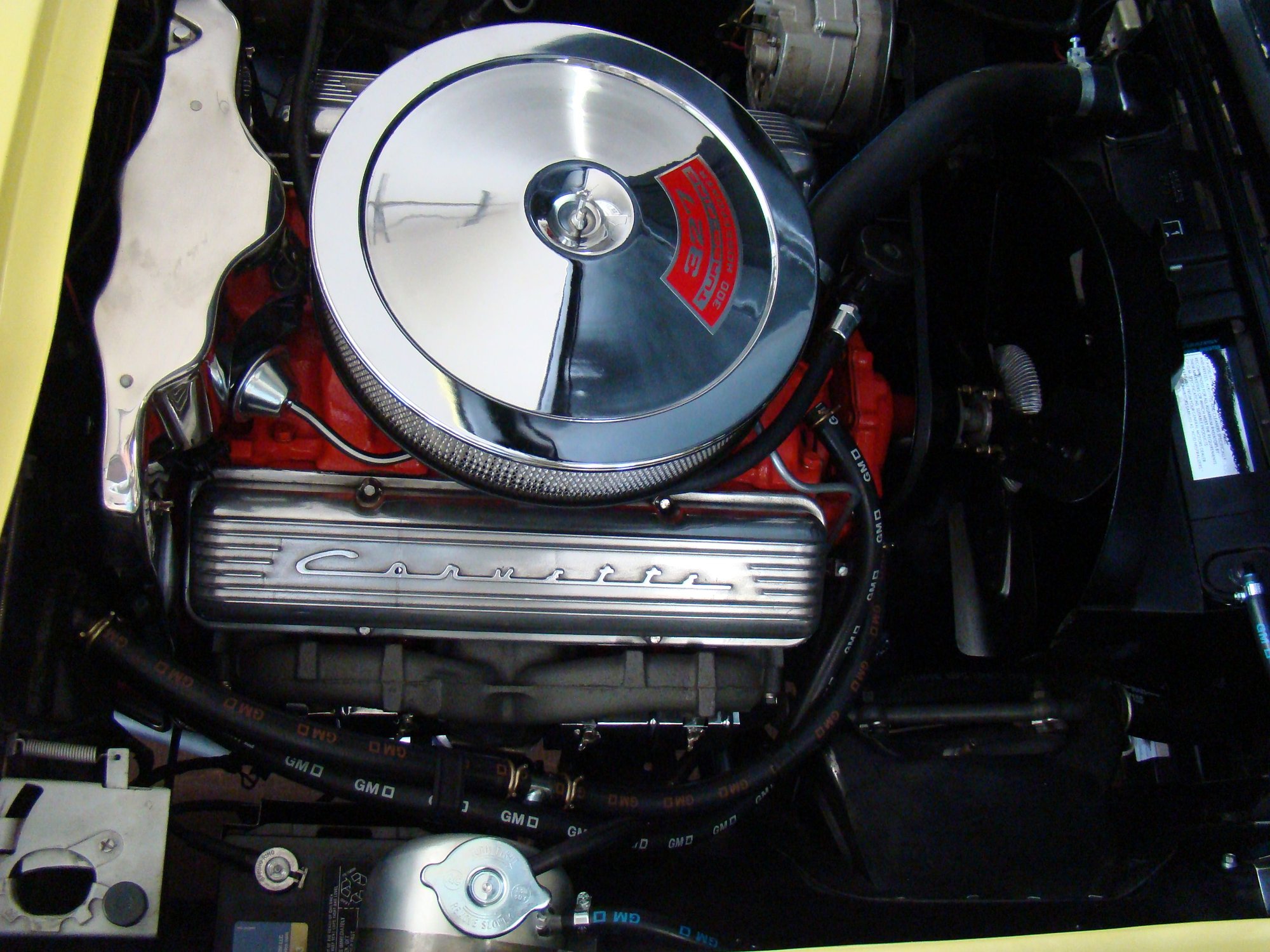

Hoses, clamp kit, Tee, dated expansion tank (DeWitts) all from Paragon. Installed over two years ago, no leaks or issues.
