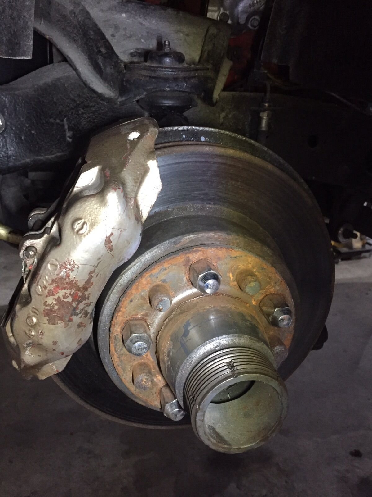

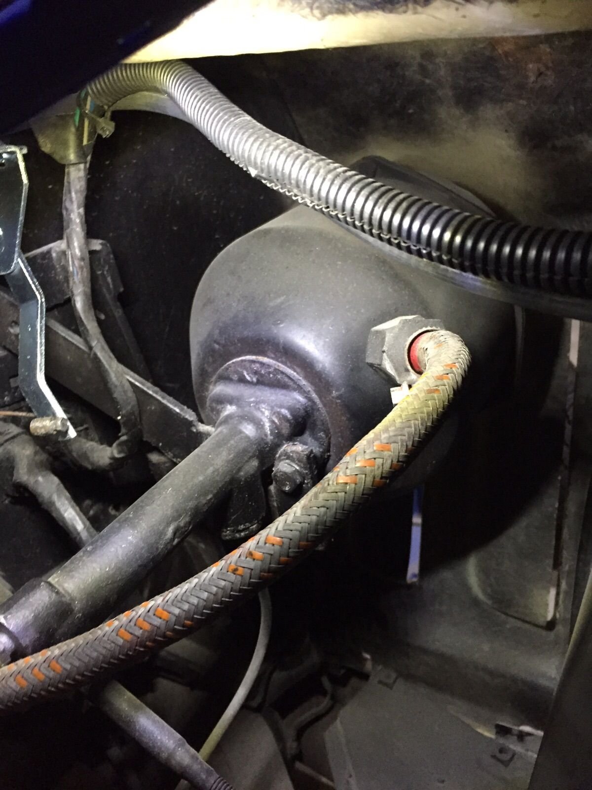

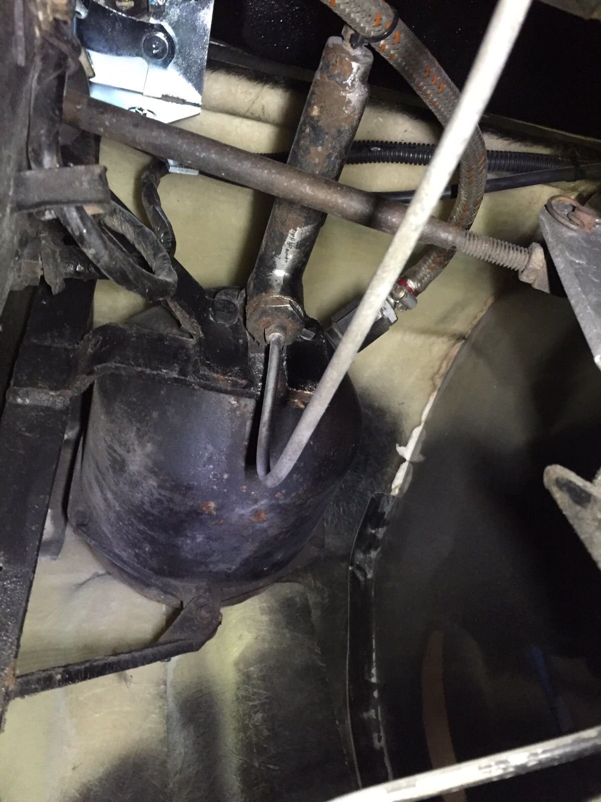

Long time for making pics
Here some pics of the brake system
Does anybody know this kind of brakes system. The brake booster is placed in the fender.
It looks old. I have not seen this one at any corvette.
Oliver

Wow, that is one strange settup, the master cylinder appears to be an original 65 but has a modified lid on it, the other device mounted down by the fender appears to be some sort of vacuum assist device if that is a vacuum line going to it.
Your caliper is a standard caliper, not J56 caliper. And your knockoff adapter is a reproduction item.

The bracket holding the vacuum booster appears hand made. It's possible that someone added this from another vehicle later in the cars life when it was too difficult to obtain an original power brake assembly.
The design of this "brake booster" seems generic enough that it could almost be added to any single line master cylinder to add power brakes. I'm betting that is how and why it was added.
Good luck... GUSTO

I know that the wheels are repros. I have bought code correct steel wheels, because the car was delivered with hub caps.
That´s my opinion, too, that the braking system is homemade. I will rebuild it and build the car to original standard.
