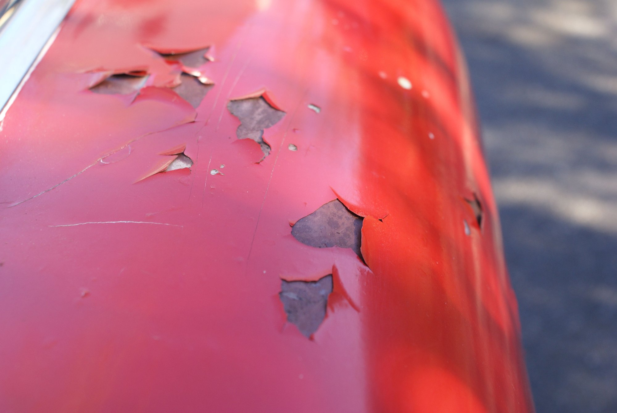

It's been cold here the last few days, 34 Degrees. When I pulled the car cover off this morning this is what I discovered. Two weeks ago, this was not happening. I have owned this car for over 14 years and never seen paint pop off like this. What causes it?

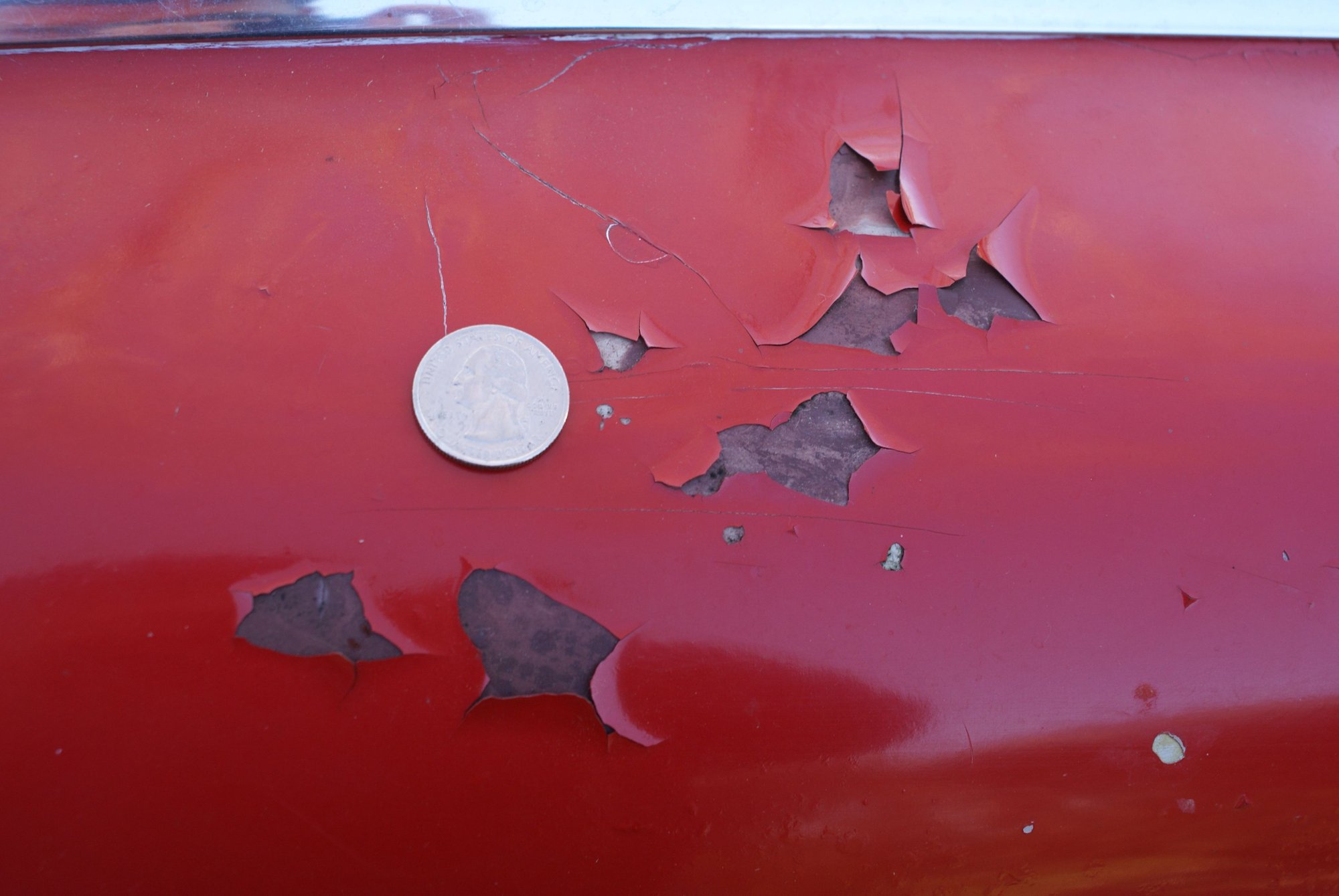

A quarter for reference.

Poor prep before paint. Plain and simple.

I'm no paint expert by any means but going by your pics I don't see any indication of any sort of prep or primer. No offence meant but I think you're probably lucky it lasted for 14 years.
On the plus side, it should be REALLY easy to strip.
I would tend to agree with you. However, would it have taken over 14 years to show up? I am not a automotive "paint guy" so I am not sure what would have caused this after all of these years. The paint that is on the car is what was on it when I purchased it. Even back then it had dings and small scratches. So, I presume that it had been repainted years before I bought it.

Very strange surface under the paint! As said above, no sign of primer, and the surface has a blotchy mottled uneven finish. I agree it was likely poor bonding between the paint and the underlying surface.

My guess would be trapped moisture under the cover, then freezing.

I actually do see primer, the problem is it appears to be outdated red oxide lacquer primer, and from what I see it absorbed moisture, probably between coats. just lucky it lasted so long.

As far as why it fell off, poor prep, perhaps the primer was sanded to smooth of has contamination on the surface; and also, using a different type primer from the final paint, even different manufacturer primer from final coat can cause problems. In other words, if you start with Sikkens primer, use Sikkens paint, for example.
As far as why now? Paint will peel when it wants to peel. I would suspect if anytime in the past few years, had you hit a weak spot in the paint with a high pressure water hose, a whole lot of paint would have stripped right off.

The old paint probably had hardly noticeable cracks or crazing in it in those areas. Then moisture gets in the crack and you covered it, trapping that moisture under the paint. Freezing would lift it for sure. Sometimes covering a car at the wrong time or the wrong humidity is worse than not covering it at all.
If it had of sat in the sun for a day before you covered it, it wouldn't have happened. That's my theory, and I'm sticking to it!
