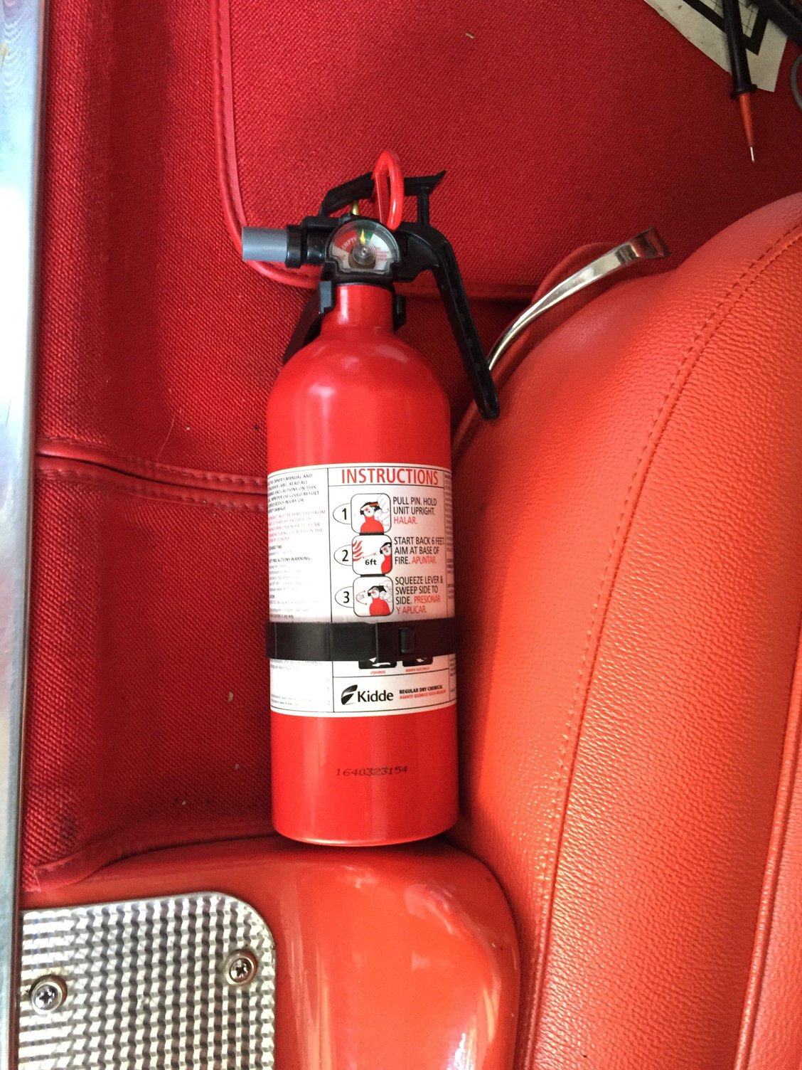

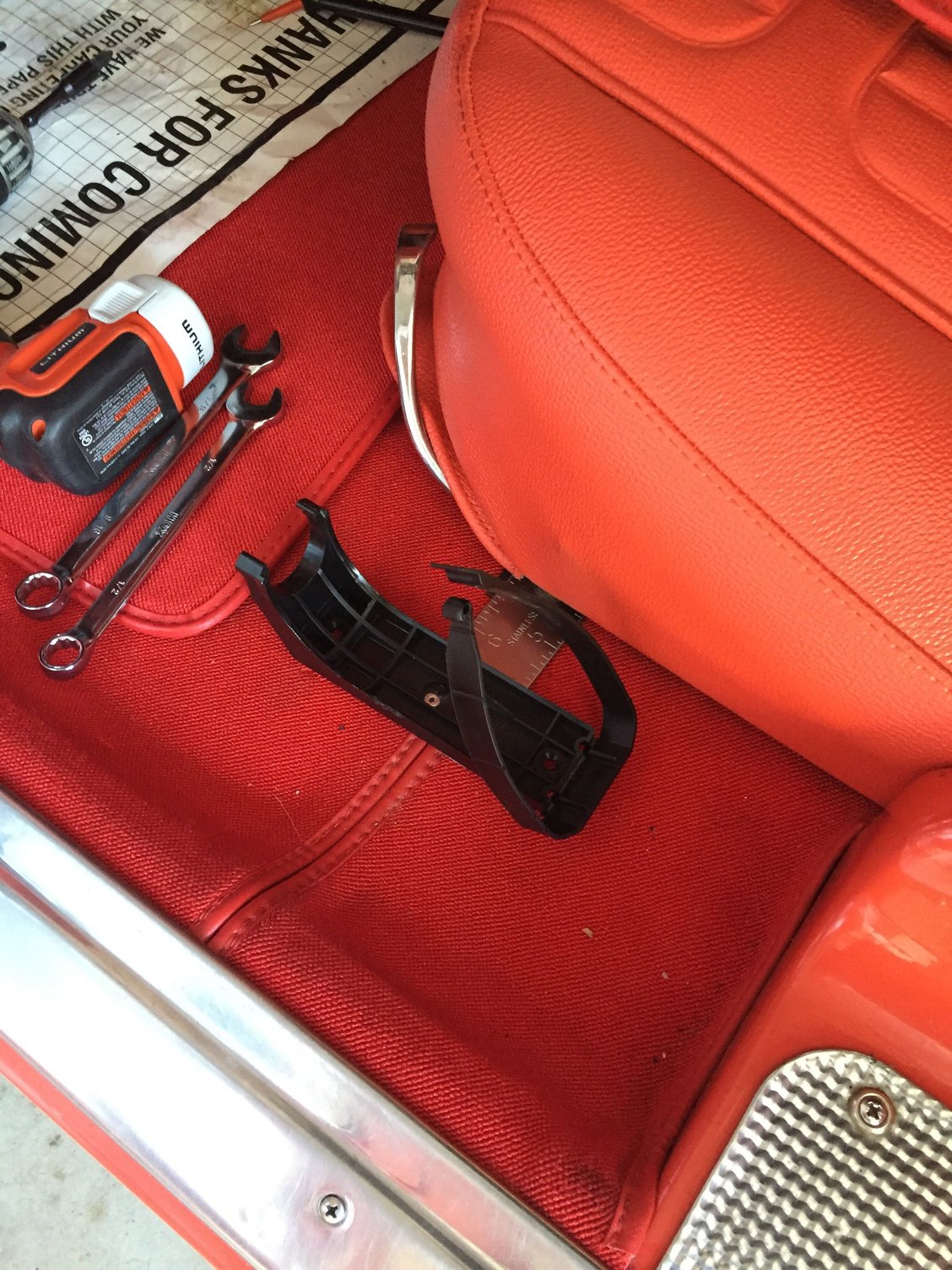

I bought a Kidde fire entinguisher from Homedepot which came with its plastic bracket. I cut a steel ruler to bridge the bracket to the seat bolt next to driver seat, can be done for passenger seat too. In case you would need a $15 solution.

I bought Velcro with a sticky back. the sticky part goes on the extinguisher and the velcro stays on the carpet. also that is a poor choice for a extinguisher for a classic car

Pretty nifty mount! However, I would agree with Nowhere Man, dry chemical extinguishers make a huge mess! I used one on a carburetor fire over a year ago and I'm still cleaning off the white residue from all the nooks and crannies. Since then, I bought a bracket from VetteWorks and a Halon extinguisher that sits at the base of the passenger seat.

Except you can't move the seats after you install this mount.

in a C1 there is no reason to move the passenger seat as there is nothing to access behind it...
