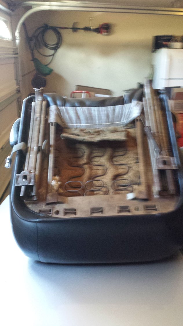

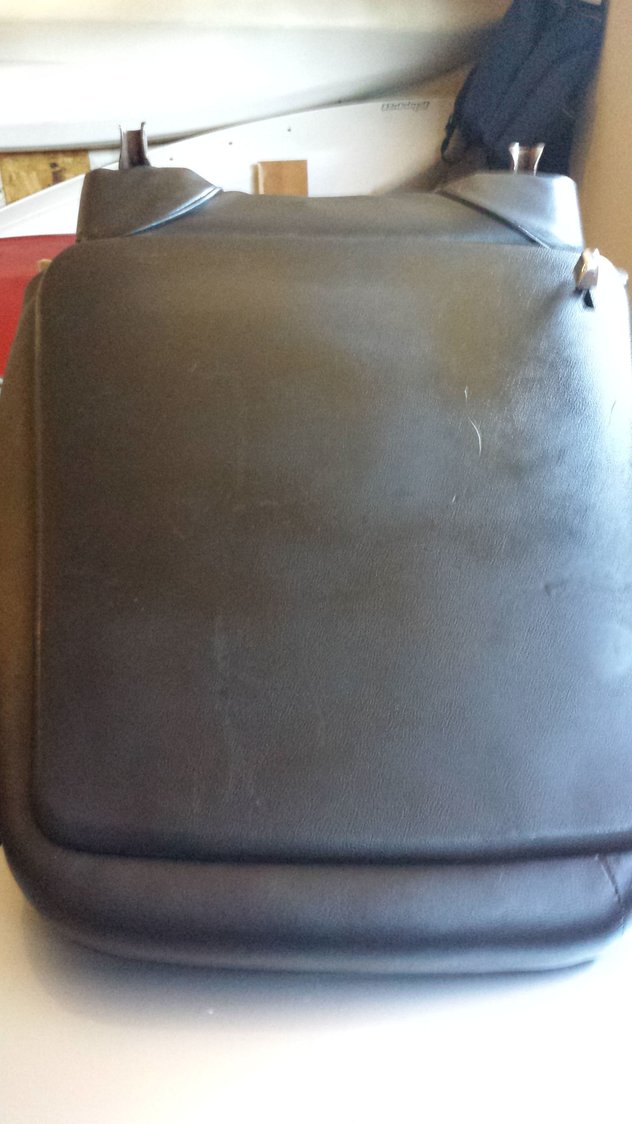

Recently purchased a 63 Corvette Convertible. Discovered seats were not capable of being bolted to floor. Trying to determine if they are correct seats if not what year the seats are from?

I see this is your first post...welcome to a very helpful forum. Those seats are not from a Corvette. The forward/back adjusters on a Corvette seat are on the front of the seat and the seat back release is on the side not on the rear. Did you drive this '63 before buying it?

Not Corvette seat from any year. And I don't think they are even GM seats. Look like early 60's Mustang seats.

Standard '67 Camaro seats are similar.

Yep, first gen Camaro standard interior. These are probably worth $300 with new covers installed.

The seat bolt pattern is unique for a 63. No other mid-year seats will fit without changing the floorboard hole configuration. I'm not familiar with aftermarket seats but i would think it's unlikely that you will find something that bolts right in.
Why not buy a pair of 63 seats? They will fit without any modification and they look the best.
This is probably the first of many parts that you will find incorrect for your car. It's something we've all gone through. You can slowly purchase the correct parts over the next future months and years. In the meantime, welcome to the hobby and enjoy your "new" corvette.
