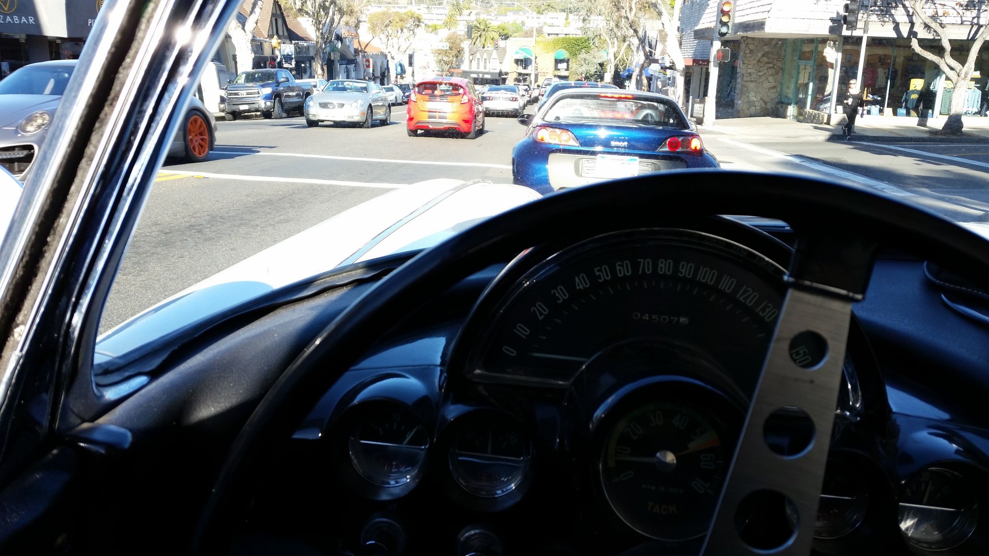

All good information, but after doing and confirming all that it didn't help my 1962 at all.
This did, though. I installed a SPAL 16" electric fan hidden behind the fan clutch and fan. Mine ran up to 235-240 even with a brand new Dewitts restoration radiator which is rated highest for BTU dispersion. Now it never gets over 185 even when stuck in parade like traffic.
Before:
After:
Installation in process. I made straps to support the fan:
Installation done. Shroud back on with fan and fan clutch back on. No one sees it unless you point it out:
Stuck in gridlock New Years Day on Pacific Coast Hwy in Laguna Beach. Took 30 minutes to go 2 blocks. Sure took the worry out of having fun in the car:
Didn't get hotter than 180*. Notice the speed on the speedo. Parked watching the signal light go green/yellow/red/green/yellow/red.
I added a Powermaster 90 amp alternator that looks and mounts like an original generator. I have a digital voltmeter that plugs into the cigarette lighter. At idle, headlights on, fan running it holds at 13.6 volts +.
383 CID Blueprint crate motor, 700R4 4 speed overdrive automatic transmission, 2,200 RPM stall speed lock up converter. Life is good. I could daily drive this thing.
65 miles per hour (GPS speed confirmed), 1,990 RPM, 185* and holding. It actually runs cooler in traffic.
Before:
After:
