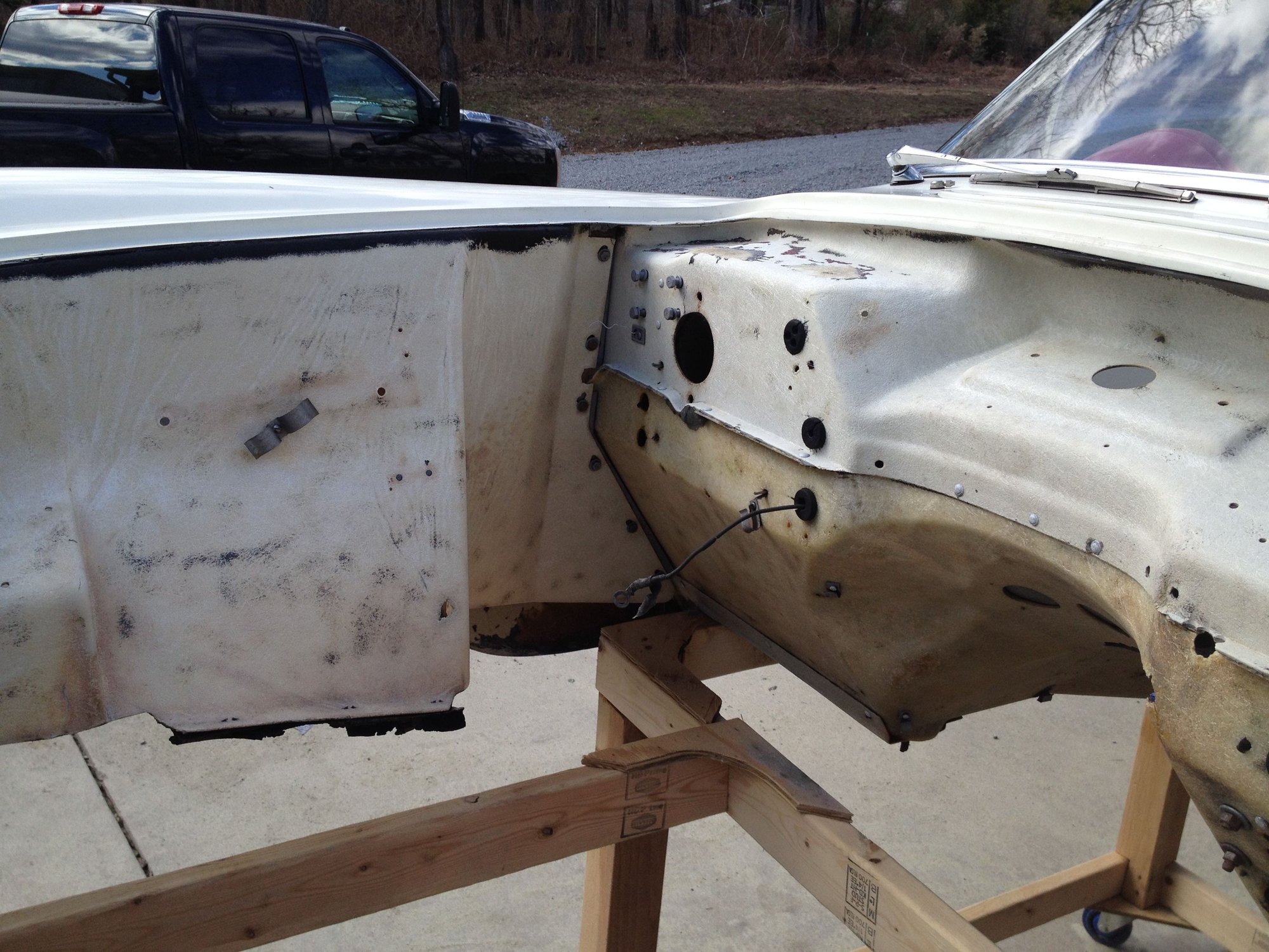

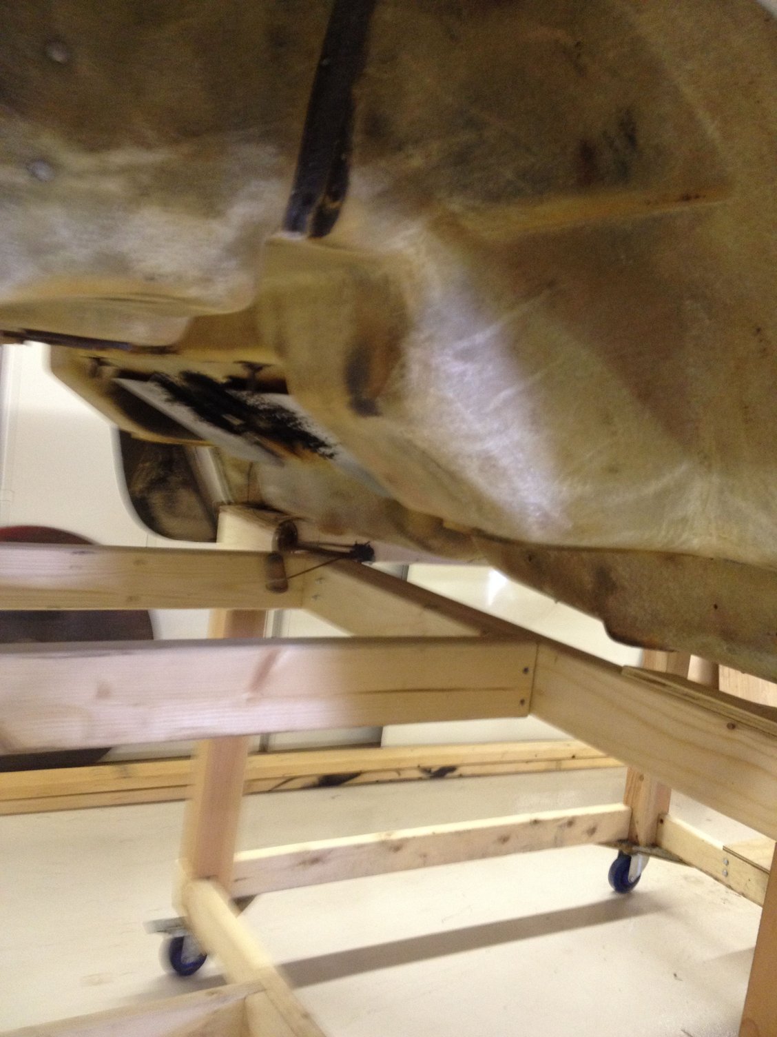

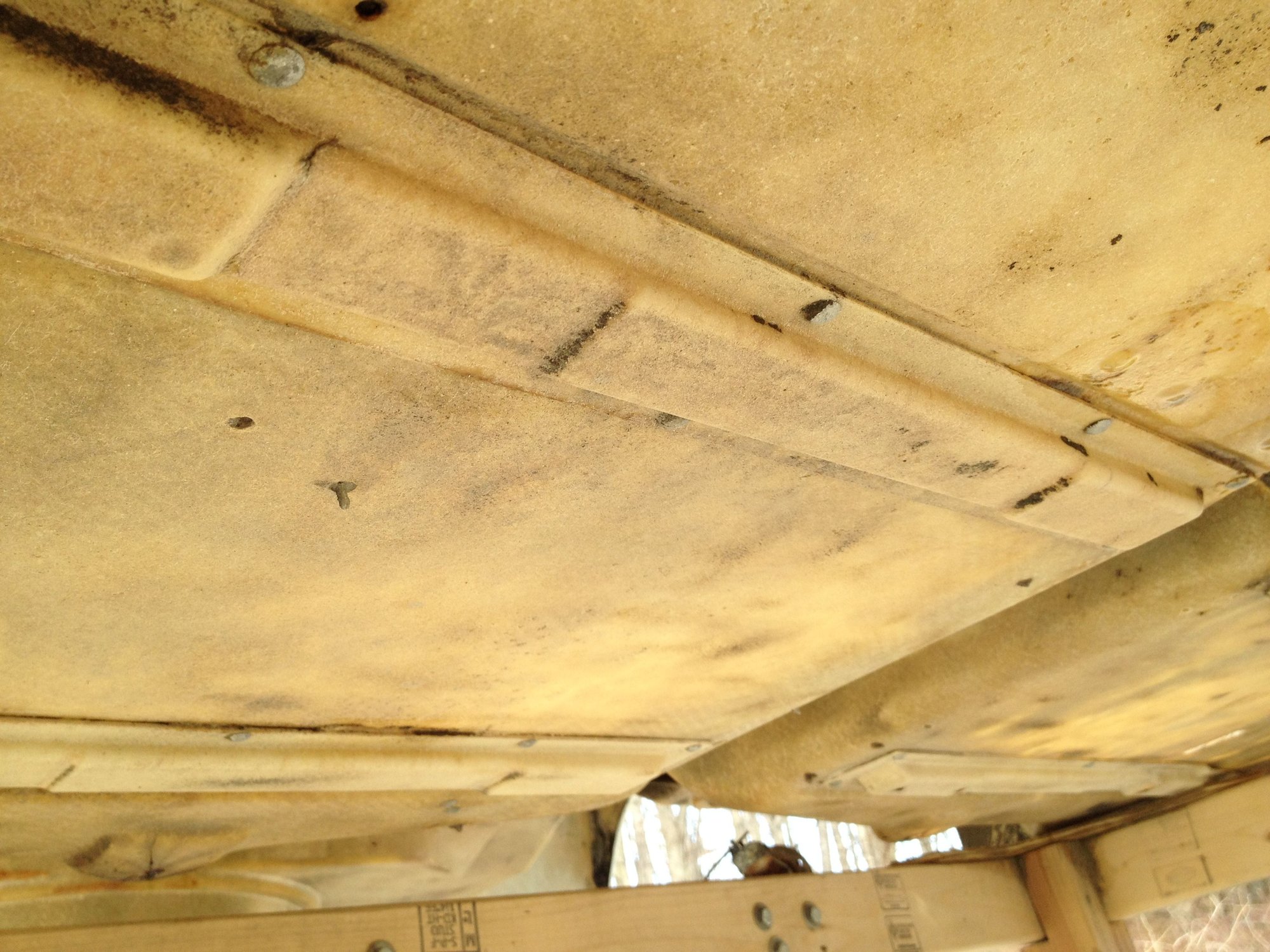

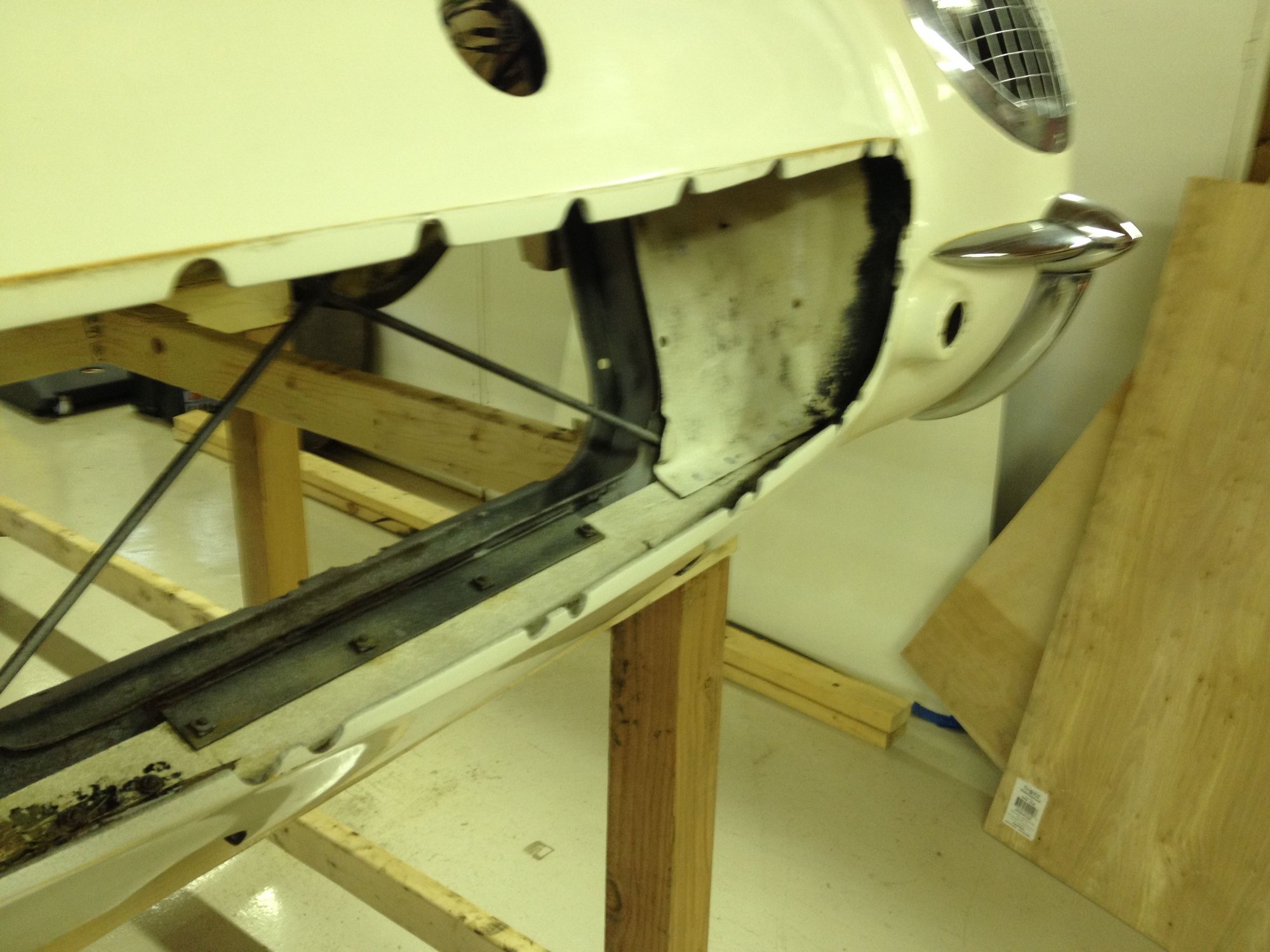

Engine bay and under. No surprises....

Did it right in my driveway....

Looks like that does a nice job! Was there a real mess to clean up afterwards?
Rich
Not really, swept up about a coffee can full, hosed off the rest.
