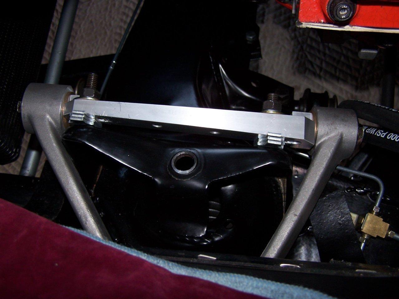

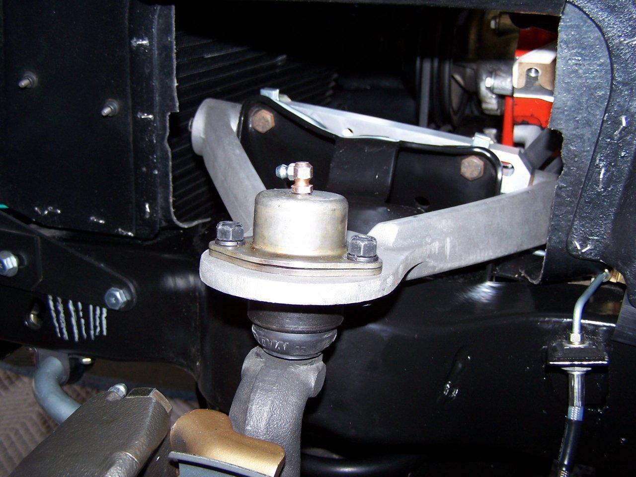

If you need more castor but want to keep the original upper control arms [and a crap ton of $$ in your pocket] They make offset upper control arm shafts that allow you more adjustment. I have them in one of my GTO's...huge difference.
Who makes them?

Originally Posted by davekp78
Who makes them?
K6104 Moog I think....
