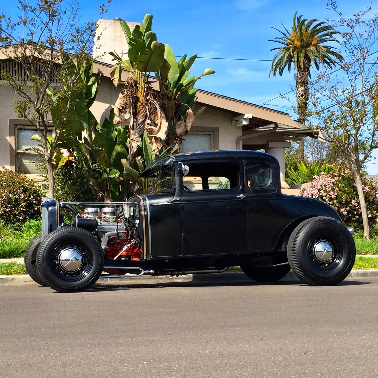

You have a Vette engine in a Model A? You have got to post pictures of it!

Old Mar 30, 2016 | 10:57 PM
seeholmes's Avatar
seeholmes
7th Gear
Posts: 7
There she is! Got the charging issue worked out too. Ended up veing a sketchy ground at the regulator (the generator vround wire connection to the reg. housing) got that cleaned up and tightened and good to go.
Old Mar 31, 2016 | 05:35 AM
Frankie the Fink's Avatar
Frankie the Fink
Joined: Aug 2007
Posts: 58,061
Likes: 7,141
Army
Love the car. Its screaming for headers and sidepipe though
Old Mar 31, 2016 | 08:04 PM
ILBMF's Avatar
ILBMF
Joined: Dec 2015
Posts: 1,369
Likes: 140
Nice lookin' ride there!
