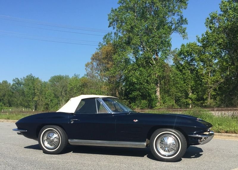

I have Cooper Trendsetter 205/75's. They are a very decent street tire, attractive and happen to be inexpensive.
Me too, and I like them as well - especially considering the cost and the fact they were made in USA.
My friend owns a tire shop, and he ordered three brands with narrow whitewall for me to look at before I bought them: Uniroyal Tiger Paw, Hankook and the Cooper Trendsetter.
I wanted to look at each to see where they were made and what the sidewall/tread pattern looked like. My friend recommended the Uniroyal over the other two - primarily based on the fact that he sells a lot of Uniroyal's. I ended up choosing the Cooper Trendsetter because of the clean side wall and attractive tread pattern. It was also the only one made in USA. The Uniroyal was made in Mexico, while the Hankook was made in Indonesia.
Price was not my primary concern, but the Cooper and the Uniroyal were similar in price.
Todd

Your car always knocks my socks off Todd!

Thanks Benton. Looking forward to seeing yours finished and back on the street again. Been watching your rebuild thread since you began. It's looking fantastic!

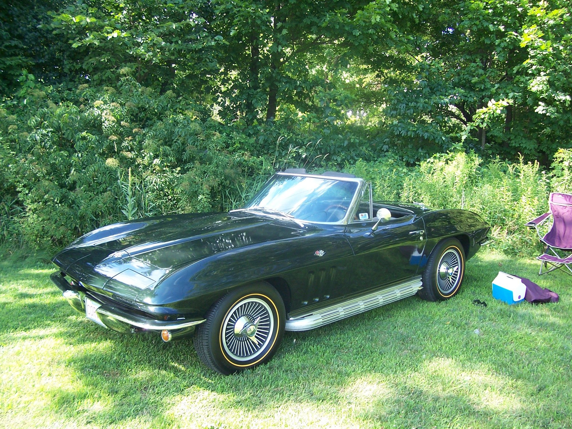

Welcome to the forum.
I've run 215/70/15's and never had ANY issues. In fact, I have 2 different brands on 2 different types of wheels.
One set are Michelin Diamondbacks on bolt on KO's and the others are Toyo's on TT II's.
Btw, the Michelin Diamondbacks are slightly narrower than the Toyo's so there should be no clearance issues at all.
Gary
