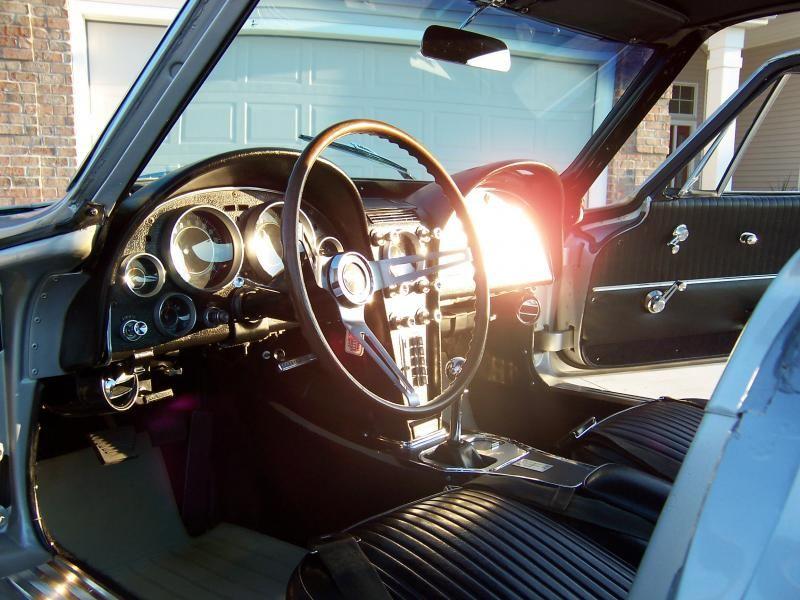

Recently, in viewing photos of C2s for sale, I came across 2 cars with an interior feature I'd not seen in pouring over thousands of interior photos. I've included a photo with the "item" highlighted for identification from one of the cars. I assume it's a feature related to the heating vents, likely for directing/redirecting the heat. Anyway...thanks for the clarification!
Hopefully you can identify the feature in the oval for me. Thanks.

Look at these...
www.corvettecentral.com
Part #232186/85
A/C ....for 1967

Factory air vent for 67

The picture shows a '67 W/O A/C. The small pull handle on each side opens and closes the basic kick panel fresh air vents. A/C cars have the same thing. There is no ability to change the air direction of these. As you may know, A/C cars have three outlets. One in the center above the clock and one on each far side of the dash. The end outlets can be swiveled. Dennis

As showed here in my '64 with factory A/C...

67 only non ac freash air vent pull. 63-66 had the pull **** on the drivers side
