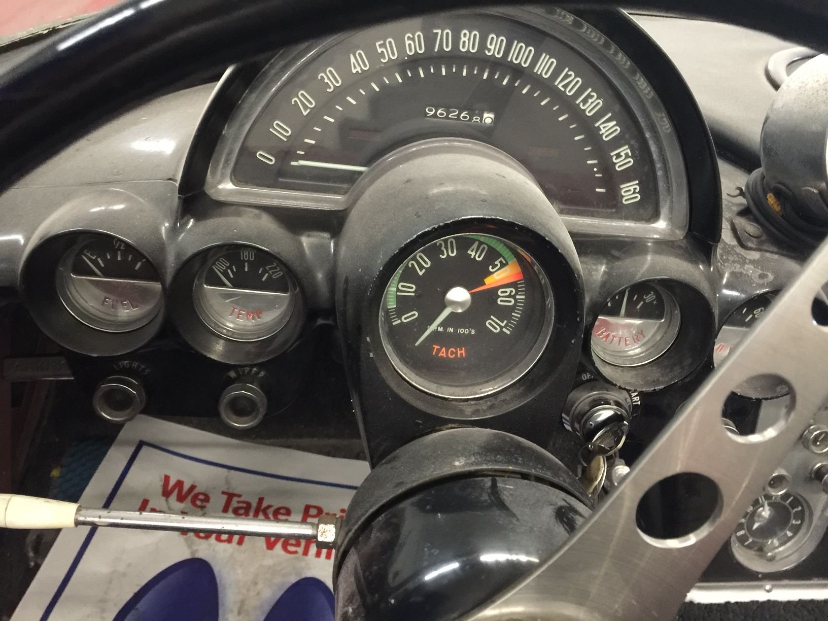

Well, we know the rear end is correct, dated right and AP code 4.11 Posi. Here's a pic of the gauges with tach. What engines could this tach possibly be connected to with a 4-spd and the 4.11 posi rear?

Engines with hydraulic cams came with the low red-line tach. That would be the 230HP, 245HP and 250HP.
I'm curious, how do you know for sure that it is an original FI car?

Transmission and differential have nothing to do with tach redline. As 1snake indicated, that redline is associated with hydraulic lifter engines, of which there were three possibilities in 1960.
What evidence is there that this car was originally fuel injected?

It is possible that the car is not a Fuelie Car, still investigating. Is there a tell-tale way to prove if it is a Fuelie car, or is not a Fuelie Car?
